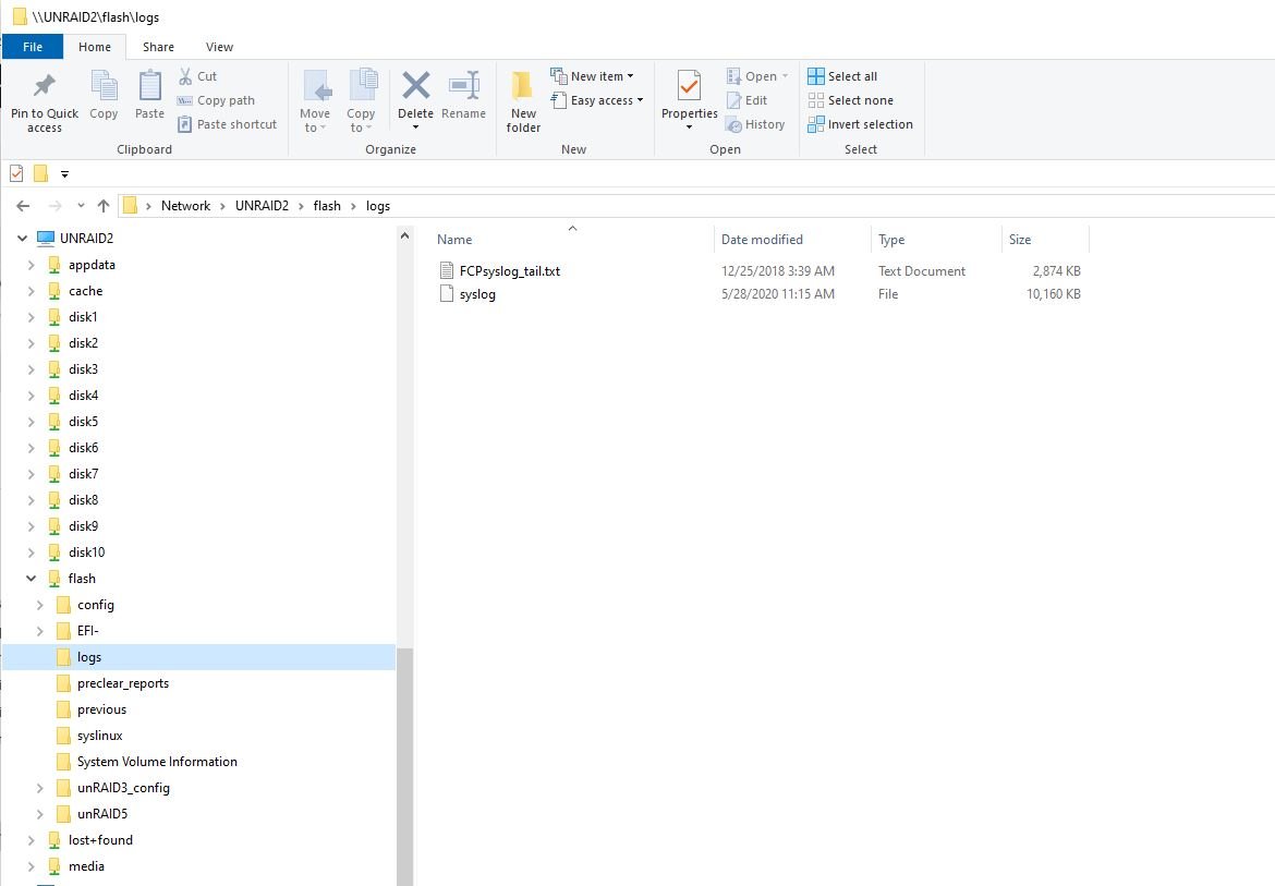

So today I had just completed a replace / rebuild of a data drive and clicked on the 'done' button. I then clicked on 'spin up all drives' and boom it triggered an unclean shutdown.
syslog attached plus a screen capture of the flash drive showing no diagnostics log file.
Sounds like a power issue. I am guessing you have 10 data disks based on that screenshot. I highly recommend NOT sharing cache or the array disks on the network. Among other reasons, you can lose data if you mix disks and user shares when copying/moving.
