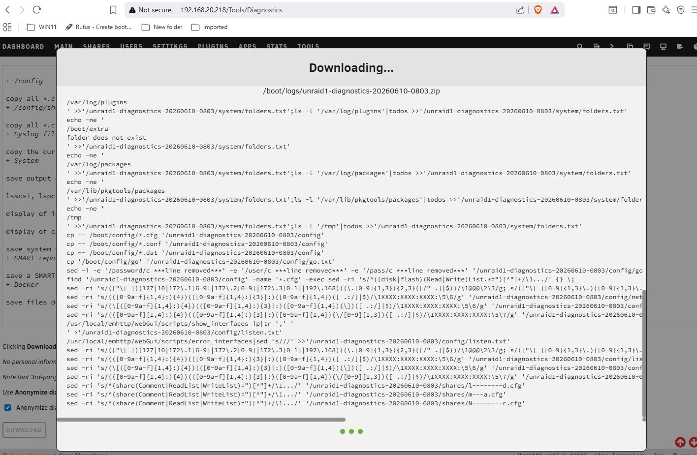

  2. OK, as indicated above I have tried to get diagnostics but I don't know how much will be in the file. I will check the USB drive and also retry after I get the server running again. I have already tried a CLI REBOOT and a console SHUTDOWN, neither of which worked. I will force a power down and see where that leaves me. I was about halfway through converting this servers' 15 drives to xfs. Disk9 had just been cleared to an xfs disk in preparation for its own conversion to xfs. However, using the MOVE function of the Web Interface stopped actually moving files after just a few GB. It did keep on copying so all files remaining on it are duplicates. I had tried to use the Web Interface to DELETE them but that failed as did trying to do it from an SMB share. So I agree, it's file system is hosed and I was just going to let the reformat take care of it. Hopefully back shortly with diagnostics.
  3. My attempt to get diagnostics hung.

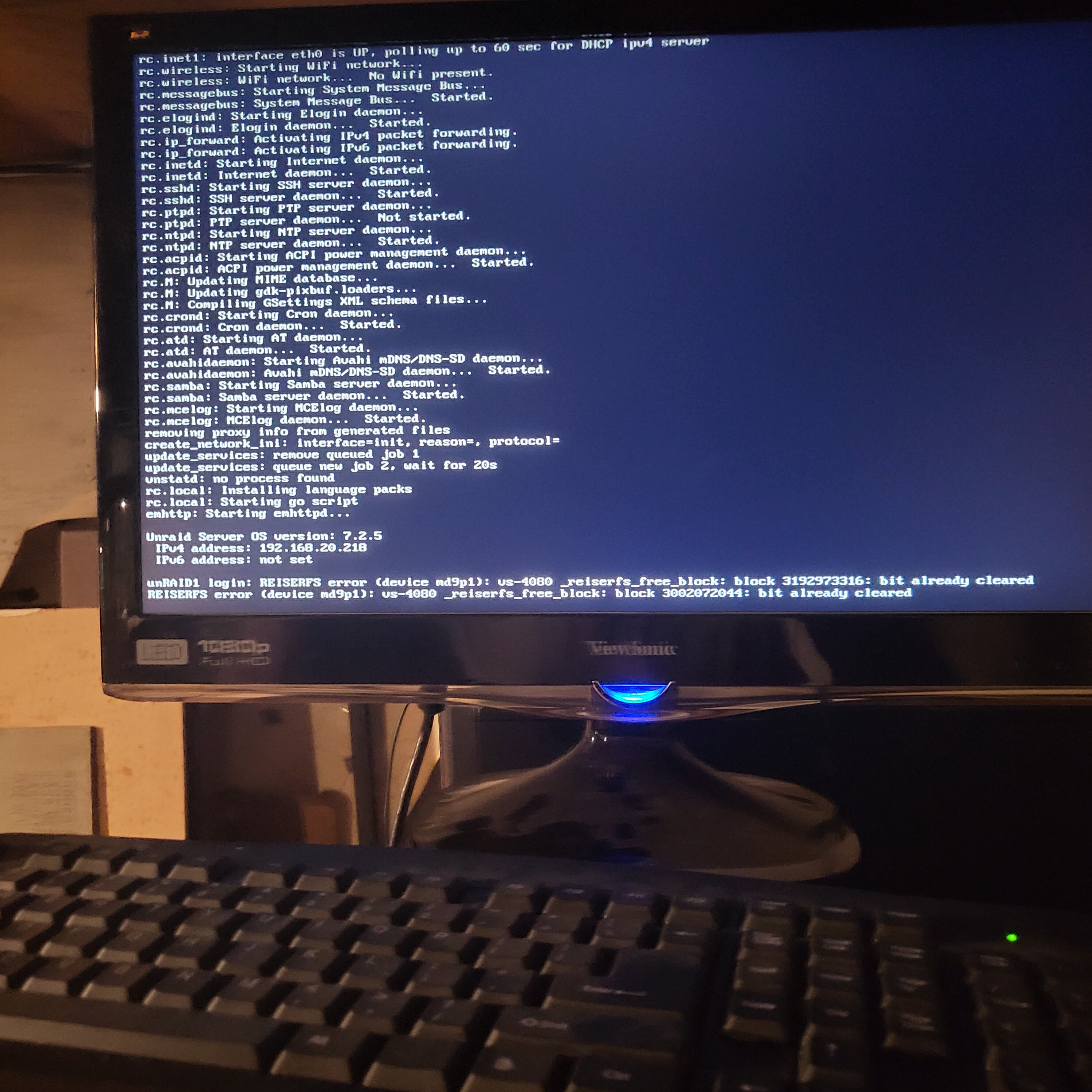

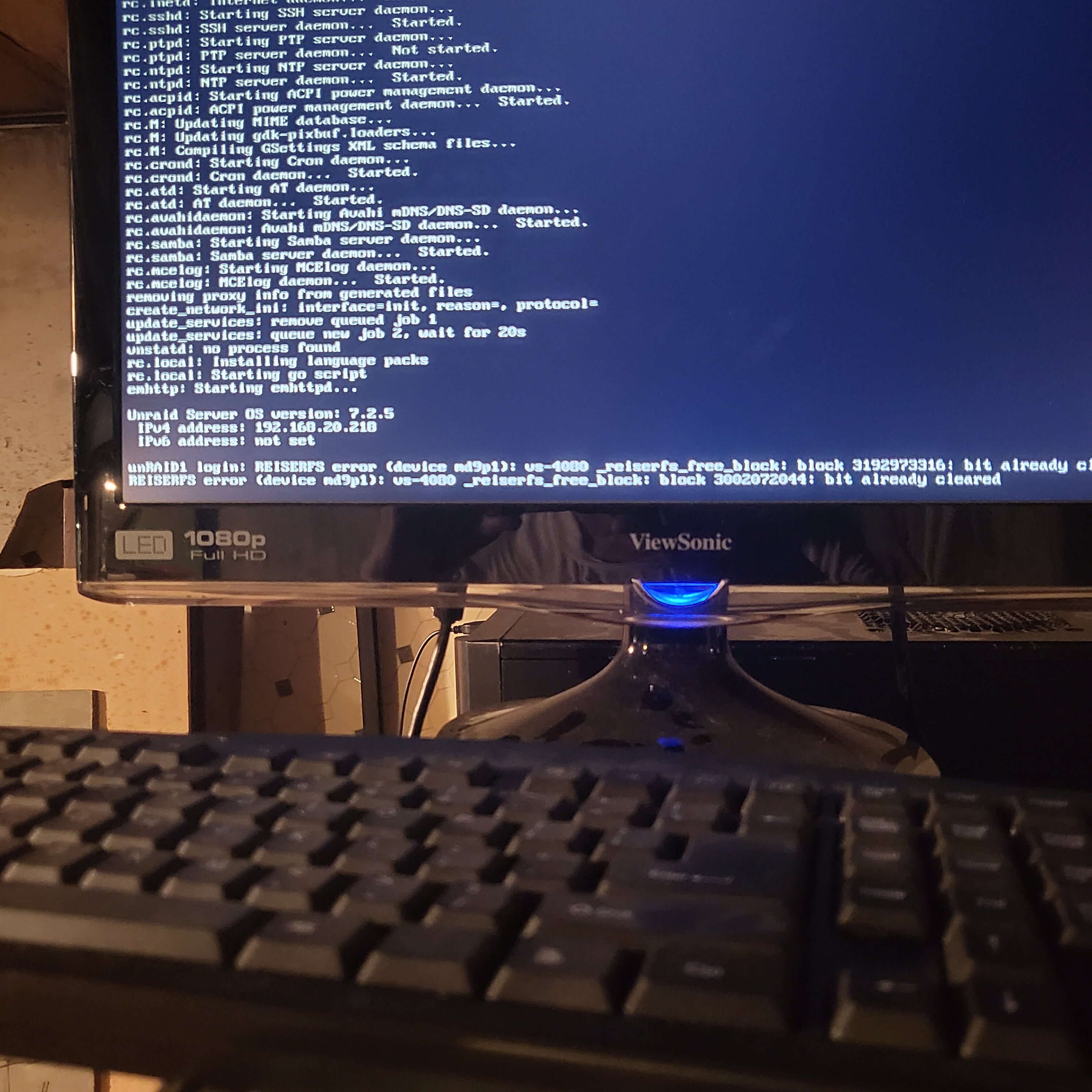

  4. I hooked up a monitor to my server and this what it shows.
  5. I have a 7.2.5 UNRAID system that had just started a drive rebuild. I noticed that the Parity drive was generating a ton of read errors so I was going to Stop, Reboot the array and restart the rebuild. After issuing the Stop it has been in the "Array Stopping - Sync filesystems" status for a couple of hours. No disk activity is indicated but it shows very high CPU usage on all four cores. Any recommendations on what to do next ? Reboot, Shutdown, power off ? I suspect I am screwed no matter what but any advice on how to recover from this would be greatly appreciated.
