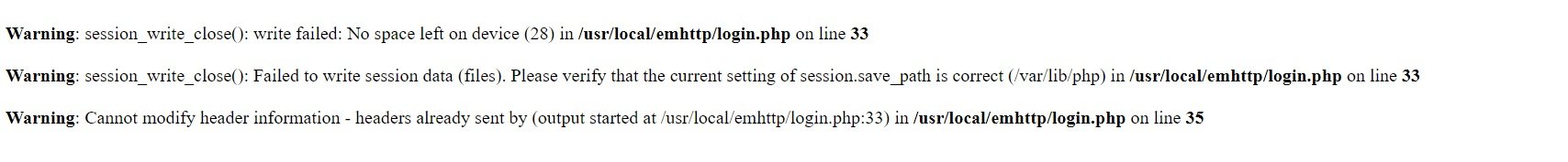

Then i get the following screen trying to login.   All my disks are not showing up, it looks like my config is totally gone.
Hoping someone can help me recover.
My guess is a coding error overwrote the OS folders. Hopefully it didn't get to /boot or /mnt yet.
Reboot and make sure you don't run that script again.

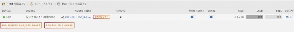

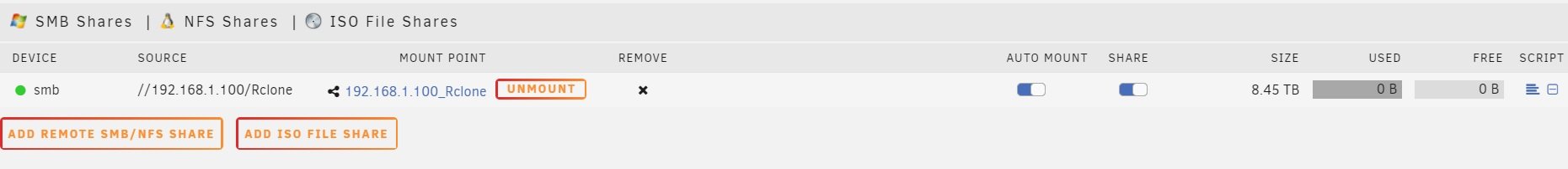

and attached is a picture of my SMB mount of a freenas share at my folks house.  it's weird that it says free 0

any ideas what i am doing wrong?
