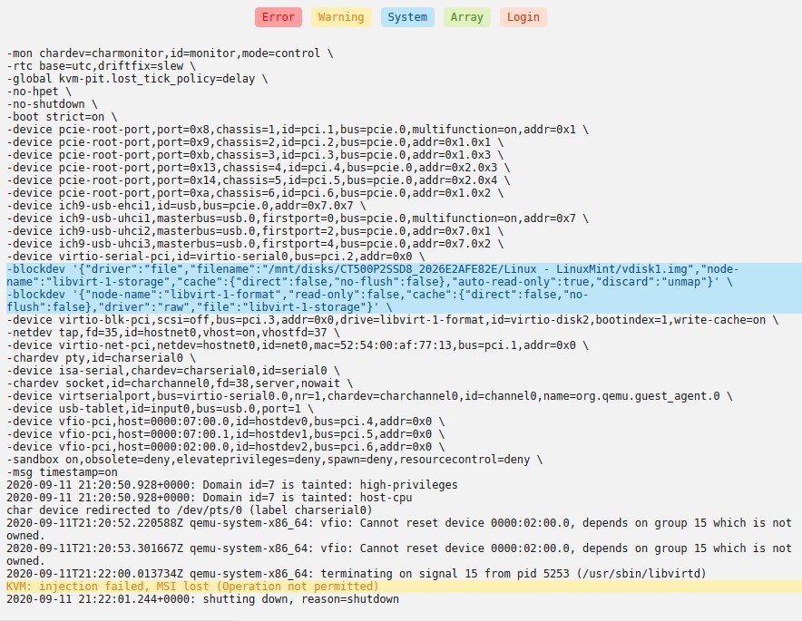

Also attached a log when the Linux VM didn't properly pass through the GPU
