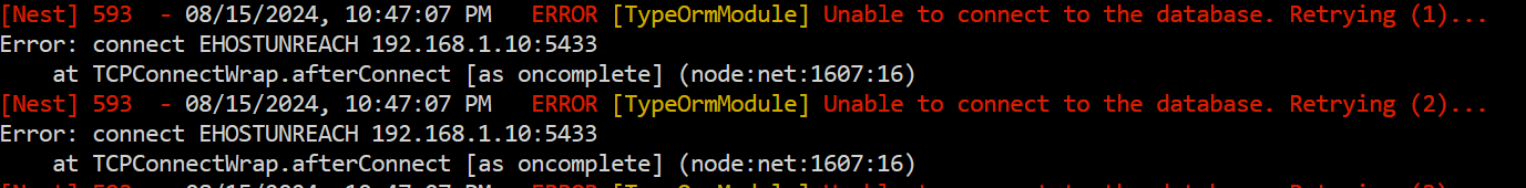

  1. Did you happen to to figure this out? I'm trying to something similar but without the NPM. I'm using cloudflare tunnel to access immich from the Wan side and I'd like to be able to use the same URL on the LAN side with split DNS through pi hole. I need immich to have its own IP address on the LAN network to do that so the bridge network is out.
  2. Has anyone gotten the spaceinvader method to work with a MACVLAN network? I have been able to get Immich up and running on a bridge network. However, I only have access through the app via a local IP address. I do have a cloudflare tunnel that is working and can access immich from the outside through a web browser just fine. I would like to be able to solve this issue by using split DNS through pi hole. When I try to put Immich on the br0 network, it can't seem to access the PostGresSQL_Immich docker. This same error occurs if I try to move the database to the br0 network as well and assign it static IP address. I also have other dockers on the br0 network that are working fine as well. As soon as I change immich back to the bridge network everything works just fine..
