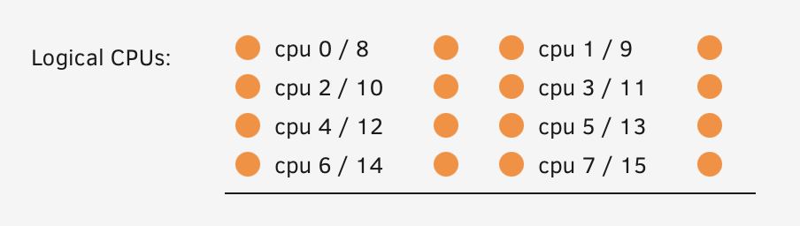

  3. Thanks for this - it’s really useful. The VM in question is a Windows Server 2022 machine running Plex/Jellyfin. It’s got 32GB of RAM (system has 64GB total) and an RTX 3060 passed through to it. I wanted to give it as much resource as possible because we were having problems with Plex transcoding stuttering, so I was hoping a lot of resources would help. I have seen Plex use 100% of the CPU when scanning library files, but I don’t mind that taking longer with the fewer cores given that it only does that from time to time. I’m hopeful that reducing the cores to the VM will solve the stability issues without impacting Plex! 🤞
  4. It's really frustrating because the issue occurs randomly - it can sometimes take weeks for it to happen again, so I don't think I'd be able to put it in safe mode, as I'd have to wait weeks without VMs or dockers. The only other thing I can think to try is removing a couple of CPUs from one of the VMs that seemed to have all of them assigned to it. I'm just wondering if at some point the CPU gets pegged at 100% causing things to crash maybe... I've now removed 0/8 and 2/10.

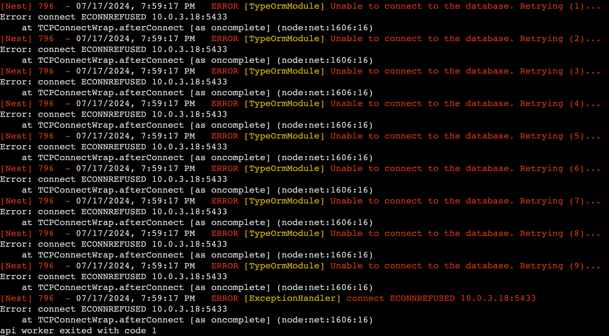

  6. I've got Immich, PostgreSQL_Immich (spaceinvaderone's image) and NGNIX Proxy Manager all installed via Apps on my UNRAID server. My router is configured to port forward 80 and 443 to my NPM docker image (10.0.3.254). For the life of me, I can't work out the correct way to get these to all talk to each other in terms of network config. On some occasions, I can get Immich to be able to connect to the DB, but then NPM refuses to see it, and othertimes the other way around. I've tried having them all on custom br0 with their own IPs, but Immich (10.0.3.17) refuses to connect to the DB (10.0.3.18): I've put Immich and the DB on the 'Bridge' network type and changed the config so that it uses the 172.17.0.x address for the DB (Immich IP then becomes 10.0.3.1:8080) which work, but then NPM behind Cloudflare gives me the 502 error. Can someone please help me with this and guide me on what the best way to set all of these up is please? Thank you.

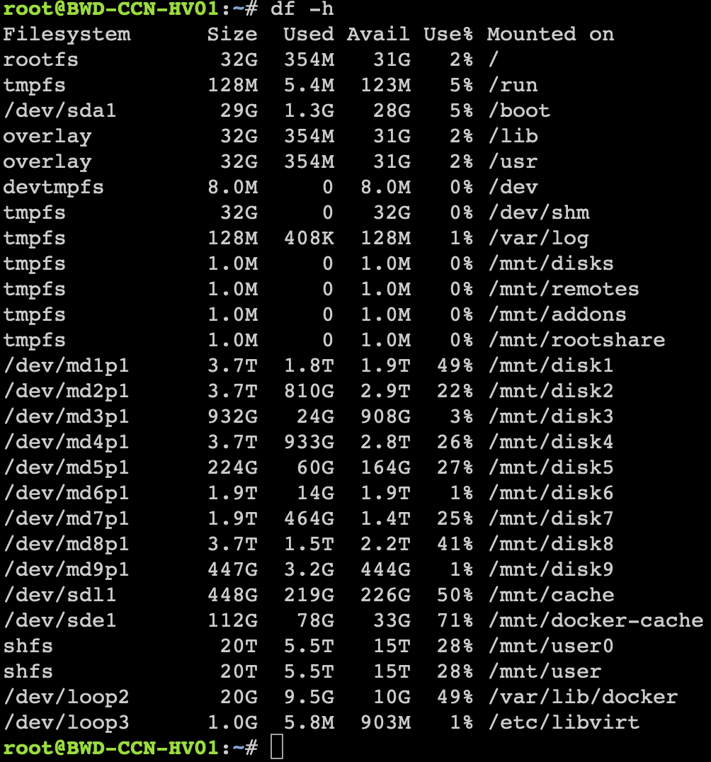

  8. Hi, On a couple of occasions now, today being one of them, I've had an alert from my monitoring software to say that my VM has gone offline - I've confirmed this as I'm unable to access or ping the VM. However, upon checking the UNRAID machine itself, I'm unable to access the UNRAID GUI (via any address/IP), nor can I SSH into it. It does, however, still respond to ping. This has happened twice now from memory in the past month or so, and I'm at a loss. I saw another post about checking if rootfs was full, but that's not the case on this server: The only disk capacity issues I've noticed is that I had around 150 emails yesterday from the UNRAID server saying that the docker-cache drive (sde) was 71% full. I didn't have time to explore that yesterday or today, but I doubt that this is related. I've attached my diagnostics in the hope that someone more skilled than I can notice anything wrong? The VM flagged as being offline around 12:55. Thank you in advance. Kind Regards, Callum bwd-ccn-hv01-diagnostics-20240717-1834.zip
