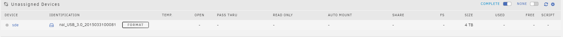

This is what I see:
Why don't I see a plus sign next to the disk or am I reading old tutorials and the new version has no plus sign?
Thanks,
Nate
If it's mountable in UD you should see a Mount button and it should show the filesystem under FS. UD does support ext4 but apparently nothing but your pi recognizes that disk as ext4.
