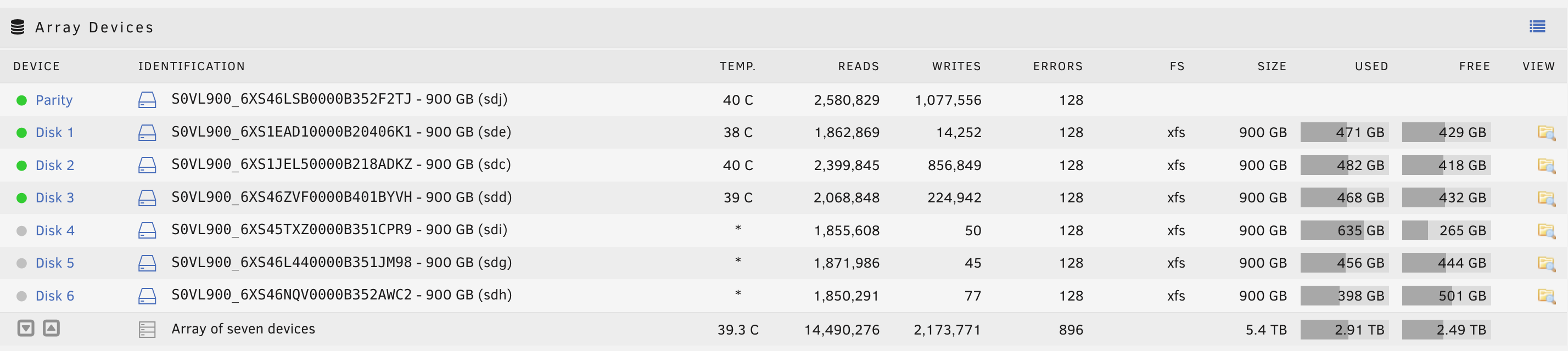

Hello,
I have a DL380 Gen8 with 8 disks. 7 are 900GB SAS disks. Every parity check it comes with 128 errors on every disk. I have done a rebuild on the parity and erased the disks one by one. I have replaced the on board controller with a HP H220 6Gbs PCI-E 3.0 HBA. All with the same result.
I did read that it might help to install drivers if you get read/write errors like this, but I do not know what is the best option.
I know the network errors in the logs.
I moved to the beta to see if this improved anything.

I did a reboot and ran a parity check. Here is the diagnostics.
From Sep 23 19:44:51. you see the errors on the drives.
tower-diagnostics-20200924-1103.zip
All of them are read errors at the Sep 23 19:44:51 timestamp.
These appear before the errors.
Sep 23 19:44:51 Tower kernel: sd 2:0:0:0: [sdc] tag#6221 UNKNOWN(0x2003) Result: hostbyte=0x00 driverbyte=0x08 cmd_age=0s Sep 23 19:44:51 Tower kernel: sd 2:0:0:0: [sdc] tag#6221 Sense Key : 0x5 [current] Sep 23 19:44:51 Tower kernel: sd 2:0:0:0: [sdc] tag#6221 ASC=0x24 ASCQ=0x0 Sep 23 19:44:51 Tower kernel: sd 2:0:0:0: [sdc] tag#6221 CDB: opcode=0x28 28 00 63 a3 8e c8 00 04 00 00
Looks more like a power/connection issue, also a good idea to update the LSI's firmware, since it's very old.
