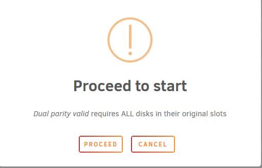

But in my situation I'm ruining dual parity and when trying to start the array with my correct parity drives and "parity is already valid" checked i get this warning
Does this mean all data disks MUST be assigned in the original slots before the array went down? or just that all data and all parity disks be assigned accordingly? would be just safer to rebuild parity?

For parity2 to be valid all data disks must be on the original slots, parity1 remains valid if all data disks are present, regardless of order, also note that parity1 and 2 are not interchangeable.
OK then. no other choice but to start the rebuild of parity I suppose. Though Ive noticed the speed of the rebuild fluctuates between 500KB - 1.5MB is this normal? i  thought it would be faster, since at the beginning it said estimated finish to be ~16 hours (didn't pay attention to speed at the time)

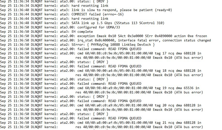

according to syslog.last200 seems ata 2 & ata3 are the problem.

Shutdown, check connections on disk1 and disk3

also this error had come up before once with two separate HDDs i replaced about month ago, which i had already replaced the cables to. will have to check the box and match serials to confirm. I have a feeling it might be the actual SATA ports on my MB or on the enclosure.
ok replaced sata cables and restarted rebuild. seems to be holding at ~160 MB
also how were you able to find which disks where the ones assigned to those ata slots? i think last time i had this error i spent a couple of hours trying to find where the ata matched with anything remote to a disk number/serial
syslog
Sep 24 20:44:21 DLNQNT kernel: ata2.00: ATA-9: WDC WD100EMAZ-00WJTA0, JEGKNTAN, 83.H0A83, max UDMA/133
Sep 24 20:44:21 DLNQNT kernel: ata3.00: ATA-9: WDC WD100EMAZ-00WJTA0, 1EG8SH2Z, 83.H0A83, max UDMA/133
There were some reassignments and you can see all this in syslog, but that is the slots those serials ended up being assigned according to smart folder in diagnostics.
