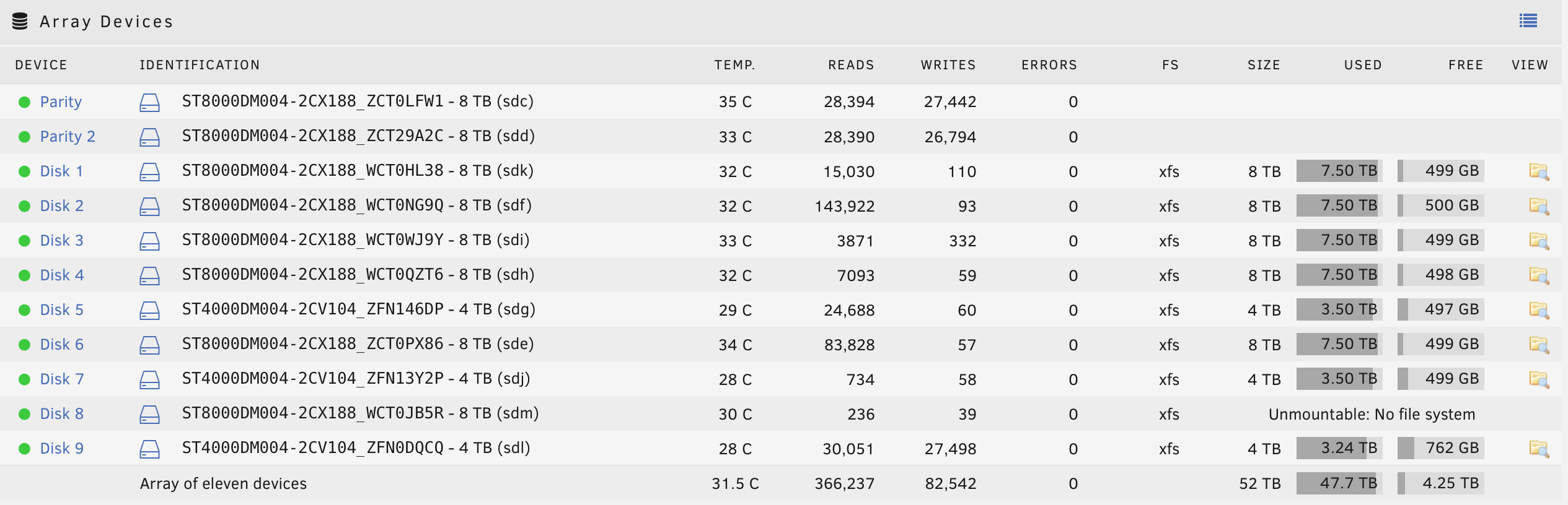

After a reboot, Disk 8 of my array says "unmountable: no file system". To my knowledge there haven't been any errors on the drive and I believe it is my newest drive, only a few months old.
Does anyone have any ideas?
1253091561_Screenshot2020-09-28at16_37_25.thumb.png.c2521f344795f7c6e01fc607f60860e6.png
