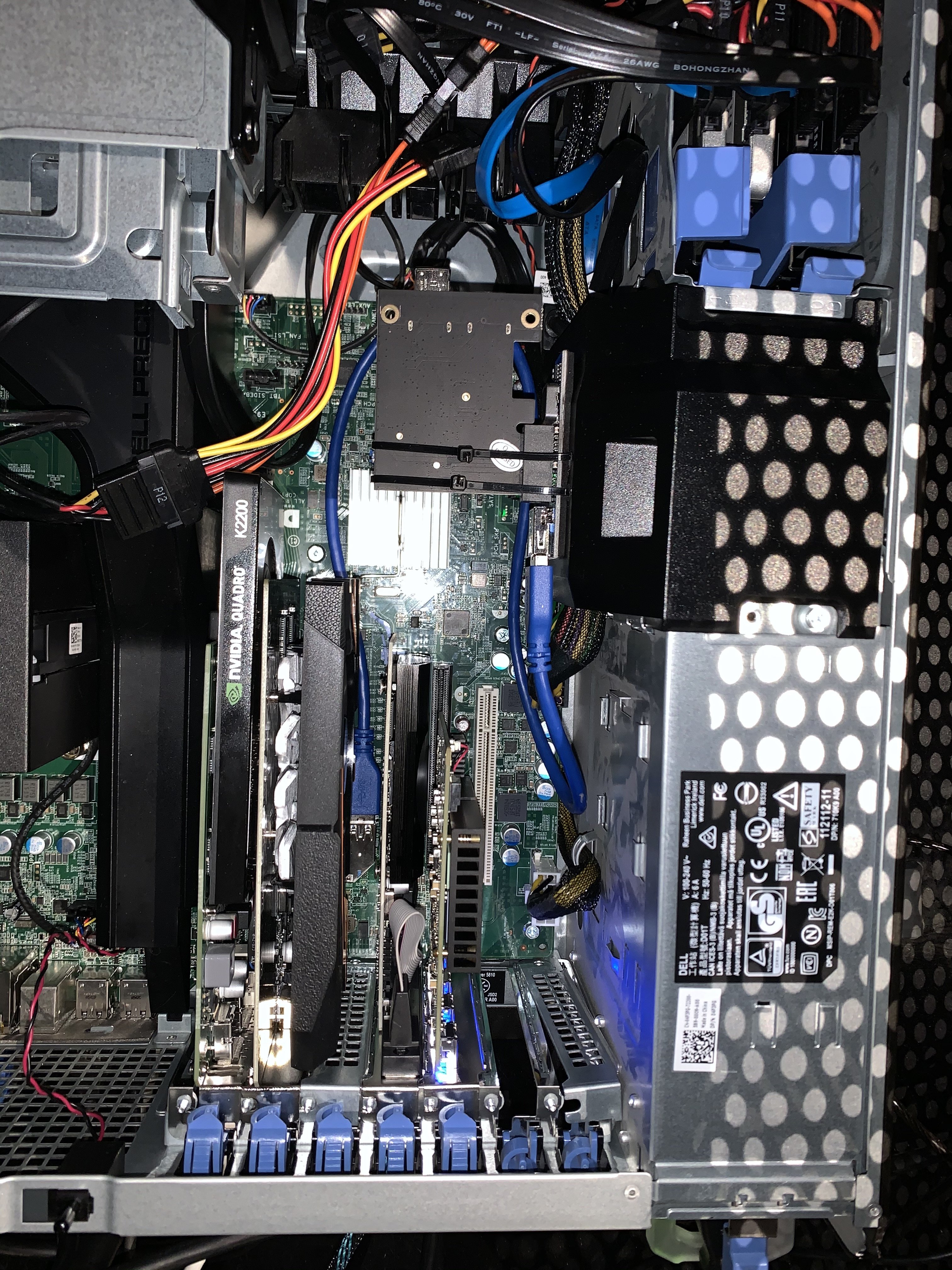

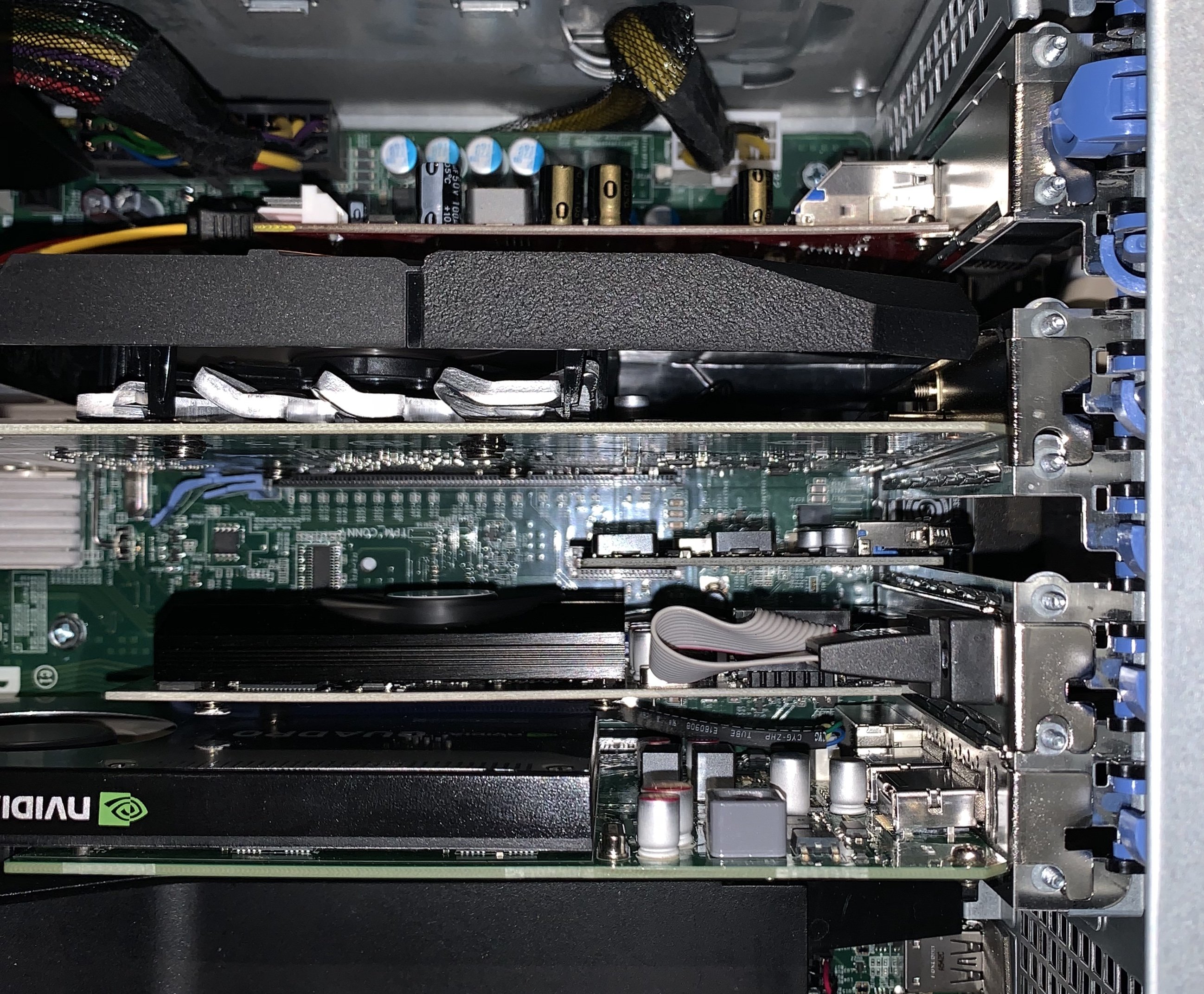

so i have a dell server that is maxied out with 3 video cards.  I have added a pci USB card that allows me to pass through to one vm
The native vm of the dell server worked fine, but hot swapping usb wasn't going to work.
given that there was one last port on e the board pci x2, I decided to get a cable and break out for the port.  that let me add another usb controller.

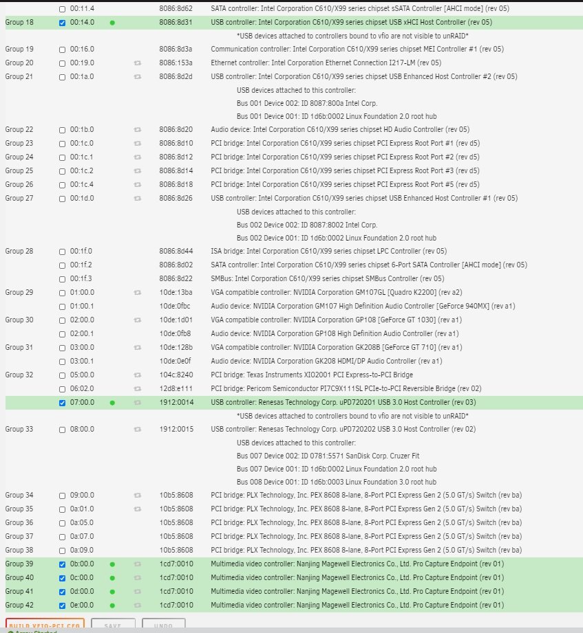

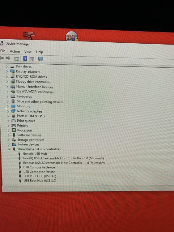

I am VFIO-PCI Config plugin to pass the whole controller through, for hot swap.  Using a Dell Xeon server.  There is one onboard controller for native usb.
I added a pci usb board in slot 6.  That board was working fine until i added another pcie usb board to slot 4.  I am using that to put the unraid flash drive.
I added the native usb and the slot 6 card via VFIO-pci and everything appeared to work fine, but after restart that card seems to disappear.
Both of those cards seem to run on the same chip.

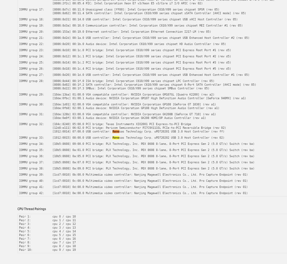

Check your tools->system devices to see what the ids are on both your cards. They should also appear in separate iommu groups. If the ids are the same on both cards, then when you add them to the vfio-pci it will remove unraids ability to access the cards (but you could pass each of the cards to separate vms if you choose.
If you map out what ports/controller/busses are on your onboard, then you can maybe shuffle things around to have unraid using the onboard and have the cards used by your vms. You might also be able to isolate it so that only some of the onboard ports are used by unraid and the other controllers can be passed to vms.
thx.

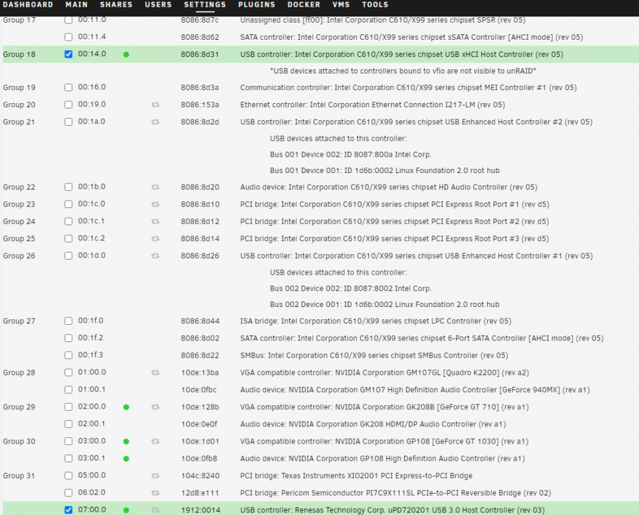

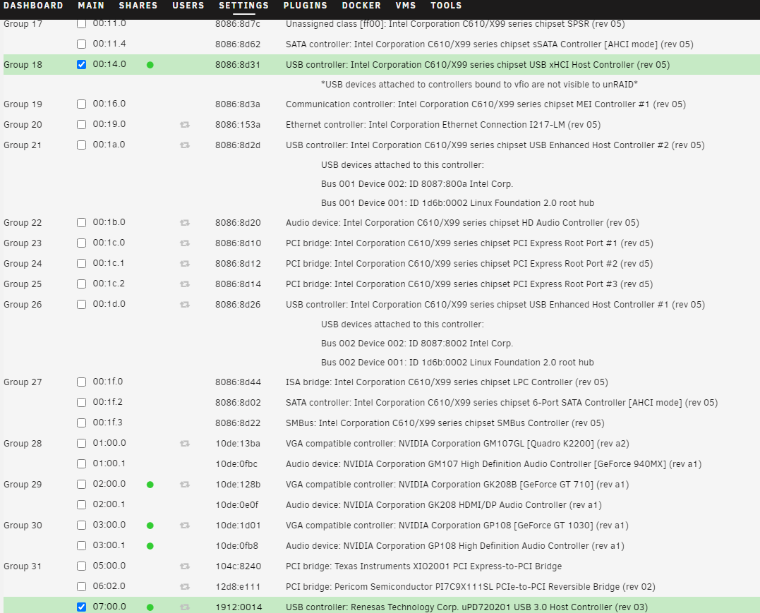

I just started the vm with with the native usb, so i could see what's going on.  the device manager shows one of those two card under usb devices.  This is the card that is broken out from slot 4.  I wanted to be sure, so i pulled the card from slot 6 and refreshed the device manager.
i attached the pci map.  The two "Renesas" cards appear to have different numbers, but maybe not different enough?

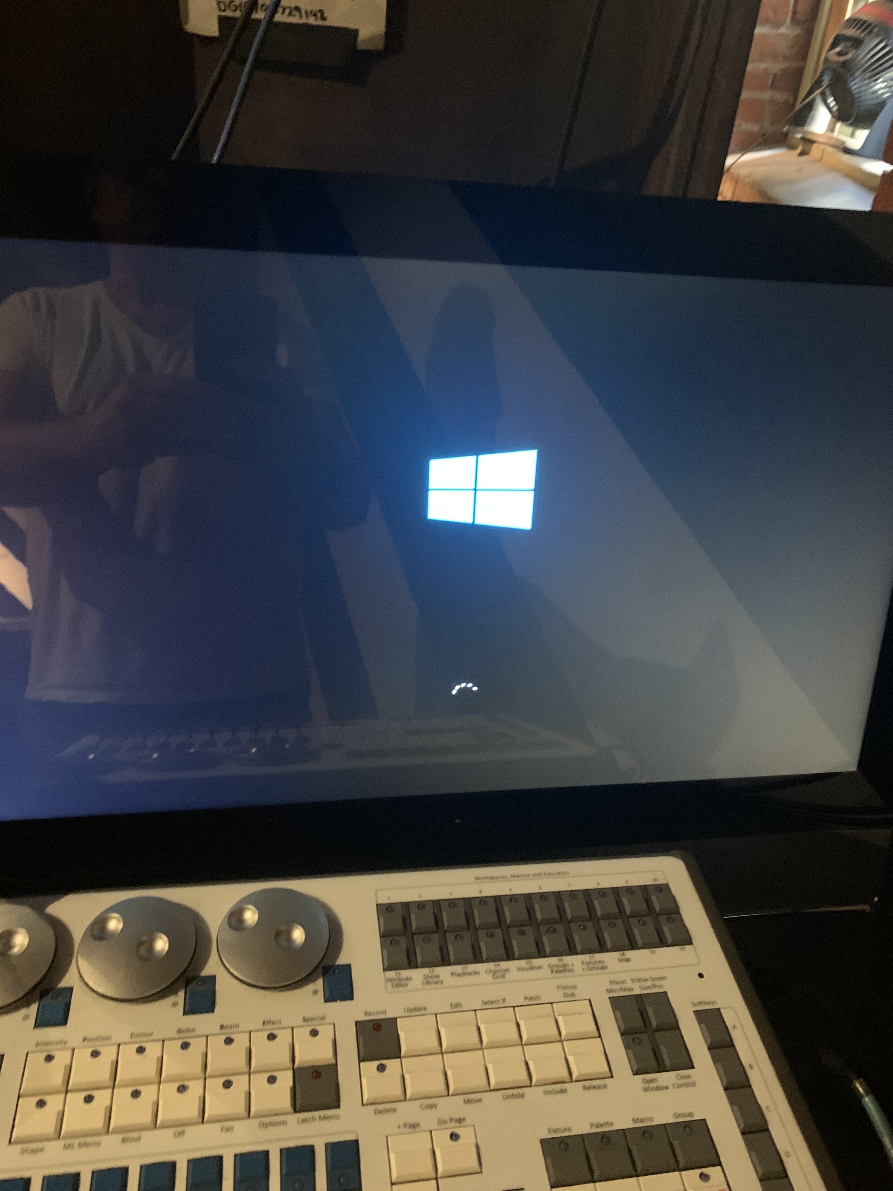

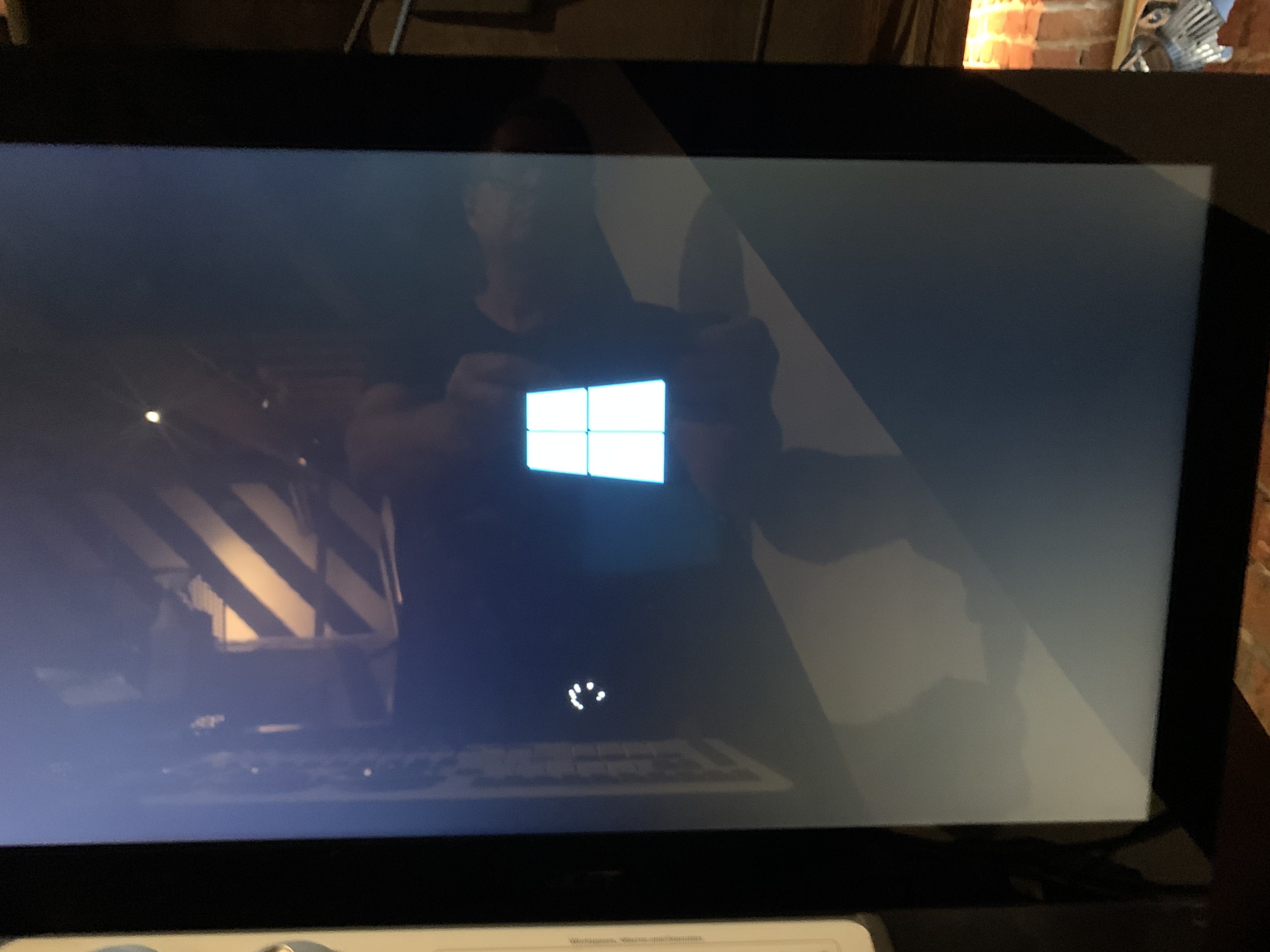

put everything back and just tried to start the one vm that has the Renesas slot 6 card forwarded.
Vm hangs on windows start screen.  It appears that forwarding that card screws up the whole program. It won't even let me shut down from the unraid control panel.  I have to force close it

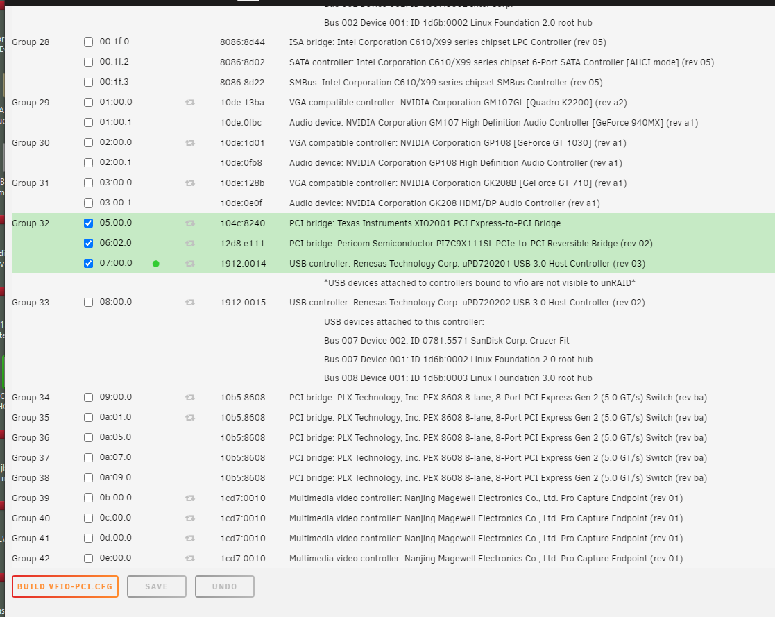

here are the groups
Are you passing 1912:0014 or 1912:0015 through to the vm that's crashing. If it's 1912:0014 you'll probably have to pass through the rest of the iommu 32 group as well, or at least add it to your vfio-pci to prevent unraid from trying to access it.
Edited by mikotoiii
USB pass through is very fickle.
As above are the other devices in IOMMU 32 part of the card, in which case pass them all through. If not it may be worth moving  the Unraid USB drive to IOMMU 32 and then pass through 33 to the VM as it seems to be on it's own. Unfortunately this generation of chipset doesn't implement IOMMU very well so results can vary and the IOMMU seperation shown may not be reality.
I have a pair of Asmedia USB controllers with seperate physical chips on the manboard connected by PCI-E, however I can only pass them through together and even then they are not reliable, working fine with HDD but not keyboard or mouse. The Intel integrated controller is fine to pass through.
18 hours ago, Decto said:
I already tried selecting all three items in IOMMU 32 with the VFIO-PCI Config plugin.  It didn't appear the fix anything. I didn't see the other two items in the vm to forward.  Maybe I will try that again.

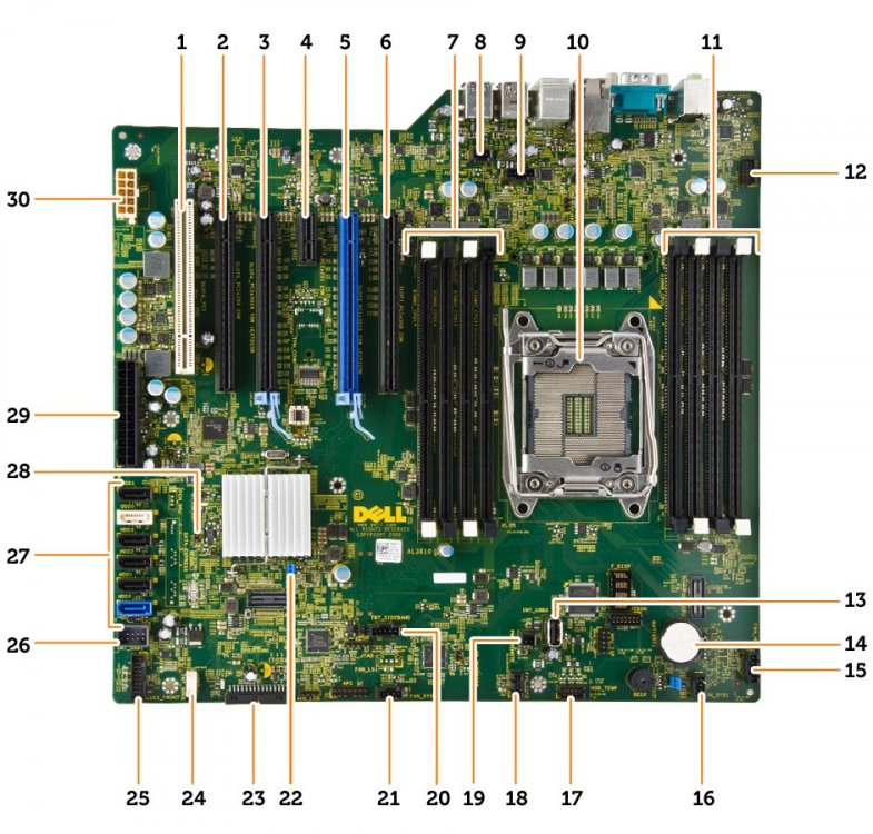

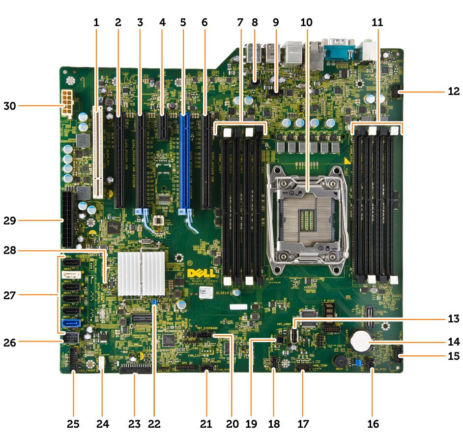

If you can, check the motherboard manual. It could be that your pci bus is sharing the same bus as the pci-e 2x slot. If you post up the model of your Dell server i can see if I can find anything.
This is the motherboard
Dell 5810
Edited by 22350
I checked the manual and can't see anything that would cause your issue. I am wondering if it might have something to do with the breakout cable that you have.
The only other thing that I saw was the it lists that server as capable of 2 video. https://www.dell.com/support/manuals/is/en/isdhs1/precision-t5810-workstation/precision_t5810_om_pub/technical-specifications?guid=guid-cb1a5aa6-1e70-44b9-b690-59507a3a9f31&lang=en-us

I think you might be right.  if you look at the IOMMU, the cable entries in group 32 are not green dotted.  But it is important to remember that this is the card, that is working.  It is the other card in slot 6 is the card that is having trouble.

Ok,  so i swapped the card aroun and put the pcie x2 card directly into port 4.  Exact same issue.  So, it isn't the extender cable.
So, to recap, if I don't have that card in slot 4, I can put the Unraid flash in either native or the pci card in slot 6 and there are no issues.  That, of course is not passing that card through.
My feeling is that it isn't the PCIe x2 (slot 4) card is not the issue at all.  The issue is passing through the legacy PCI card  [slot 6]

Intel controllers are often grouped as you see.
Group 18 is the xHCI controller (USB 3.0), this is backwards compatible with the USB 2.0 and will be linked to the 4+ ports
Group 21 and 26 are eHCI controllers (USB 2.0)  usually 2 ports per controller.
Usually the eHCI and xHCI are all connected to the same group of ports. If you don't need USB 3.0, disabling USB 3.0 (if possible) may allow you to pass through the two USB 2.0 controllers individually. You can experiment with enable / disable of xHCI, eHCI handoff in the BIOS.  Motherboards behave differently so there is no magic pre solution. That may remove the requirement for one of the cards.
It looks like the PCI card is driven from the chipset by a PCI-E to PCI controller, the card then reverses that with a PCI to PCI-E controller which then interfaces with a PCI-E USB 3.0 Controller. An old native PCI to USB 2.0 controller may be a better bet if you can find one to avoid the additional bus conversion.
Do you have 1912:0015 bound to vfio-pci as well? You're other screenshots that show both cards have it listed as not bound to vfio-pci.
Is 1912:0015 what you're trying to run unraid from, and 1912:0014 what you're passing through to the vm?
Can you follow the attached guide and make sure that all the ports on both cards aren't on the same busses, etc? It looks like 1912:0015 could be running on bus 7 and bus 8 from previous screenshots.

So, at this point, I was able to use a hacksaw on the fan shroud of my 80 dollar video card and make enough room to get the PCIe x2 card into the back of the box.
I then moved the unraid usb to the slot 6 PCI card.  All the pass through works fine now.  I think there is some sort of issue passing through the legacy pci slot.
At this point, if it is working, I am fine with this solution.
