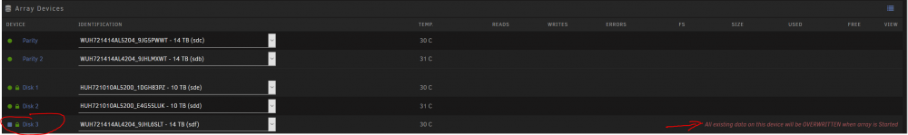

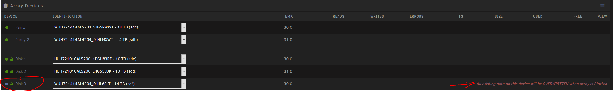

Hello, I had recently took my rack offline to redo the cable management. After rebooting one of my three XFS Encrypted (Data) disks (not my 2 parody) is not recognized by unraid as an existing disk and is suggesting to format it when I start the array. I would like to avoid a complete format parity rebuild if possible since it should be unnecessary due to the fact no information changed on the disks, it's only not being recognized as part of the array for some reason.

Sorry for the late reply I had to run an errand. I'm not considering making that mistake, that's why I made the forum post before proceeding. I'm not really sure what to do in this situation, I've never had a single disk from the array randomly decide they are no longer part of an array that I've had running without issue for over a year. The reason I said that is literally what the array devices page is suggesting I do in that screenshot. I am well aware that would cause more issues than I am currently having. I have to start the server back up, I will send diagnostics after.

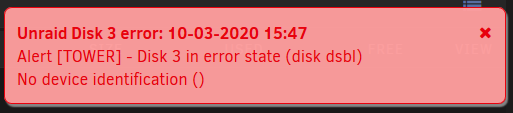

Here are the diagnostics and a snip of the in browser push notification error. I need to meet someone to pick up the cat5e cable I ordered, I will be back in 30 minutes to an hour.

That diagnostic is without the array started so can't tell anything about the emulated disk3.
Start the array and post a new diagnostic.

Emulated disk3 is mounted so rebuild should be OK. Is unassigned disk sdf serial ending 6SLT the disk that should be assigned as disk3?
It is the same disk, the only thing that may have changed is the SAS slot its in may have been changed to another unpopulated one (I'm on the old 45drives chassis finicky cables that stop working) but in unraid the disk order is the same. The thing that is concerning me is when I try to mount the disk, unraid says it will over write all my data on my disk when it already is encrypted and has my data on it. So absolutely sure I can just mount it and start the array then without issue?
