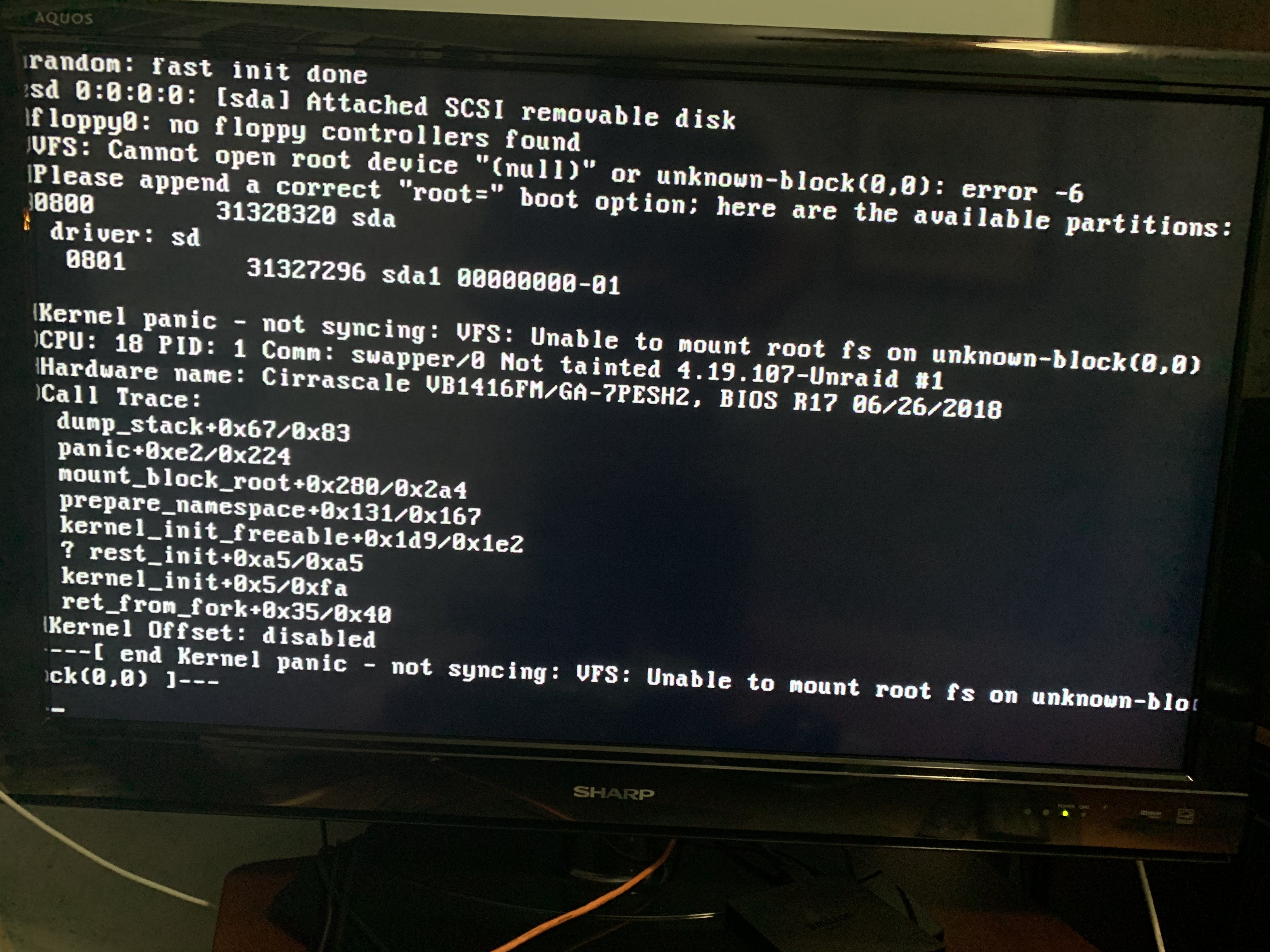

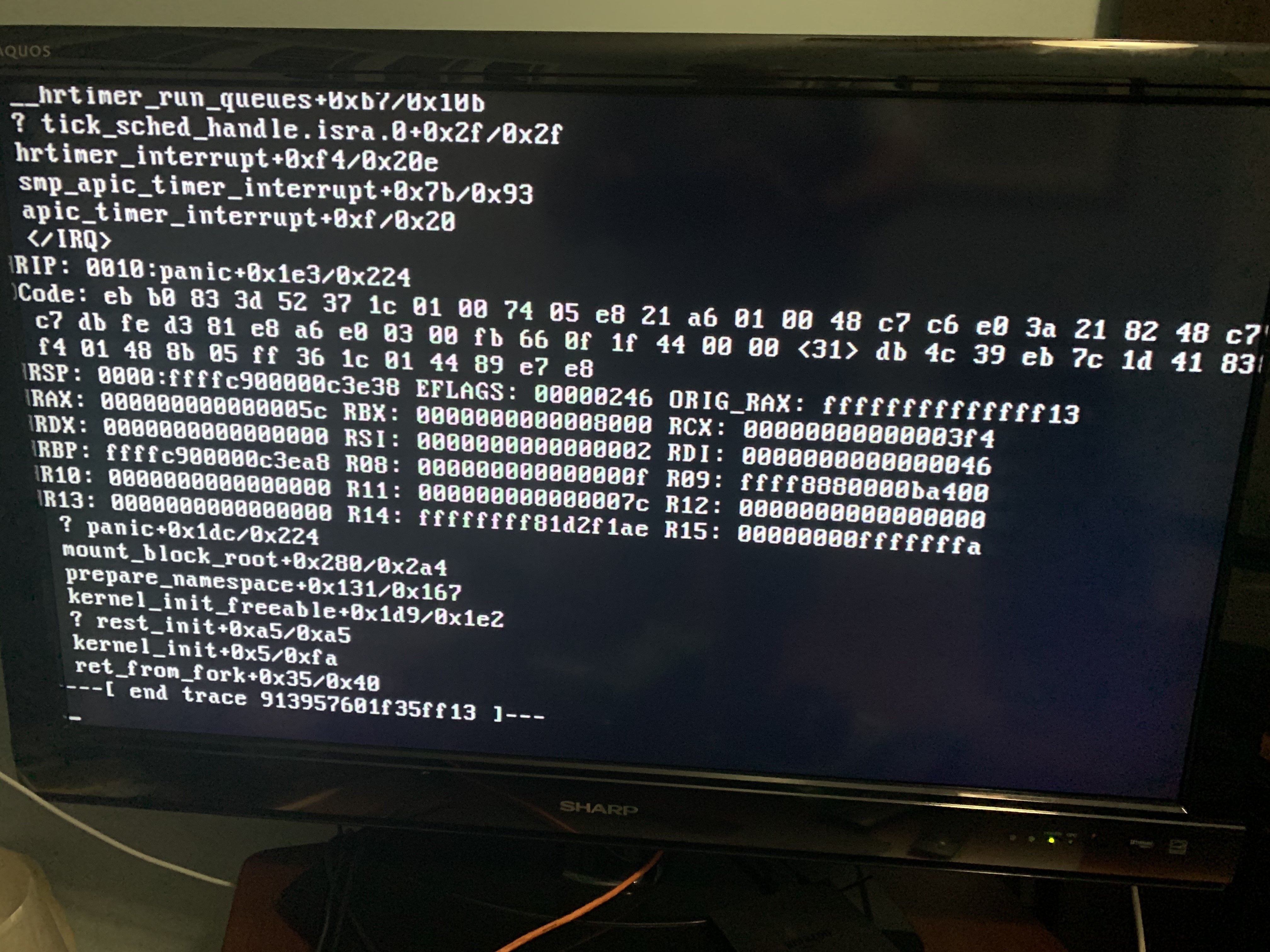

Kernel Panic - not syncing VFS
Had the first issue about a month ago, when I randomly found Unraid crashed, upon restart I got this error.
I recreated my USB drive and it booted up normally and worked fine until yesterday.  Now, I'm getting the crashes and errors more often, but was able to get unraid to boot in Web GUI mode.  I'm also seeing this error on boot sometimes.
I removed half of my 64 GB of ram to try and isolate a bad ram module.  However, I'm still seeing the errors booting with either half of the ram removed.
Also, on the last boot, the system booted up running on only one processor and half the ram.
So, any ideas on where to start troubleshooting this issue?

Hi everyone, first post here.
I just wanted to give you my 5 cents on this topic and how I partially* solved it (running a Mac Pro 5,1 from 2012).
I upgraded to 6.10 today and after the reboot I was stuck with the same error message
VFS: Cannot open root device "(null)" or unknown-block(0,0): error -6
Please append a correct "root=" boot option;
Kernel panic - not syncing: VFS: Unable to mount root fs on unknown-block(0,0)
I tried the solutions mentioned in other posts like adding /root/sda, only copy the bz* files and what not, nothing worked. Reformated the USB-stick and ran diskpart to clean it and all that, still no luck. I tried the same with 6.9.2 (what I was running before the update) and still got the same error message. I did all this from Windows and figured I might as well could try the USB creator tool from my MacBook, and lo and behold.. it worked..
