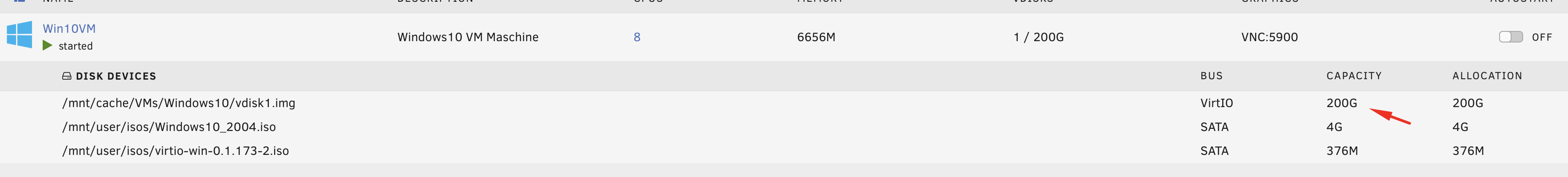

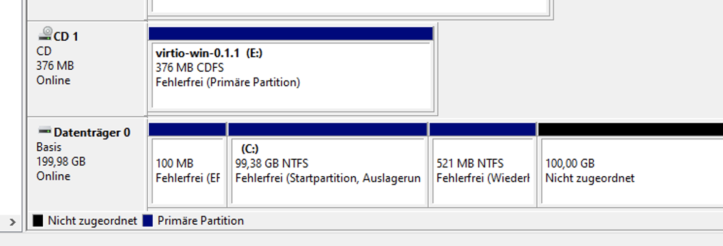

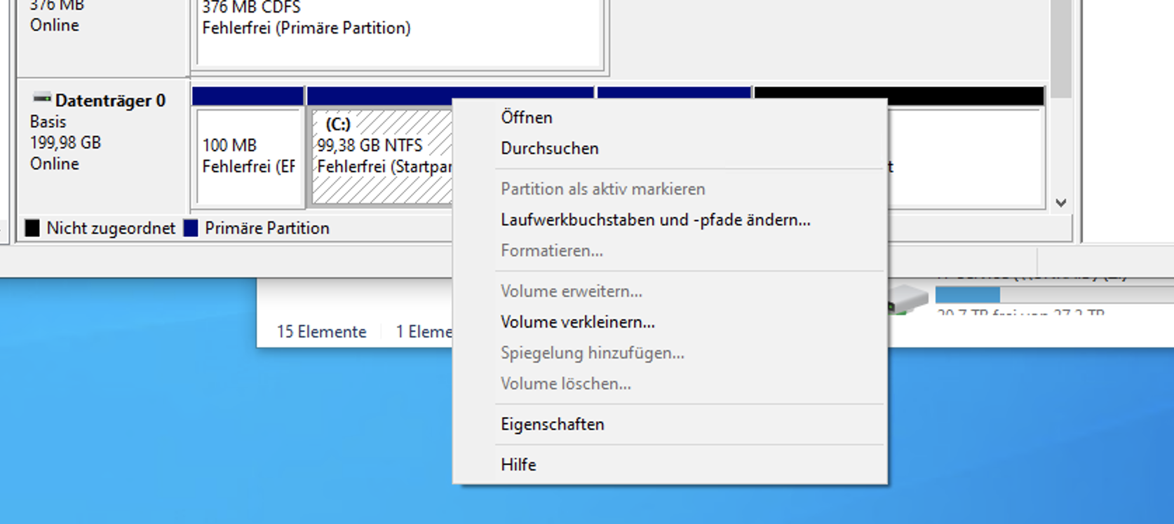

October 7, 20206 yr Hi there! I am using the actual stable version of UNRAID 6.8.3. I created a VM with 100G Space for the C Drive. Now I want to increase this volume to 200G but unfortunately it is not possible. Thats the steps what I've done: 1. Shut down the VM 2. Change the Volume Sice in UNRAID 3. Start the VM 4. See that there is a unformatted partition: 5. Tried to expand the Volume, but it is not possible. There is only the possibility to shrink the already in use volume, not to expand. Ive tried a restart of the VM but it is still not possible to increase the volume. Do I miss a step which is needed? Many thanks for your help! BR Chris Edited October 7, 20206 yr by painkillerchris
October 7, 20206 yr It's not possible to expand because of the existing small partition in the end, you'd need to move that partition before with a partition utility app.

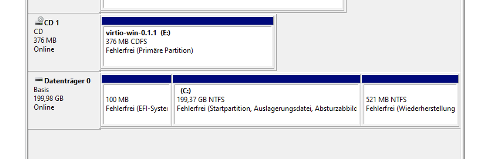

October 7, 20206 yr Author For all who are interested, it works now perfectly. I found this free Tool: https://www.paragon-software.com/de/free/pm-express/#resources And now it looks like this: Many thanks for the help! 🤩 🤩
