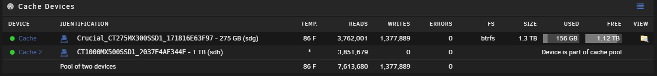

4. I added a new SSD to the system, which was recognized immediately, and a cache pool was created. This didn't resolve the problem, all errors continued. No docker apps available, no updates possible.

Adding a new cache device by default results in a raid1 pool, it won't increase available space, also not a good idea to add a device with a full filesystem, besides the device you added dropped offline (check cables), but first you need to free up some space on cache, move or delete some data.
The UI is showing the cache space increased after adding the drive.
No writes into the new drive so I assume that is just a limitation. Well, I deleted some files and now the cache utilization is below the capacity of the original, smaller cache drive. Can I go ahead and perform a balance to convert the cache to Raid0 while having still some data in the drive?
Single mode is what you want instead of raid0

Yes, it's a "downloads" pivot folder monitored by other apps. The system was doing just fine with the small SSD, the issue started once I started downloading too many large files. The files needed to stay longer for seeding which tested the limit of the drive. Definitely poor balance from my side, nothing to blame on the software. I now want to increase the cache size to have more capacity. After reading the FAQ in more detail, I'll balance the cache into single mode.
