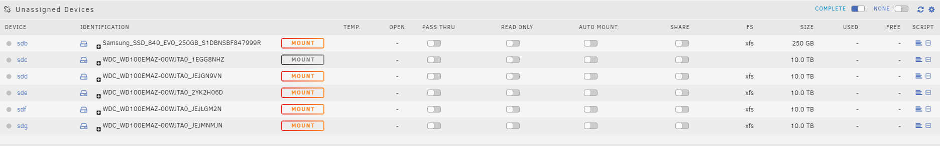

I'm now confronted with the issue of remembering which disk was parity, and which disks were part of the data set. I see my cache drive which is the only ssd, but every one of my disks is a 10TB WD shucked disk so they're almost identical.
I installed the unassigned devices plugin. Would I be correct in assuming the one disk that isn't xfs is the parity drive? Does the order of the other data drives matter?

That would be correct as the parity drive does not contain a file system.
if you only had the ‘parity’ drive then order does not matter (it does for the parity2 drive).
Yes. No.
