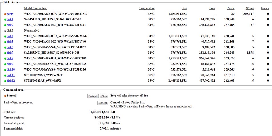

So it looks like I made a big mistake when I ran the reiserfsck on /dev/sde rather than /dev/sde1. Luckily I cloned that drive onto the new 1TB drive last night with dd_rescue. From there I ran reiserfsck on the new cloned drive that I made (which was /dev/sdd1 in this case) which fixed a few errors and voila, I was able to mount and browse the disk. From the web menu I now had the option to start the array with all disks accounted for. The array is currently running a parity check on the system and is detecting the replaced drive as 1Tb with 750GB used (as the original drive was an almost full 750GB drive this is correct).
So in approximately 3000 and some odd minutes my array should be as it was originally again and safe with parity! ^_^
Now however there is the issue of troubleshooting the bad SATA connection that originally caused this headache. Some of you noticed issues in the system log, could you elaborate? What lines in particular should I be looking at? Like I said previously nothing new has been done to the array and there is a quality 450w power supply installed so I don’t think there is an issue there. Thus I will be trying to determine if it is either the SATA card, the cable or the Disk Enclosure.

Jan 23 11:28:52 Tower emhttp: Device inventory:
Jan 23 11:28:52 Tower emhttp: pci-0000:00:1f.2-scsi-1:0:0:0 host14 (sdm) ST31500341AS_9VS40APX
Jan 23 11:28:52 Tower emhttp: pci-0000:01:01.0-scsi-0:0:0:0 host0 (sda) WDC_WD20EADS-00R6B0_WD-WCAVY0681517
Jan 23 11:28:52 Tower emhttp: pci-0000:01:01.0-scsi-1:0:0:0 host1 (sdb) SAMSUNG_HD103SJ_S246JDWZ505547
Jan 23 11:28:52 Tower emhttp: pci-0000:01:01.0-scsi-2:0:0:0 host2 (sdc) WDC_WD10EACS-00ZJB0_WD-WCASJ2212341
Jan 23 11:28:52 Tower emhttp: pci-0000:01:01.0-scsi-3:0:0:0 host3 (sde) WDC_WD7500AYYS-01RCA0_WD-WCAPT0519525
Jan 23 11:28:52 Tower emhttp: pci-0000:01:01.0-scsi-4:0:0:0 host4 (sdf) WDC_WD20EADS-00R6B0_WD-WCAVY0725247
Jan 23 11:28:52 Tower emhttp: pci-0000:01:01.0-scsi-5:0:0:0 host5 (sdg) WDC_WD10EACS-00ZJB0_WD-WCASJ1871740
Jan 23 11:28:52 Tower emhttp: pci-0000:01:01.0-scsi-6:0:0:0 host6 (sdh) WDC_WD7500AYYS-01RCA0_WD-WCAPT0514867
Jan 23 11:28:52 Tower emhttp: pci-0000:01:02.0-scsi-0:0:0:0 host9 (sdi) WDC_WD20EARS-00J2GB0_WD-WCAYY0097406
Jan 23 11:28:52 Tower emhttp: pci-0000:01:02.0-scsi-1:0:0:0 host10 (sdj) WDC_WD7500AAKS-00RBA0_WD-WCAPT0261038
Jan 23 11:28:52 Tower emhttp: pci-0000:01:02.0-scsi-2:0:0:0 host11 (sdk) ST31000528AS_9VP0W2GT
Jan 23 11:28:52 Tower emhttp: pci-0000:01:02.0-scsi-3:0:0:0 host12 (sdl) WDC_WD7500AYYS-01RCA0_WD-WCAPT0516136
Jan 23 11:28:53 Tower kernel: md: import disk3: [8,64] (sde) WDC WD7500AYYS-0 WD-WCAPT0519525 offset: 63 size: 732574552
Jan 23 11:28:53 Tower kernel: md: disk3 new disk
Jan 23 11:28:53 Tower kernel: md: disk7 removed
Notice that the handling of ata4 is identical to ata7, happens to be identical drive models.  No restart lines!
Careful analysis of the above leads to 2 different possibilities, either or both of which could be causing the issues.
Possible issue #1:  this WD model (WDC_WD7500AYYS-01RCA0) is partly incompatible with the 8 port controller; the only reason I included ata7 above is to show that it has the same model of drive (but serial ending in 867), and it consistently has some difficulty on startup, identical to the Disk 7 on ata4 in the 4th syslog; a flaw with this possibility is that the 'new disk' had even more severe problems when connected to ata8, but while I know it is a different size (1TB), I don't know if it is a very similar model, and also incompatible
  Troubleshooting suggestion: move all of these WD models off the 8 port card, and connect other drives to each of the 8 port SATA connectors, then check a subsequent syslog.  It should clearly prove or disprove this possibility.
Possible issue #2:  the 8th SATA port has failed, or unreliable (possibly other SATA ports affected too, such as ata4 and ata7)
  Troubleshooting suggestion: connect a known good drive (but not any of the suspect WD model) to ata8, and check subsequent syslog
I don't see any indicators of bad SATA cables.  Power is always a possible issue, although you feel you have a good one.  Could you elaborate on what you mean by the "Disk Enclosure"?
The initial slow speed may be due to fixing the parity errors, it should dramatically increase after it passes the point of the earlier abort.
I noted above that there were issues with the onboard ports.  If Dell hasn't limited access to it, in the BIOS settings prior to booting, you should be able to change the handling of the SATA drives supported onboard to use an AHCI mode, or at least a native SATA mode, anything else but IDE modes.  This is completely irrelevant to any of your issues though, and if you cannot change it, it does work OK.
