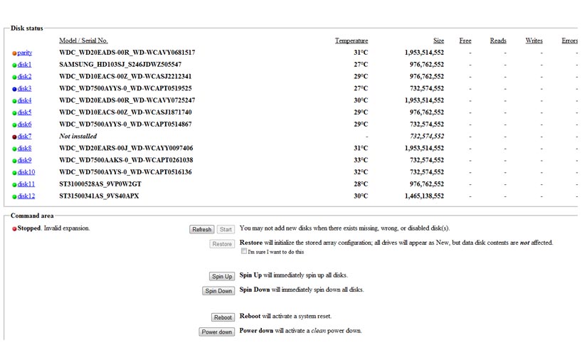

OK, here’s an update on the issue so far.
Overnight I completed the copy from Disk 7 to new disk (dd_rescue.log attached), which I did by using a RIP boot rescue linux disk that has dd_rescue built in. Everything copied without issue or errors which was my first clue that it may not be the disk at all.
I then installed the new disk into Disk 7’s previous slot in the array; however this did not work as I had hoped. Basically the enclosure LED on disk 7 stayed lit the entire time the array was powered on and it took almost 10x longer to boot normal (I actually thought it had frozen). When it did finished booting I was not able to access the unraid web management at all (Syslog_1009_23-01-11). I could however login locally and via telnet.
This has me now believing that perhaps it is an issue in the interface itself, either a cable or in the enclosure itself – note however leading up to this there were no recent hardware changes to the box. To test this I again removed the disk from slot 7 and moved the OLD presumably failing Disk 7 to one of the empty Slot 3 in the array (Syslog_1303_23-01-11). The array has now come good, web management is back and what I thought was a failed drive is not being detected correctly.
I tried to run reiserfsck on md3 but it could not detect and device on /dev/md3 (reiserfsck.txt)
I’ve also included a smart report from the drive and it appears good (smart_log).
Now I’m not completely sure how to proceed. As you can see from the web menu screencap (1255_23-01-11), my only option is to kick off a rebuild. However I noticed that if I set host3 to disk7 that I get the option to kick off a data rebuild...
Many of you have commented that if I stopped the parity before it went on too long that I should be able to recover from it. This should be a viable option in that case as I cancelled it before it had completed even a fraction of a percent. Does it matter that my parity is now showing orange and says it is up to date from the 22nd?
I’m also hesitant to upgrade my unraid version until I can completely determine what issue(s) actually exist on the system. I mean if the upgrade where to go badly there is potential to aggravate the situation yeah?
Thanks again to all those that have lent their help.

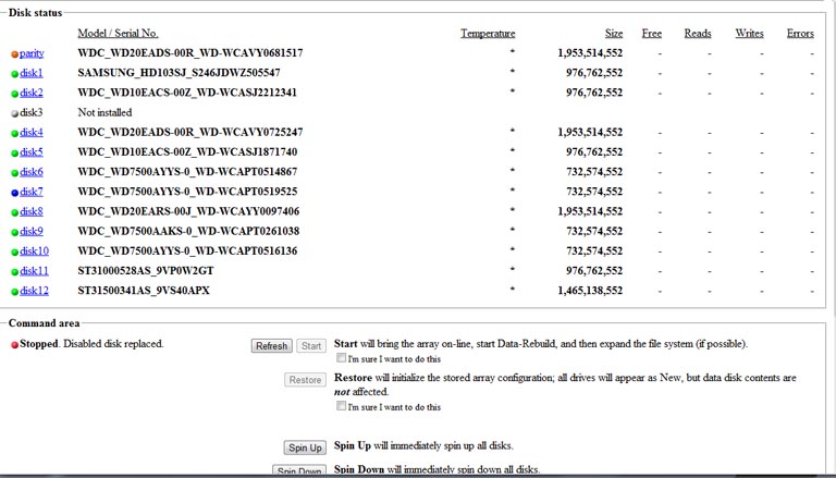

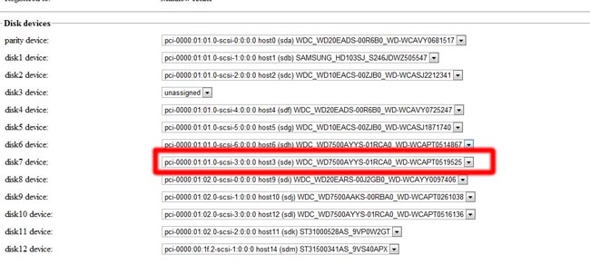

Did you move the drive on the devices page only or did you do it in hardware too? You can change the hardware SATA port and still use the same disk slot on the devices page.
Did you try running reiserfsck using sdX where X is the port this damaged disk7 is connected to. The true sdX will show on the devices tab for each drive.
Unfortunately, unRAID won't display if the drive is showing as formatted with a partition or not until the array is started. You could do another "Restore" and start the array. Immediately as fast as possible stop the parity build though. Then, you can see if the drive mounted and the data is still there. At this point, there isn't much that you can hurt if you get that parity build stopped very quickly. I suspect the drive is OK and you just had a SATA port problem and you'll find the drive is just fine.
Peter
You have provided a lot of info (thank you for that), but I'm not completely confident I understand the whole situation.  I was a little confused by the way you used the term 'slot' above, but what I think you meant was that you physically removed the 'new disk' and unassigned it as Disk 7, then physically reinstalled the old Disk 7 and assigned it as Disk 3.  Hopefully I have that correct?  The new disk does not appear in the physical Disk Inventory, and the old disk 7 does (SN ending in 525), but assigned as Disk 3.
That SMART report looks very good, another very good sign.  However, I cannot tell if the Reiser file system on it is corrupted or not.  There was a problem mounting the Reiser file system in one of the earlier syslogs, but that may be because of a bad SATA port (more on that later).  I recommend stopping the array and running reiserfsck directly on the drive, by typing the following command at a console.  At this point, we aren't worried about maintaining parity, so this method is a little different than the usually recommended method (Check Disk File systems).  In the last syslog, your disk had the device ID of sde, but you should verify the correct ID from the Devices page.

"You can change the hardware SATA port and still use the same disk slot on the devices page."
Thats exactly what I have done. The disk is now in slot 3 but assigned as drive 7.

So do I continue trying to recover the drive with the reiserfsck or do I try and let the parity drive rebuild it? Is there any way that I can verify if the parity information is even intact?
The correct device to use would be /dev/sde1
(note the trailing "1")
The file system is on the first partition, not the base device name.  That is why no superblock was found.
To run a reiserfsck you would need to use either the /dev/mdX device, or the /dev/sdX1 device.
If you use the former parity will be maintained.  If you use the latter, it will not.
Try
reisefsck --check /dev/sde1
