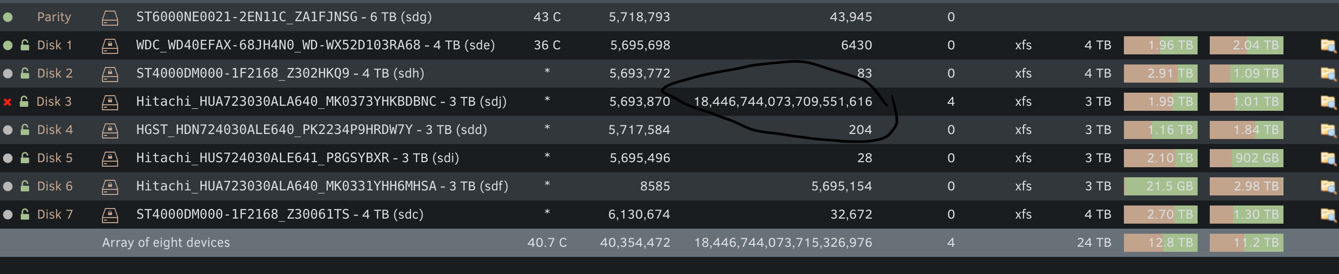

This is a fairly new drive... any idea what's going on w/ the write count? The numbers a crazy
basically meaningless since
54 minutes ago, trurl said:
it is disconnected.
Did you?

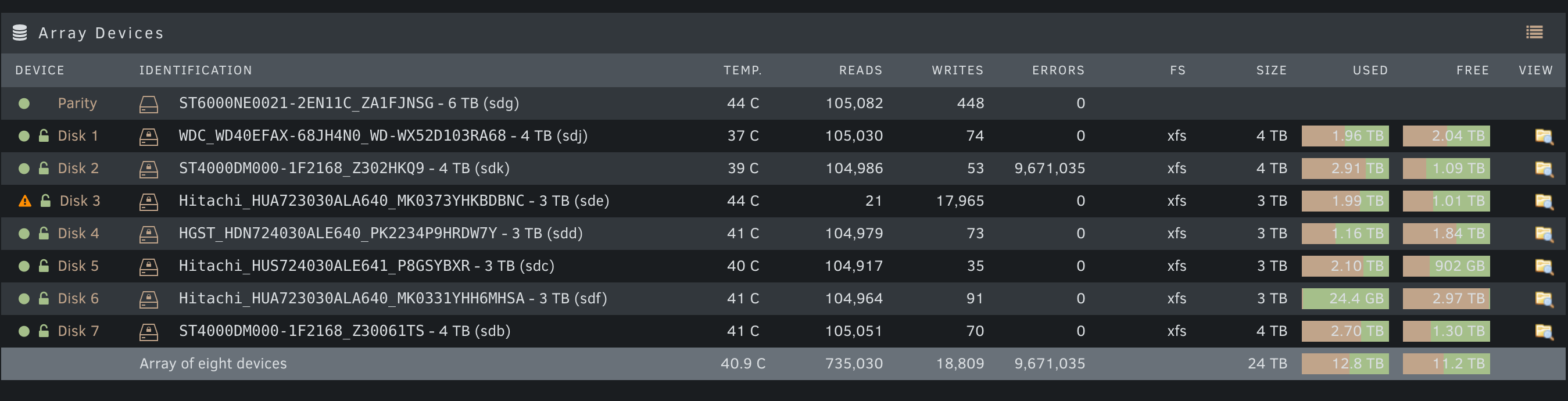

I've checked over all of the cabling. Everything looks good and there seemed to be proper communication.  I haven't seen any smart errors on my disk 3 and decided to follow the above. After the rebuild began, I'm now seeing a ton of errors on my disk 2. Any idea what's going on? This is a brand new disk with a lot of important data on it.
I've paused the rebuild and am including a new diagnostics. Do I need to replace the cabling on this drive?
nas-diagnostics-20201027-0839.zip
Edited by Matthew Kent
It looks as if disk2 has dropped offline (so there is no SMART information for that dtive in the diagnostics) and in that case no point in trying to continue rebuild of disk3.
Doing a power cycle on the server may be required to bring it back online.    As always you want to check the SATA/power cabling to the drive.    New diagnostics after the reboot should allow us to check that it looks OK.
