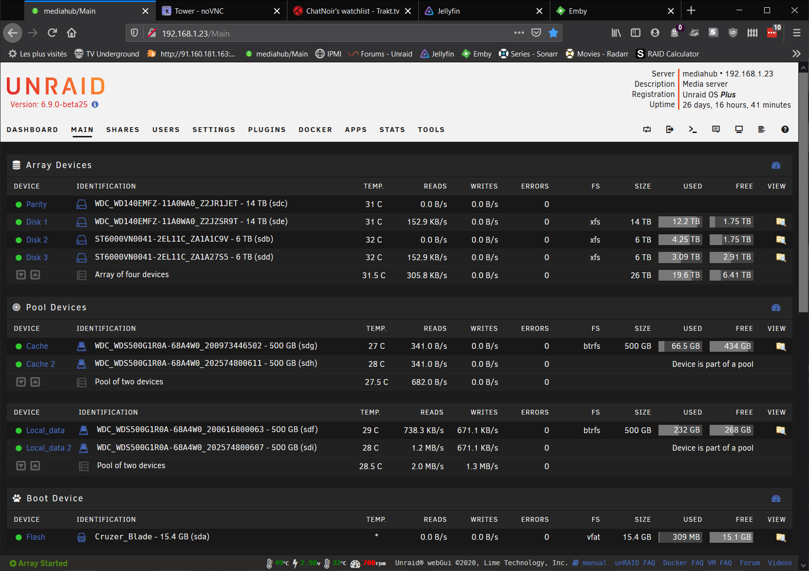

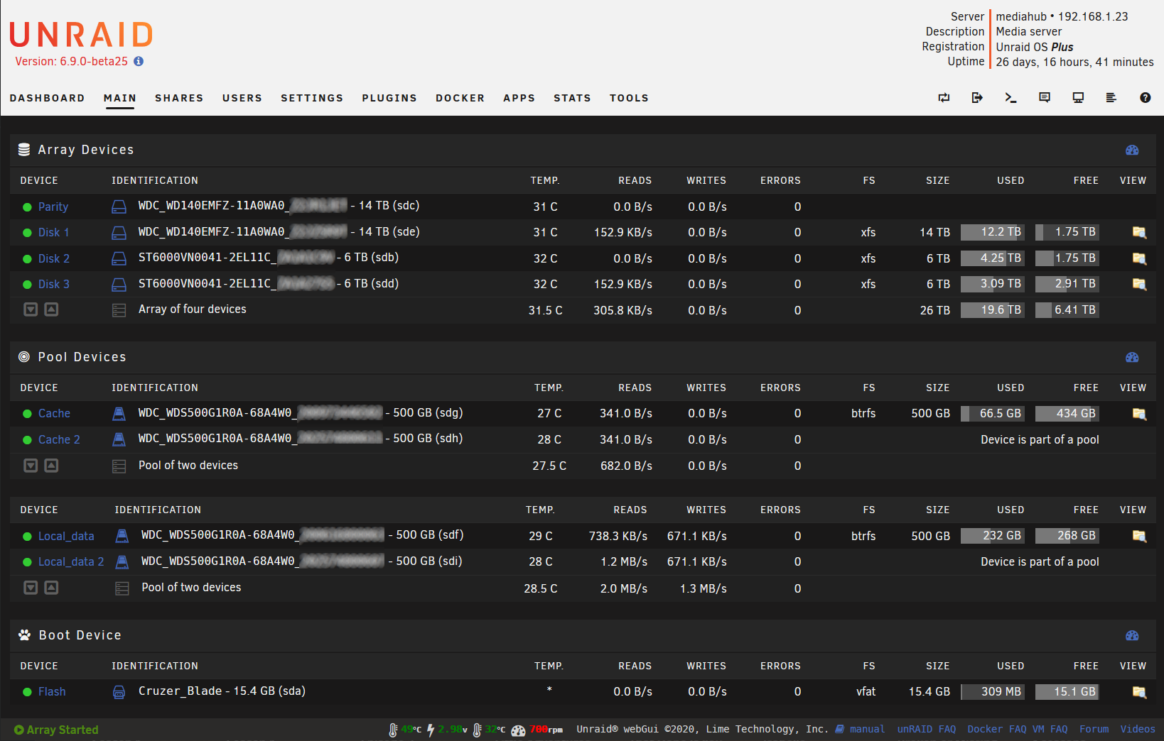

My setup is with 2 pools with a RAID1 of 2 500GB RED SSD each:

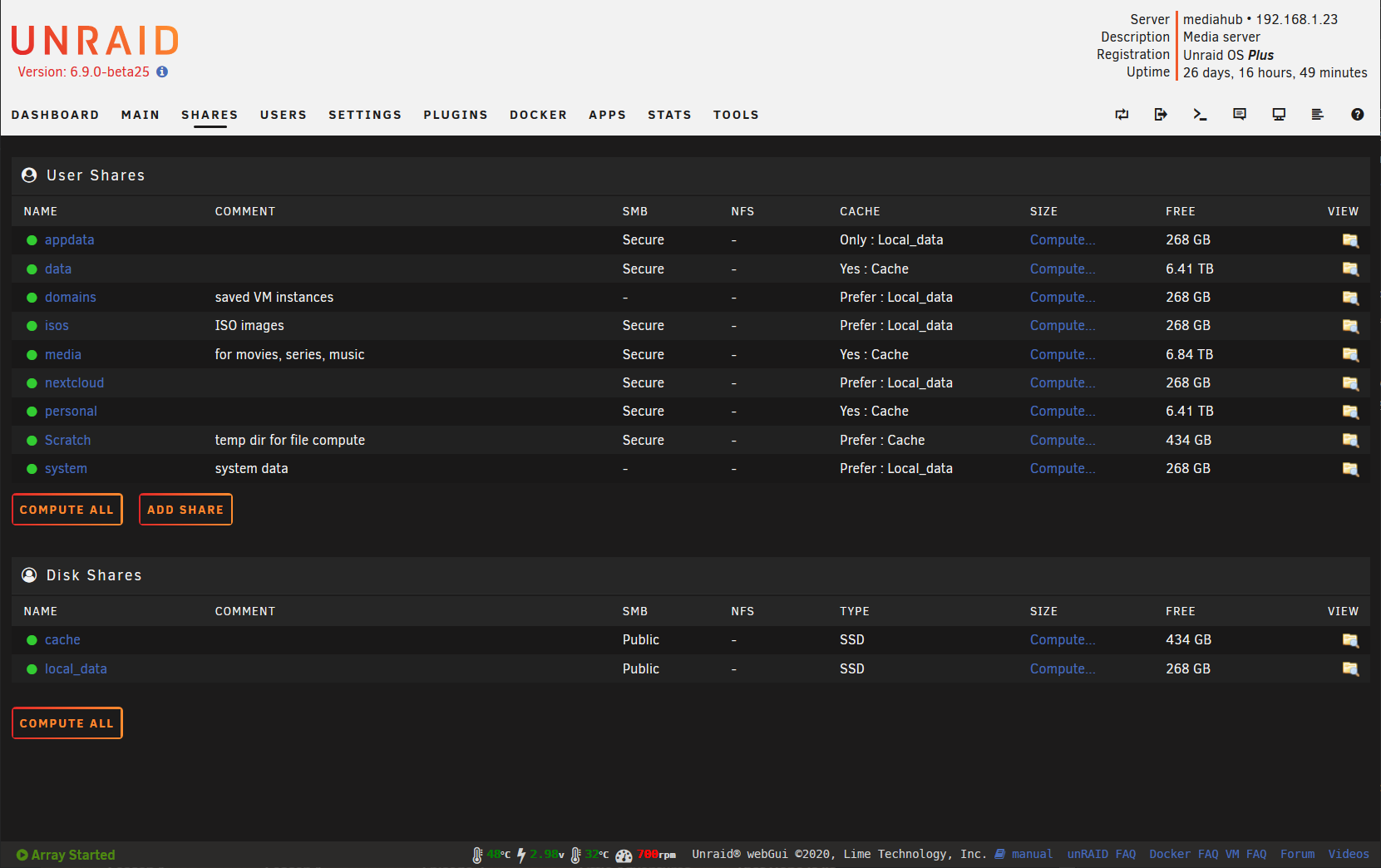

  • cache (oscillating between 30 to 300GB with): for general caching of most of my shares. I also have some cache prefer shares with data that I want to edit before moving it to manually to a cached share.
  • local_data (around 230GB): for my docker appdata (90%), domains, isos, system (9%) and nextcould
I do not do any downloading on the server, I manage all the file transfers manually so I do not risk having a pool filling up if I am not careful.
This works well but there are three points that make me think about only using a single pool with the 4 drives and keep the same level of protection:
  1. One pools means I would not have to be AS careful as I am actually.
  2. I might get a bit more speed from the pool this way.
  3. I wonder if splitting the appdata over 4 drives would spread the writes better and improve the longevity overall.
Maybe I am overthinking it but an outside opinion is welcome.
Here is some more infos:
