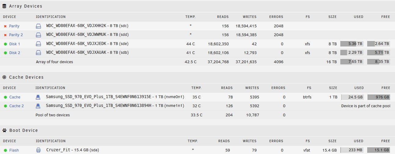

Everything worked fine and the System runs stable, but as soon as I want to write files to the Data-HDDs I get much HDD-Errors.
Often some thousands and at two or more drives simultanously:

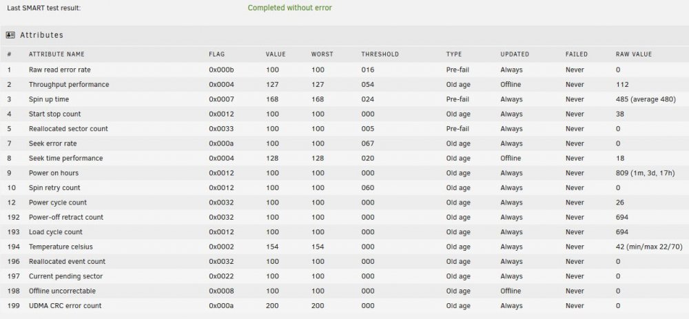

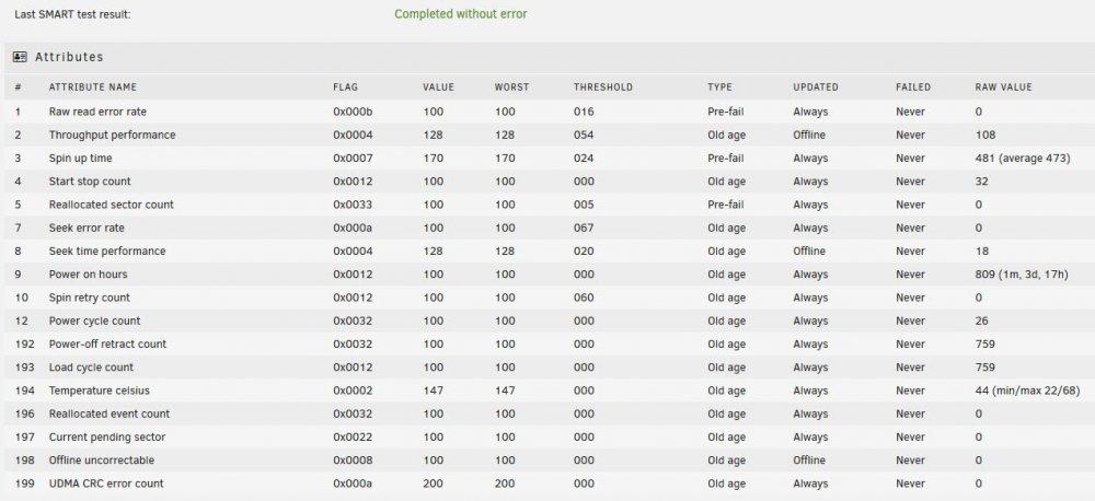

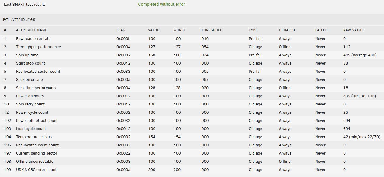

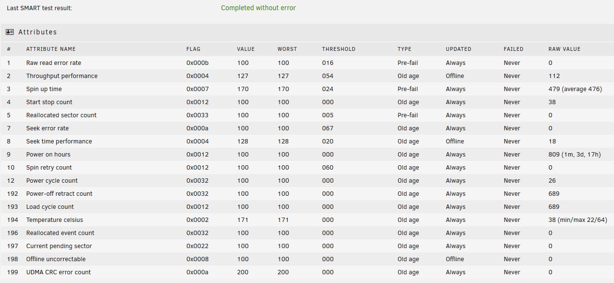

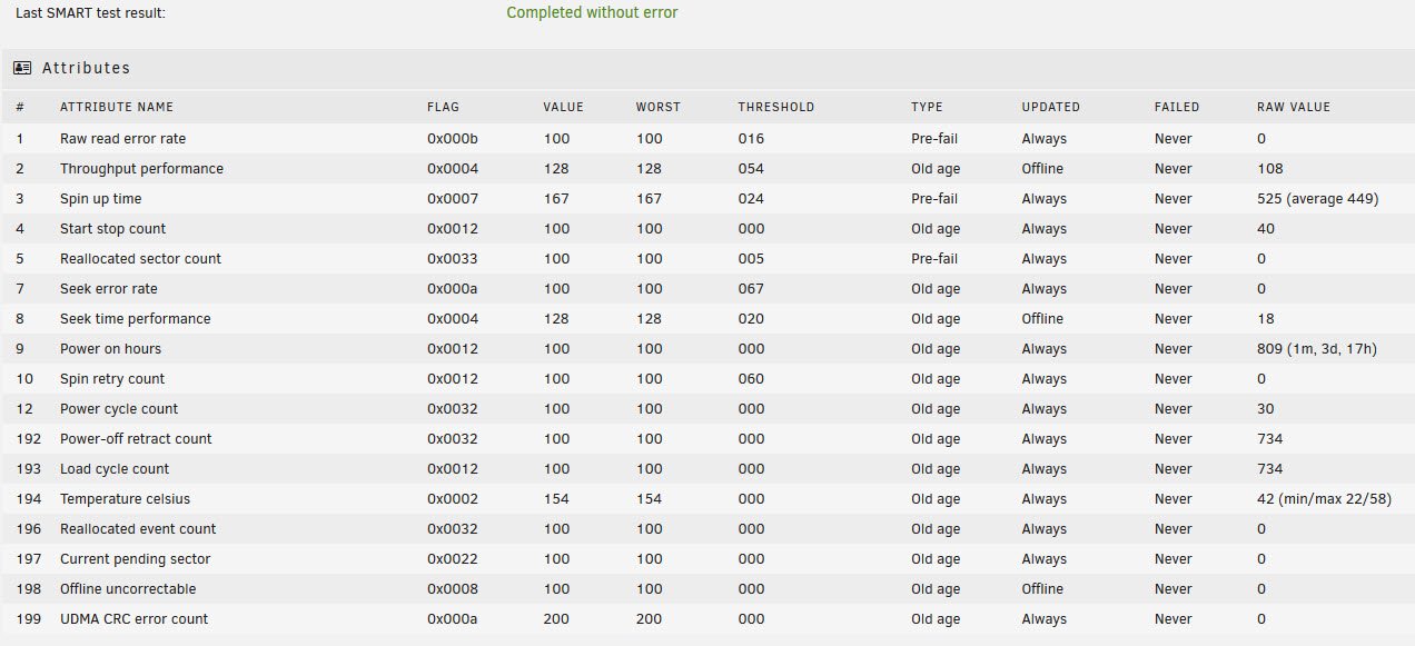

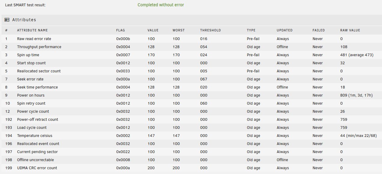

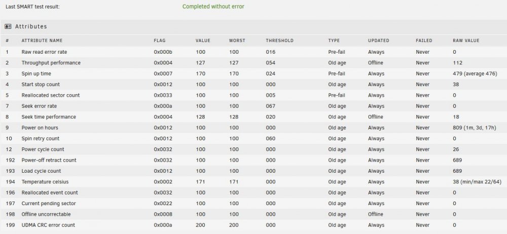

I think the Smart-Tests are ok. (?) - See attached pictures:

- Finaly I had a new array with "0" errors.
- Then I tested the array by copying some files from my Win-PC to a Unraid user share (via Cache-SSDs)
- In the meantime I've seen, that the two parity disks were spun down.
- The other two data-HDD's haven't spun down - I think because shortly before I accesed the user shares.
- As soon I started the Mover manually, I got the errors on the parity drives.

That the two parity drives are affected seems to be pure coincidence.
Yesterday Data Drive 1 and 2 were also affected.
In one case there were errors on 3 or all 4 drives simultanously.

5 hours ago, JorgeB said:
LSI firmware is very old, try again after updating to latest.
I'll try it tonight.
Then I'll build new my parity drives and test again.
Hi JorgeB,
like you said, I updated the BIOS and Firmware of the LSI-Controller and of my Motherboard.
Thanks a lot for your superb instruction how to flash the Controller under Unraid !
The parity-build finished now with no errors (like before).
Parity-Discs were spun down and I've copied a file to the system without any error.
Now it seems that all works fine! Let's have a look if it's lasting, when I'll copy more files to the NAS.
Your advice to update was right. I thought about that too, but wouldn't belive in that,
because the controller has run in the other server with no problems.
Thanks a lot again for your hint and instruction.
