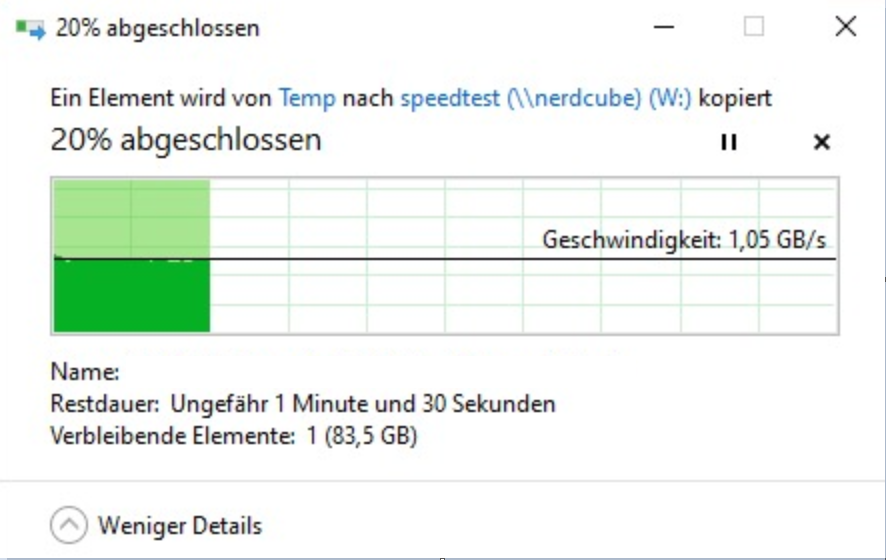

I got an answer on reddit from someone who had this adapter. He tried it and it didnt work. I got 2 used ASUS XG-C100C 10GBe cards in the end. Which was a better deal anyway. If you have a very fast NVMe SSD as your Cache Drive you can saturate the SSD easily with this cards.
As Lucanus pointed out the driver was the problem in the end.
The only downside to the card is that one of my PCIe Slots is blocked by it now. Which is not a problem if you have enough. But I have a MicroATX Server Build in a Fractal Design Node 804 and Slots are rare.
