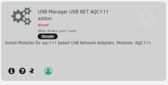

August 22, 20215 yr On 7/7/2021 at 1:23 PM, Golmak said: I have tested on UnRaid 6.9.2 it is the same. It shows up in System Devices but is not assigned as a network interface ... Have a good day ich777 has created a package for me and I have create a plugin to install that should appear in CA to install the module. I have not been able to test if it works with an adapter or if you can use with Unraid network settings. Edited August 22, 20215 yr by SimonF

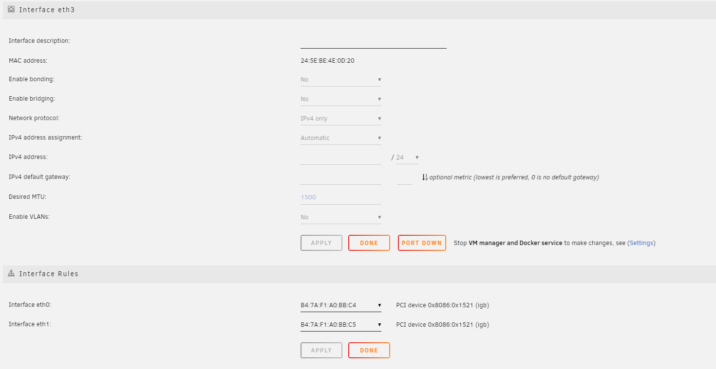

August 24, 20215 yr On 8/22/2021 at 3:18 PM, SimonF said: ich777 has created a package for me and I have create a plugin to install that should appear in CA to install the module. I have not been able to test if it works with an adapter or if you can use with Unraid network settings. thanks for your works, but when i install this module in Unraid 6.9.2 , The OS add this Qnap AQC111 usb ethernet card, but in [ Interface Rules ] Coloum i can't see this usb ethernet card info, so i can't chanage eth0 to Qnap aqc usb ethernet card, which i want to replace the system original 1Gbps i350 nic to boot and for unraid main use. is there need to change /boot/config/network-rules.cfg to add this usb aqc111 card info? Edited August 24, 20215 yr by gzelvis

August 24, 20215 yr 1 hour ago, gzelvis said: thanks for your works, but when i install this module in Unraid 6.9.2 , The OS add this Qnap AQC111 usb ethernet card, but in [ Interface Rules ] Coloum i can't see this usb ethernet card info, so i can't chanage eth0 to Qnap aqc usb ethernet card, which i want to replace the system original 1Gbps i350 nic to boot and for unraid main use. is there need to change /boot/config/network-rules.cfg to add this usb aqc111 card info? what do you get from ifconfig.
August 25, 20215 yr 19 hours ago, SimonF said: what do you get from ifconfig. root@HOMESERVER:~# ifconfig docker0: flags=4163<UP,BROADCAST,RUNNING,MULTICAST> mtu 1500 inet 172.17.0.1 netmask 255.255.0.0 broadcast 172.17.255.255 inet6 fe80::42:9fff:fe03:8684 prefixlen 64 scopeid 0x20<link> ether 02:42:9f:03:86:84 txqueuelen 0 (Ethernet) RX packets 769736 bytes 503056618 (479.7 MiB) RX errors 0 dropped 0 overruns 0 frame 0 TX packets 731398 bytes 568106147 (541.7 MiB) TX errors 0 dropped 0 overruns 0 carrier 0 collisions 0 eth0: flags=4163<UP,BROADCAST,RUNNING,MULTICAST> mtu 1500 inet 10.0.0.88 netmask 255.255.255.0 broadcast 0.0.0.0 ether b4:7a:f1:a0:bb:c4 txqueuelen 2000 (Ethernet) RX packets 150754356 bytes 177547905334 (165.3 GiB) RX errors 0 dropped 4148724 overruns 0 frame 0 TX packets 189578572 bytes 275264539550 (256.3 GiB) TX errors 0 dropped 0 overruns 0 carrier 0 collisions 0 device memory 0x87400000-874fffff eth3: flags=4163<UP,BROADCAST,RUNNING,MULTICAST> mtu 1500 inet6 fd27:f9d1:9a96:1:265e:beff:fe4e:d20 prefixlen 64 scopeid 0x0<global> inet6 fe80::265e:beff:fe4e:d20 prefixlen 64 scopeid 0x20<link> ether 24:5e:be:4e:0d:20 txqueuelen 1000 (Ethernet) RX packets 167 bytes 40214 (39.2 KiB) RX errors 0 dropped 0 overruns 0 frame 0 TX packets 35 bytes 7376 (7.2 KiB) TX errors 0 dropped 0 overruns 0 carrier 0 collisions 0 lo: flags=73<UP,LOOPBACK,RUNNING> mtu 65536 inet 127.0.0.1 netmask 255.0.0.0 inet6 ::1 prefixlen 128 scopeid 0x10<host> loop txqueuelen 1000 (Local Loopback) RX packets 293689 bytes 357824408 (341.2 MiB) RX errors 0 dropped 0 overruns 0 frame 0 TX packets 293689 bytes 357824408 (341.2 MiB) TX errors 0 dropped 0 overruns 0 carrier 0 collisions 0 veth2f7ce7d: flags=4163<UP,BROADCAST,RUNNING,MULTICAST> mtu 1500 inet6 fe80::d8bd:a9ff:fe56:d8fb prefixlen 64 scopeid 0x20<link> ether da:bd:a9:56:d8:fb txqueuelen 0 (Ethernet) RX packets 260551 bytes 333788126 (318.3 MiB) RX errors 0 dropped 0 overruns 0 frame 0 TX packets 377938 bytes 128551510 (122.5 MiB) TX errors 0 dropped 0 overruns 0 carrier 0 collisions 0 veth4690b2c: flags=4163<UP,BROADCAST,RUNNING,MULTICAST> mtu 1500 inet6 fe80::287f:c1ff:fed6:85ad prefixlen 64 scopeid 0x20<link> ether 2a:7f:c1:d6:85:ad txqueuelen 0 (Ethernet) RX packets 35817 bytes 10980138 (10.4 MiB) RX errors 0 dropped 0 overruns 0 frame 0 TX packets 1643 bytes 1377443 (1.3 MiB) TX errors 0 dropped 0 overruns 0 carrier 0 collisions 0 veth83343a5: flags=4163<UP,BROADCAST,RUNNING,MULTICAST> mtu 1500 inet6 fe80::64df:dbff:fe0b:7199 prefixlen 64 scopeid 0x20<link> ether 66:df:db:0b:71:99 txqueuelen 0 (Ethernet) RX packets 346240 bytes 135829660 (129.5 MiB) RX errors 0 dropped 0 overruns 0 frame 0 TX packets 298284 bytes 352301682 (335.9 MiB) TX errors 0 dropped 0 overruns 0 carrier 0 collisions 0 veth978f18c: flags=4163<UP,BROADCAST,RUNNING,MULTICAST> mtu 1500 inet6 fe80::c82e:56ff:feaf:17d6 prefixlen 64 scopeid 0x20<link> ether ca:2e:56:af:17:d6 txqueuelen 0 (Ethernet) RX packets 5028 bytes 1589778 (1.5 MiB) RX errors 0 dropped 0 overruns 0 frame 0 TX packets 40363 bytes 31394156 (29.9 MiB) TX errors 0 dropped 0 overruns 0 carrier 0 collisions 0 vethbf14116: flags=4163<UP,BROADCAST,RUNNING,MULTICAST> mtu 1500 inet6 fe80::68d2:7dff:fe18:8b5 prefixlen 64 scopeid 0x20<link> ether 6a:d2:7d:18:08:b5 txqueuelen 0 (Ethernet) RX packets 87685 bytes 22856750 (21.7 MiB) RX errors 0 dropped 0 overruns 0 frame 0 TX packets 118597 bytes 22230503 (21.2 MiB) TX errors 0 dropped 0 overruns 0 carrier 0 collisions 0 virbr0: flags=4099<UP,BROADCAST,MULTICAST> mtu 1500 inet 192.168.122.1 netmask 255.255.255.0 broadcast 192.168.122.255 ether 52:54:00:47:39:b2 txqueuelen 1000 (Ethernet) RX packets 0 bytes 0 (0.0 B) RX errors 0 dropped 0 overruns 0 frame 0 TX packets 0 bytes 0 (0.0 B) TX errors 0 dropped 0 overruns 0 carrier 0 collisions 0 --------------------------------------------------- eth3 is the usb aqc111 usb ethernet card . and i found it will not auto get ipv4 adresss
August 25, 20215 yr IOMMU group 3:[8086:a36d] 00:14.0 USB controller: Intel Corporation Cannon Lake PCH USB 3.1 xHCI Host Controller (rev 10) Bus 002 Device 001: ID 1d6b:0002 Linux Foundation 2.0 root hub Bus 002 Device 002: ID 0424:2660 Standard Microsystems Corp. Hub Bus 002 Device 004: ID 1c04:0015 QNAP System Inc. QNAP QNA-UC5G1T USB to 5GbE Adapter Bus 003 Device 001: ID 1d6b:0003 Linux Foundation 3.0 root hub Bus 003 Device 003: ID 090c:1000 Silicon Motion, Inc. - Taiwan (formerly Feiya Technology Corp.) Flash Drive
August 25, 20215 yr if any more information u need, plz let me know。 eth3 can't be found in [Interface Rules] so i cant chage unraid to use it as eth0 for main network use
August 25, 20215 yr 1 hour ago, gzelvis said: if any more information u need, plz let me know。 eth3 can't be found in [Interface Rules] so i cant chage unraid to use it as eth0 for main network use Have you tried a reboot following install of the plugin? I have one of these on the way. So cant do my own testing at present. It may need a rule adding to udev rules as I think this only gets build at boot time. root@computenode:/etc/udev/rules.d# cat 70-persistent-net.rules # PCI device 0x10ec:0x8168 (r8169) SUBSYSTEM=="net", ACTION=="add", DRIVERS=="?*", ATTR{address}=="2c:f0:5d:d7:2a:11", ATTR{dev_id}=="0x0", ATTR{type}=="1", KERNEL=="eth*", NAME="eth0" -- # PCI device 0x15b3:0x1003 (mlx4_core) SUBSYSTEM=="net", ACTION=="add", DRIVERS=="?*", ATTR{address}=="f4:52:14:0e:b5:c1", ATTR{dev_id}=="0x0", ATTR{type}=="1", KERNEL=="eth*", NAME="eth2" # PCI device 0x15b3:0x1003 (mlx4_core) SUBSYSTEM=="net", ACTION=="add", DRIVERS=="?*", ATTR{address}=="f4:52:14:0e:b5:c0", ATTR{dev_id}=="0x0", ATTR{type}=="1", KERNEL=="eth*", NAME="eth1" root@computenode:/etc/udev/rules.d#
