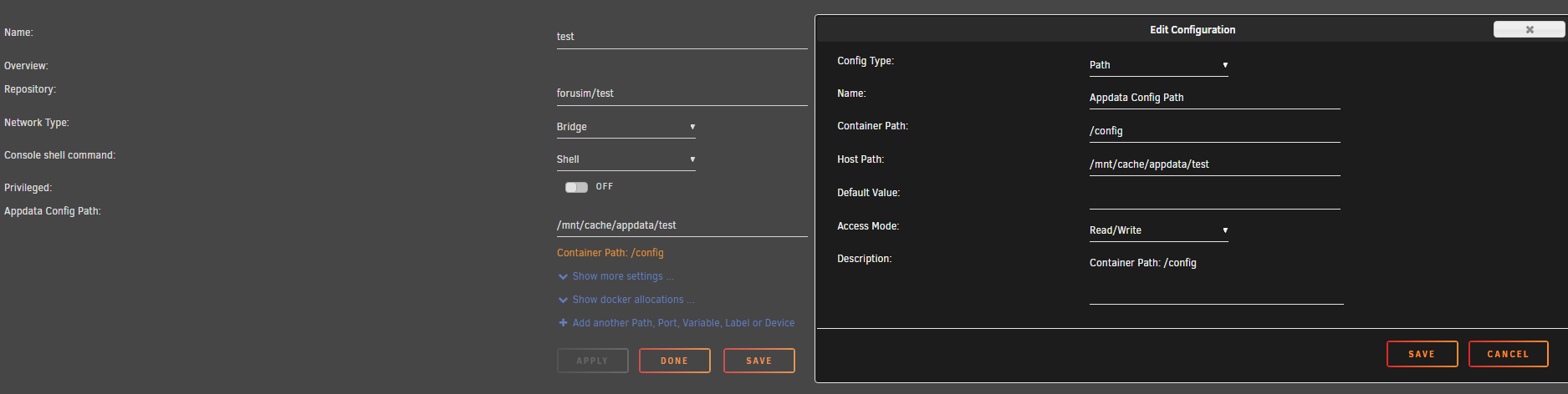

  2. @primeval_god Thanks for clarification. Non-intuitive is an understatement to say at least. Maybe there is a good reason, why it is working the way it is, but I find my use case reasonable. I have now solved it, like you suggested in the entrypoint.sh.
  3. From the linked reference I understood, that you can "put" files into the volume during the build time via Dockerfile. Somehow this only works only during the runtime, but then I do not see a point in volume declaration in Dockerfile and can directly map it on docker run. However I want to have all required files routed to one location and map in the Unraid gui only this one /config location.
  4. Hello, I appologies, if my question is too nooby, but I was not able to figure out, what I am doing wrong. I am running Unraid 6.9.2 and was mostly a docker user, but not a developer. I want to create a custom docker, which pulls some python apps from git (not my repo) and run it there. This python app has some hardcoded config / logs paths, which I would like to route via a volume to a persistent store on /mnt/cache/appdata/my-docker. I tried it via Dockerfile, like it is described here, but the created files are not initialy in the volume, when I start the docker contrainer. I made a sample project to show my issue. Dockerfile: FROM alpine RUN apk add --no-cache bash RUN mkdir /config RUN echo "test" > /config/config.yaml VOLUME /config COPY entrypoint.sh /entrypoint.sh ENTRYPOINT ["bash", "/entrypoint.sh"] entrypoint.sh #!/bin/bash echo "Run in loop" while true; do sleep 30; done; Docker config in Unraid From above I would expect on first start of the container the "config.yaml" file to be inside /mnt/cache/appdata/test. However the file is not created in the contrainers /config and therefore is not inside /mnt/cache/appdata/test. When I execute the command 'echo "test" > /config/config.yaml' in the running container the file shows up in /mnt/cache/appdata/test. Do I missunderstand, how the volume is supposed to work?

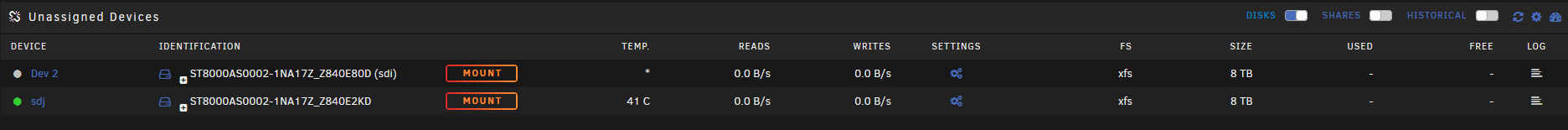

  6. Somehow I messed up the device names in UD with my formatting attempts. The disk, which was initially Dev 1 - ST8000AS0002-1NA17Z_Z840E2KD (sdh) is now only sdj. This would not bother me, but now I cannot spin down the disk anymore (the green dot is not clickable for this disk). And when I click on the sdj link to attributes and SMART info, it only display "Can not read attributes" sections. How can I fix this to initial behaviour?
