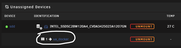

  • 3. Get the unassigned drive name
    • Go to the Main tab and find the name of the unassigned drive you want to use. For example, in this screenshot I have a disk named ua_docker. This drive name is what you will use in all the steps below when they ask for <unassigned_drive>

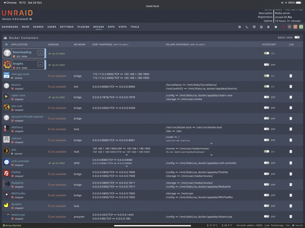

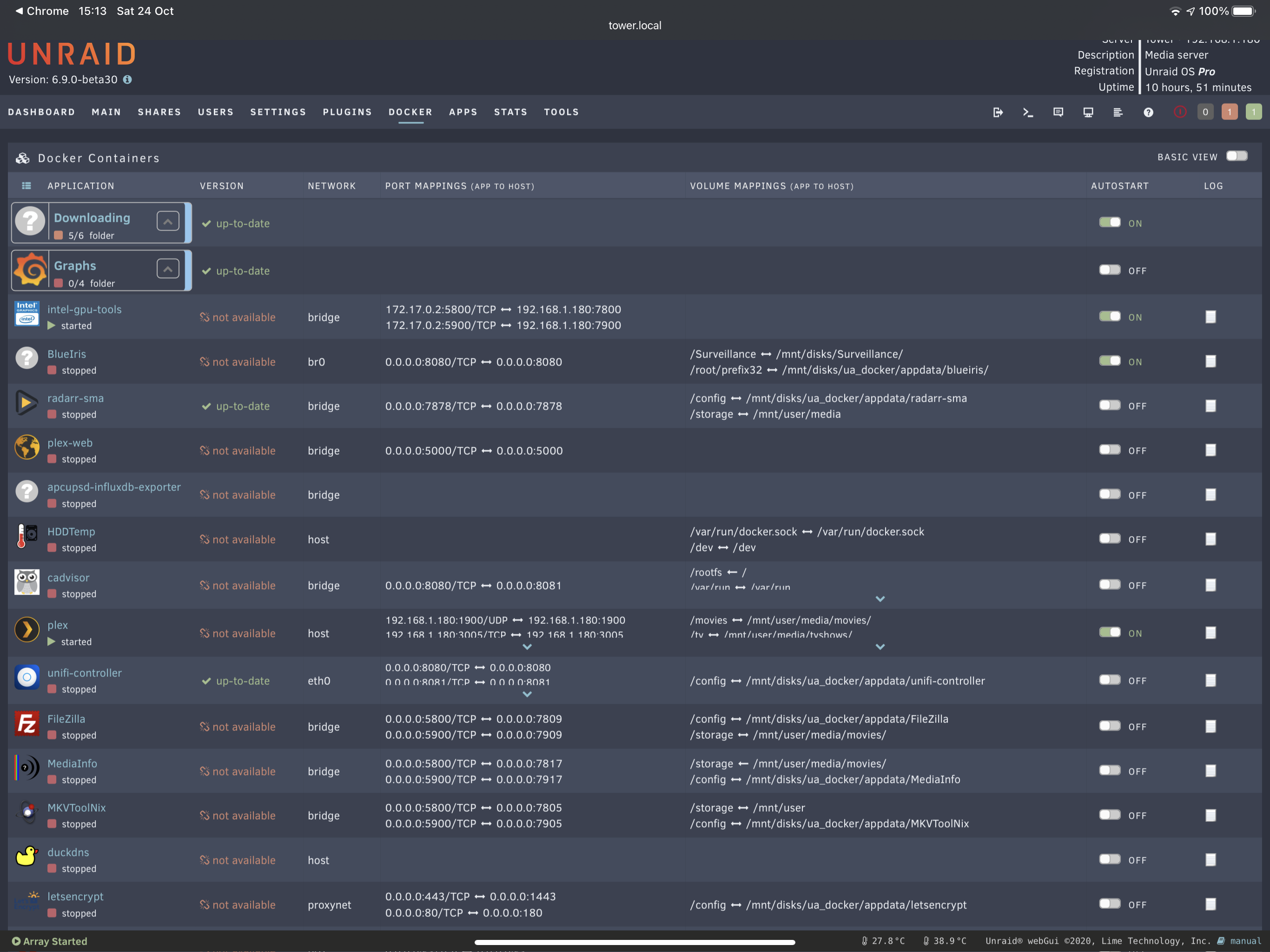

But now when I startup Unraid I have to disable Docker before starting the array and then when its started I can turn on Docker but quite a few of them don’t work and the docker screen looks like the one attached.
I just installed radarr-sma for example but the install filed and when I click launch it says "Execution Error" and below 'Server Error'?

Without going through the massively complicated directions, since you're using 6.9, instead of utilizing an unassigned device for things, you're better off (and it's going to just plain work better) if you had instead created a new cache pool.
But, for the execution error, edit the container, make a change any change, revert it then hit apply.  The exact reason why it's failing will appear following the docker run command that appears.
Cheese Squid but how come all my Docker Containers now show version: not available?
I also had to uninstall Radarr as it stopped working that's why I did a demo try with that Radarr-sma.
