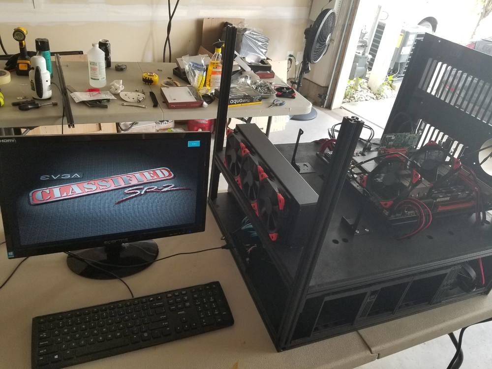

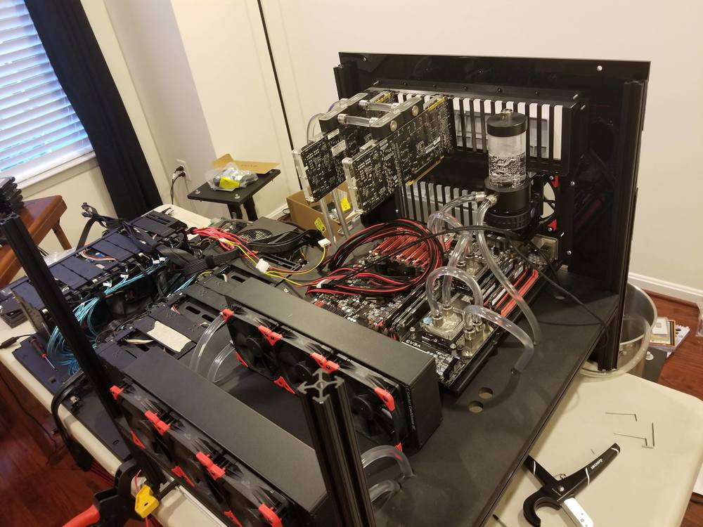

Unfortunately some bloody idiot (me.......) designed this custom case to be the most pain in the ass thing to get access to you can possibly imagine.image.png.d62364e0cc558edb5325092e3ded3cac.png
See https://linustechtips.com/topic/353971-an-introduction-to-project-egor-the-never-ending-story/
I've since put in a new motherboard and CPU that old SR-2 gave its last breath folding for a cure for COVID :(
ever since I put it back together some things in the "basement" of that case have been.... "wonky" I guess I'm going to have to finally take the time to tear it all apart to try to find a bad SATA cable wish me luck!
