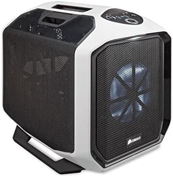

I was considering the Corsair 380T, but It lacks spaces for 3,5" drives

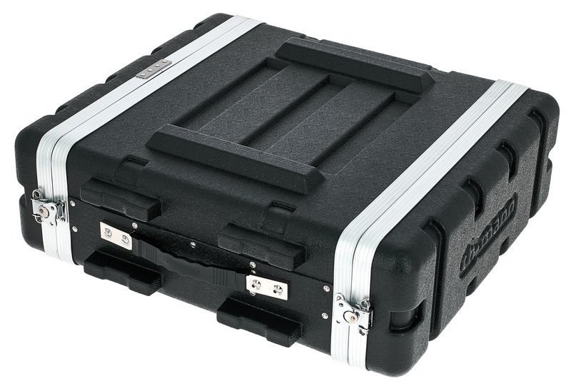

Then I stumble upon DJ Rack Flight Case as of Thomann Rack Case 3U https://www.thomann.de/intl/thomann_rack_case_3u.htm and found it will match my needs

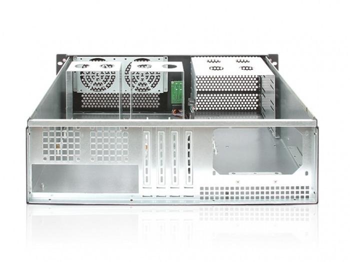

It is 420mm max deep so I'm looking for a short 3U case that can fit consumer components like SFX or ATX PSU, 120mm fans, up to 8x 3,5" drives and potentially 7 pcie bracket to put a vertical bracket for a GPU like Fractal Design Flex B-20.
I found RackPc Chassis D314 3u Short Rackmount Case USB3, but I wonder if there is other available options here as it lacks some extensions needed
Many thanks for your help !

Here's one from Monoprice.
It's short and takes standard PSUs; however, only 4 internal 3.5 HDDs.  The 2 5.25" bays can be converted to 3 x 3.5" HDDs with an adapter like this.
I do agree with Ramblinreck47 about transporting hard drives, but, that is up to you and your needs.
