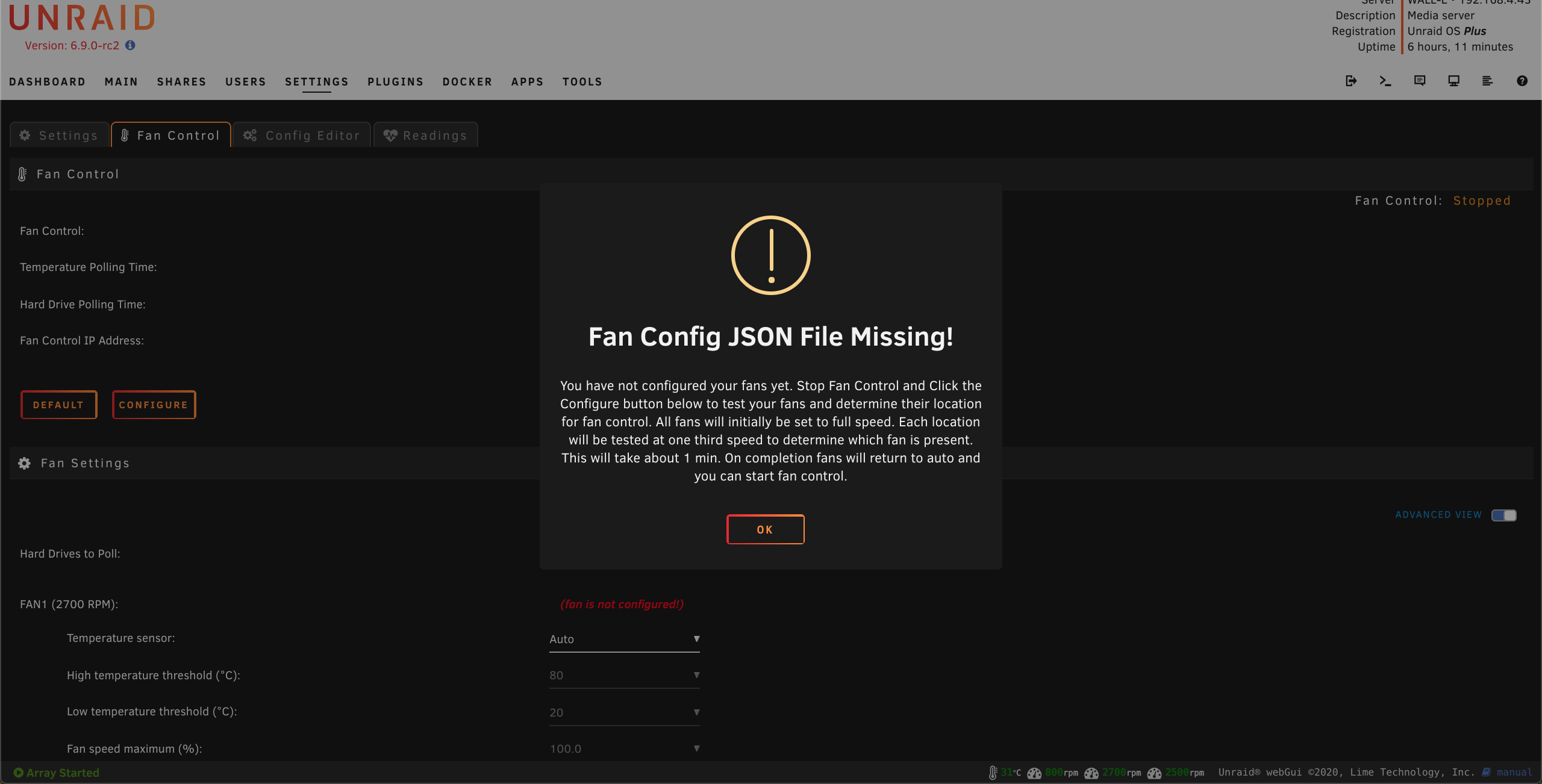

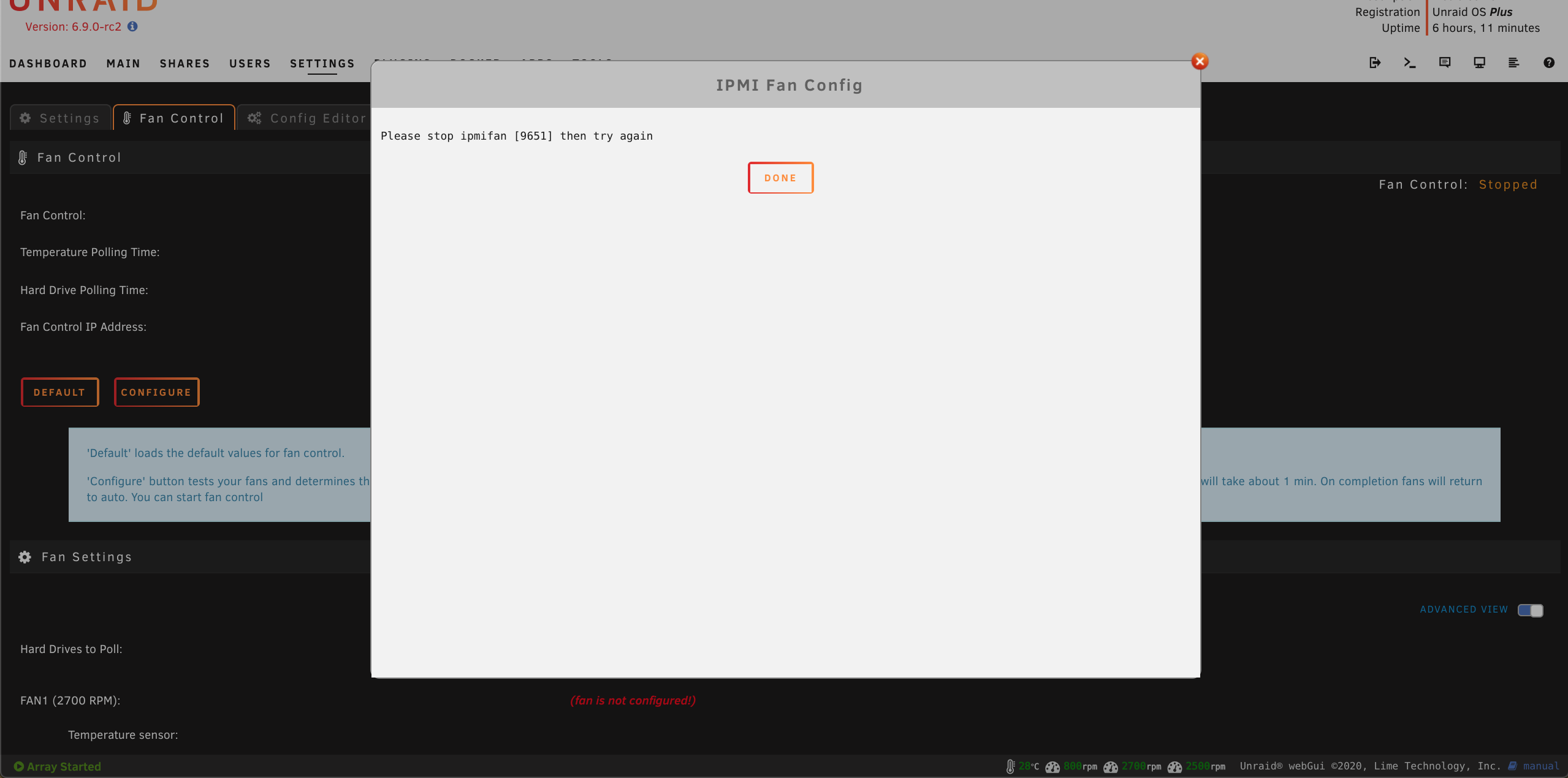

  12. I'm right there with you with the X570D4U-2L2T. At least we can create fan curves inside the BMC. As for the IPMI plugin, I can kind of follow what @cakes044 did but I can't even get a config file to show up. After clicking OK and then hitting CONFIGURE, I get this: With these two motherboards becoming more popular, hopefully it'll get some special attention.
  13. I believe you mean 1650 Super because the 1060 is an older Pascal era GPU.
