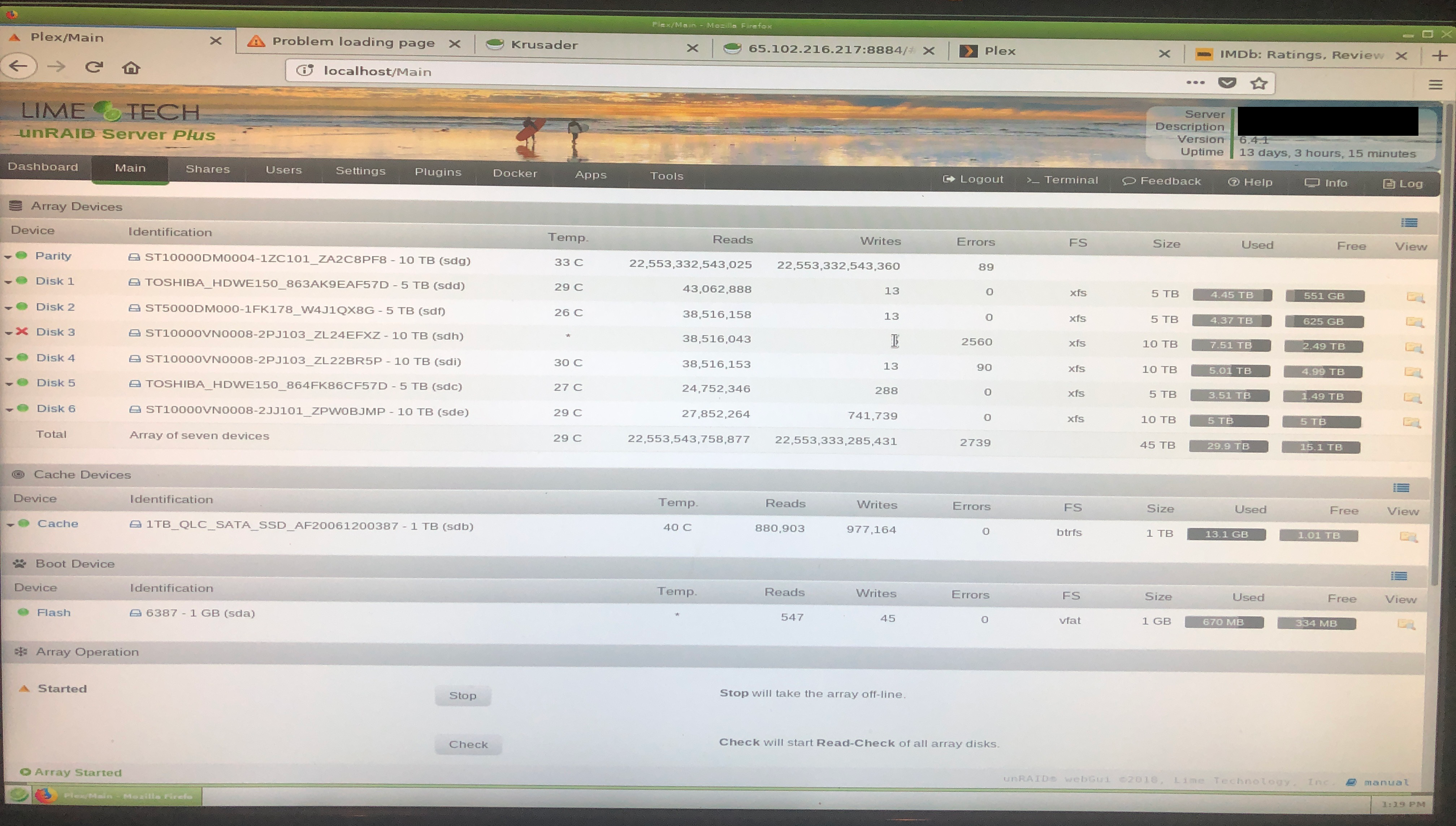

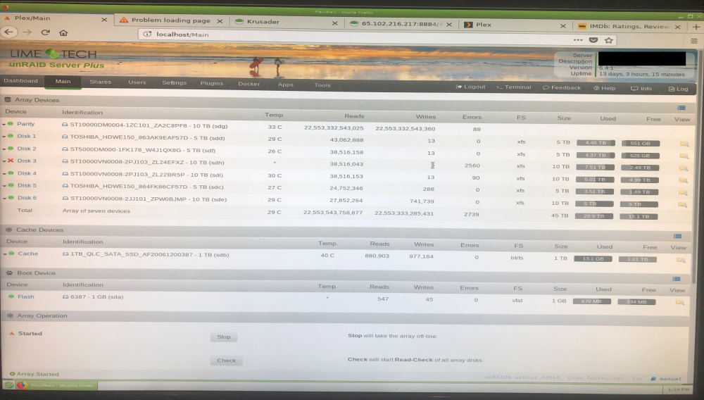

  2. I have a Parity drive that reads 22,533,332,543,025 Reads and 22,533,332,543,360 Writes (which is impossible because since booting it's only been 3hrs.) Note this has also happened within just a few minutes of me checking the server which is also impossible. See attached screenshots:
  3. Inevitably there are some drives with errors on them and it stops those drives automatically.

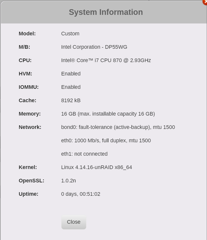

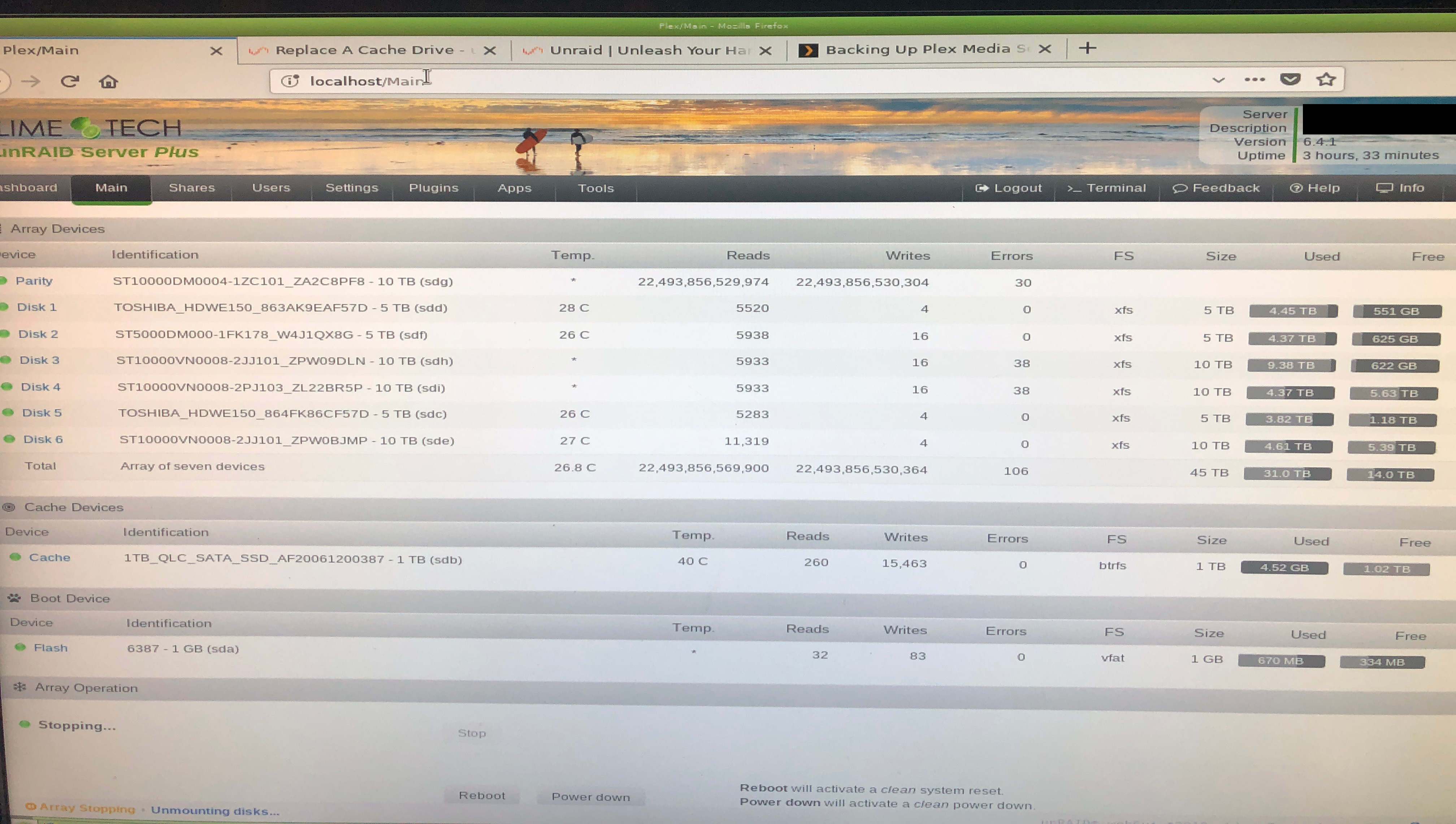

  4. Upgraded my OS and 3 drives failed to be recognized: Parity, Disk 3 and Disk 4, all three of my 10 TB Ironwolf Seagate drives.
  5. Restored Flash drive to previous state and old OS v 6.4.1 and now back to only one disk failed, others were recognized. Rebuilding Disk 4 now.
This is a symptom of a drive dropping offline, diags are after rebooting but you're using a Marvell controller and those are known to cause that and other problems, all 3 disks showing errors on the GUI are unsurprisingly connected to it.
