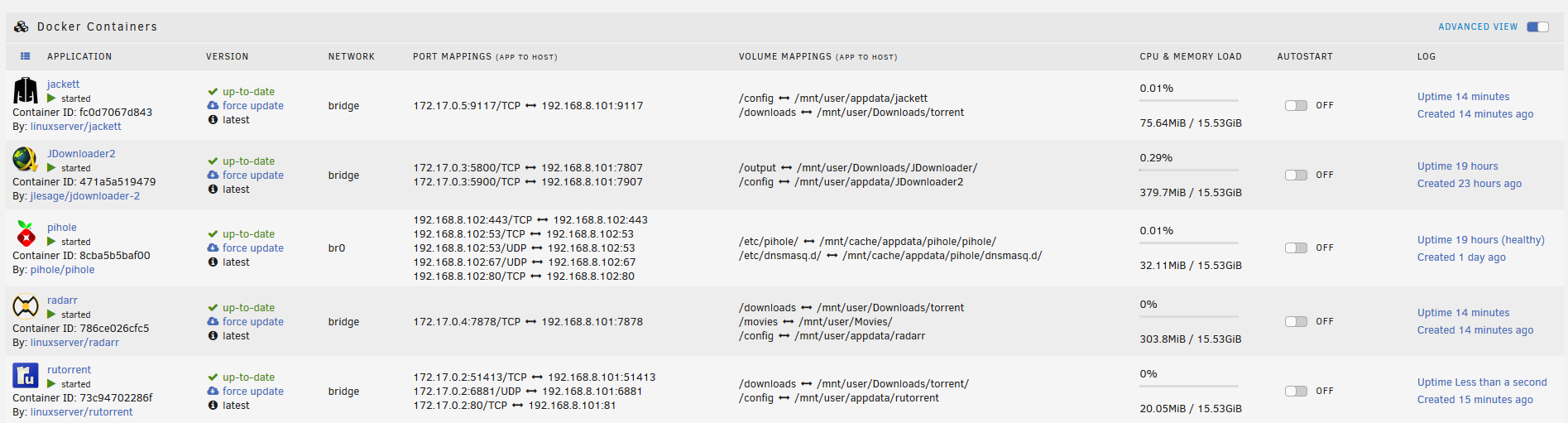

Also, go to the Docker page, move the slider at upper right from Basic to Advanced View, and post a screenshot.
thanks for your time and help. I attached the zip file and here is the screenshot:
The stopped qbittorrent client is now without the own created paths but still creates the folder in the share.

What I just found is that ruTorrent is creating the folder incoming so that is explainable to me. The rest was set up for qbittorrent and they are still being created.
This is now my current docker situation:
Could be that radarr or jackett are creating those folders. I don't worry to much about those folders now. I just wondered if I could clean it up somewhere.
