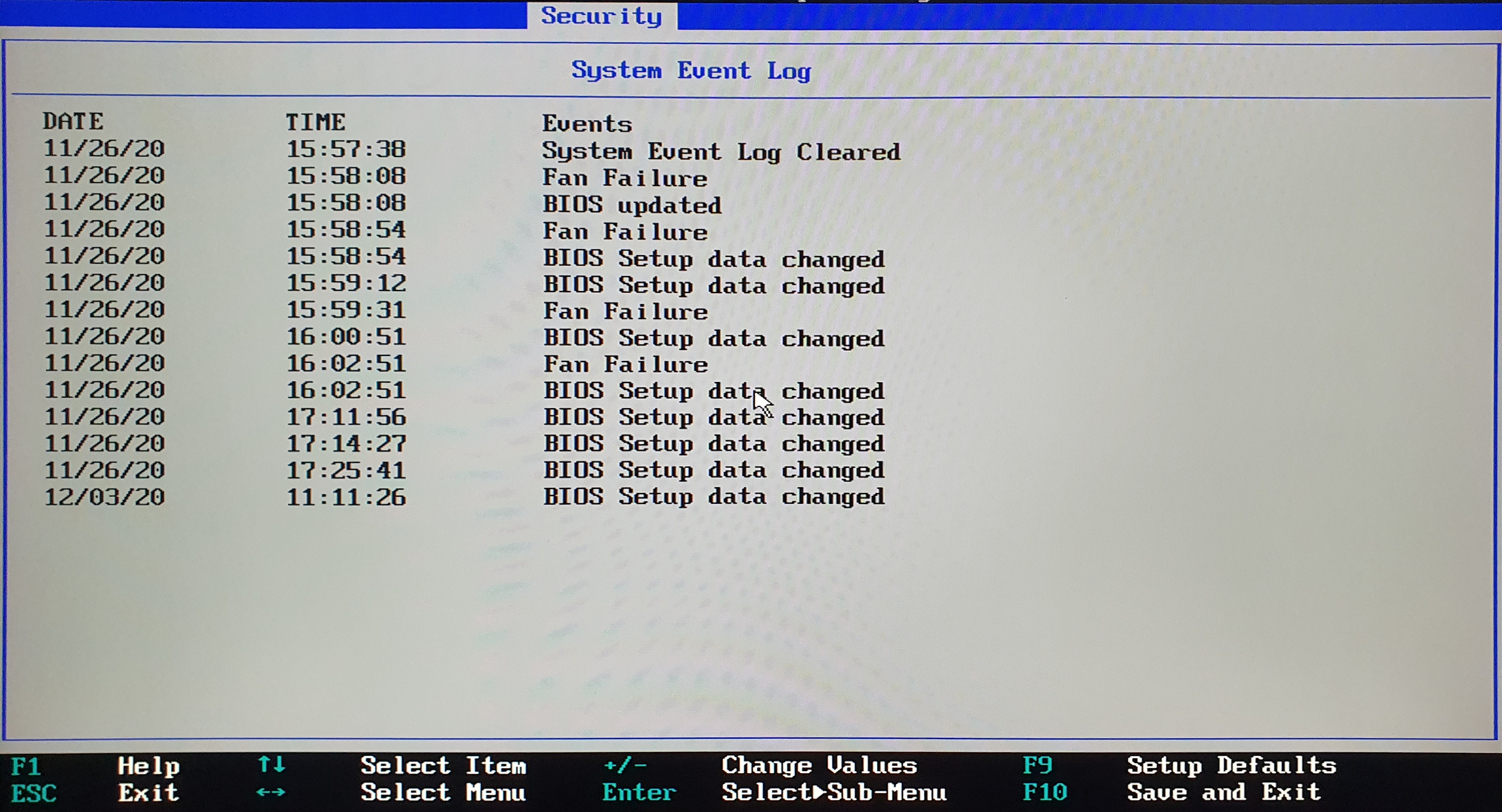

  2. Hi, I upgraded my Unraid server to Version: 6.12.2. Before the upgrade my server ran with no issues several months. Now after updating to Version: 6.12.2 I had three crashes within a week. Hardware: LENOVO ThinkServer TS140 Intel® Xeon® CPU E3-1225 v3 @ 3.20GHz 16 GiB DDR3 Single-bit ECC Samsung_SSD_860_EVO_500GB 2X WDC_WD101EMAZ Thanks for Squid, he suggested that I look at the bios system log and mirror the syslog to the flash. Also he mentioned that it could be normal behavior of the ECC memory. I don't know what to do in that particular case so I tried reseating the memory for the beginning. I attached the diagnostics, the syslog from the flash and a picture from the bios system logs. Thanks for any help. syslog_flash_mirror.txt ts140-diagnostics-20230713-2036.zip
  3. Thank you for the advice. I enabled syslog server mirror to flash and will create the thread. I will look into the event log in the bios but it didn't shut down. Server was still running but not interactable. But maybe the bios will have more info. Thank you so much.

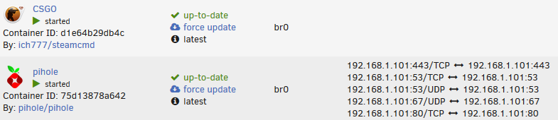

  7. Ah okay got it. Now I know what you mean. So right now, the steamAPI is picking up my Server with the Success Message I posted in my first Comment. So that would tell me that the port forwarding should be working without issues. But when trying to connect with my public ip and the port, I get the error messages mentioned. Okay I will try this and see if it works. Again thank you so much for your time and help.

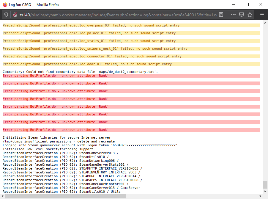

  8. Oh okay, that makes sense. I added the Server via the local IP and it is now showing in my favorites. Awesome, thanks. Wait so the reason why it is showing for pihole is because those ports are exposed? What about the Port 27015 for the CSGO container? But how should my friends join the server if there is no public IP? Like it is so weird that the Steam API is returning a success message with the right IP and the Server showing. When they try to connect they only get the Message "Retrying public(XX.XXX.XX.XX:27015) ..." Besides Portforwarding, do I need to check something else? Thanks a lot for your help.
