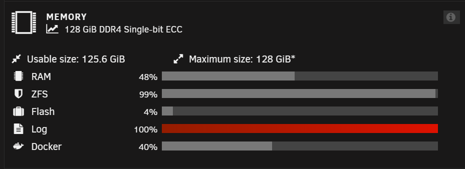

That said, on 6.12.1 I do have this log issue that nobody answered about in the 6.12.1 thread.  Will 6.12.2 address this?
All that said, I guess I'm leaning towards upgrading to the downgraded docker.  Until a couple weeks ago I only had 64GB of RAM and it was usually only using 60% or so unless I was doing intense things.  Now I'm using 64GB at steady state without extra activities.
The log filling up is abnormal behaviour.  Have you looked in the /var/log folder to see what is taking up too much space?   If it is the syslog file then you should look at the contents of that file to see if you have some sort of error message being continually repeated?  Without knowing the answer to those questions nobody is going to be able to know if the update might have addressed your issue.

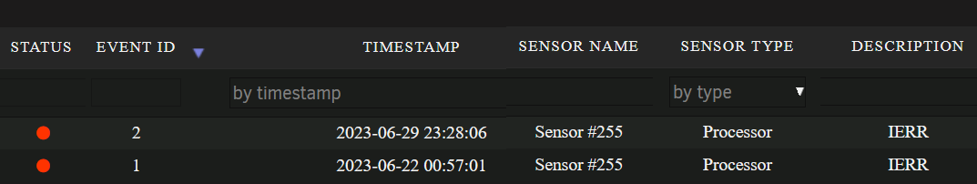

Well I just went from 6.12.1 to 6.12.2 and my server crashed again just like when I went from 6.12.0 to 6.12.1.  Exact same thing:
I now have a new IPMI event that matches:
These two past upgrades are literally the only time this server has ever crashed.
After going to 6.12.2 I'm back to this:
I guess I will have to wait to see if anything explodes in size in /var/log because right now there is nothing abnormal and no error messages.
I think it might have been the FIle Activity addon log.  The log bar graph was getting higher as I sat here again.  I disabled File Activity and deleted its log and now it seems normal again.  Has something changed with unRAID 12 that may have made that plugin incompatible?  Because I've had it set the same way for a very long time.
ipmifan fan is also getting perpetually larger, but at a much slower rate.
