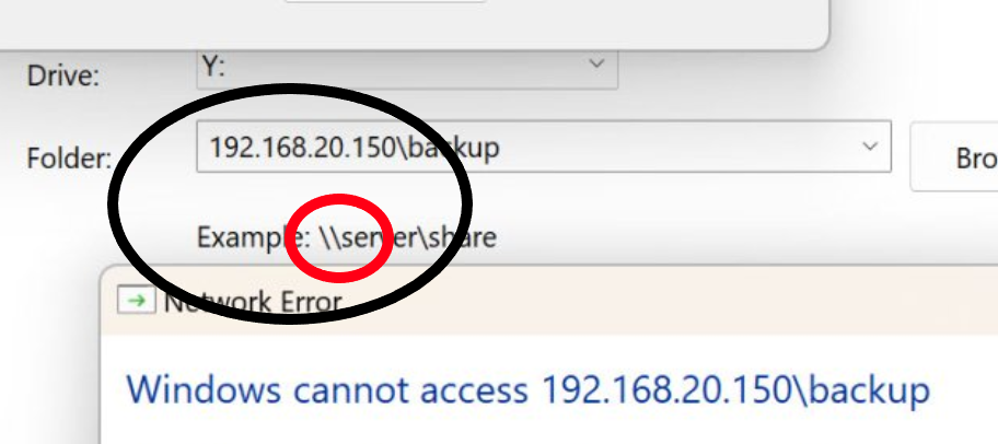

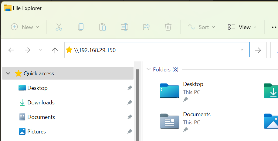

Try typing this n Windows Explorer:
\\192.168.20.150
Press enter.  Windows should prompt you for credentials.  Navigate to "backup" or whatever.  Right click and select "map network drive."
All that said, I think you may just be missing the "\\" backslashes.
Edited by craigr
I don't think you have the two backslashes?

But did you check if your network share is connected correctly, with "\\" at the beginning of your folder?
