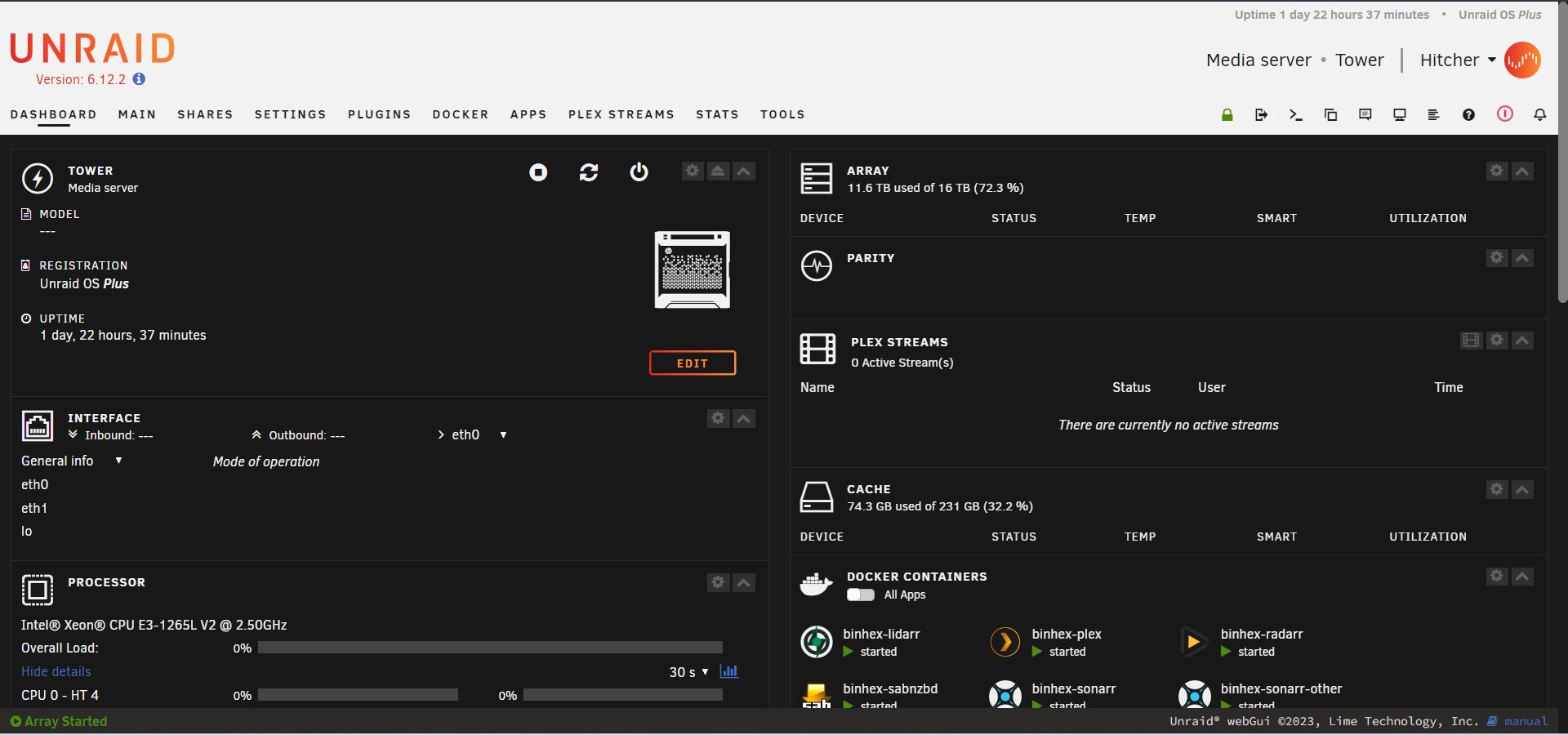

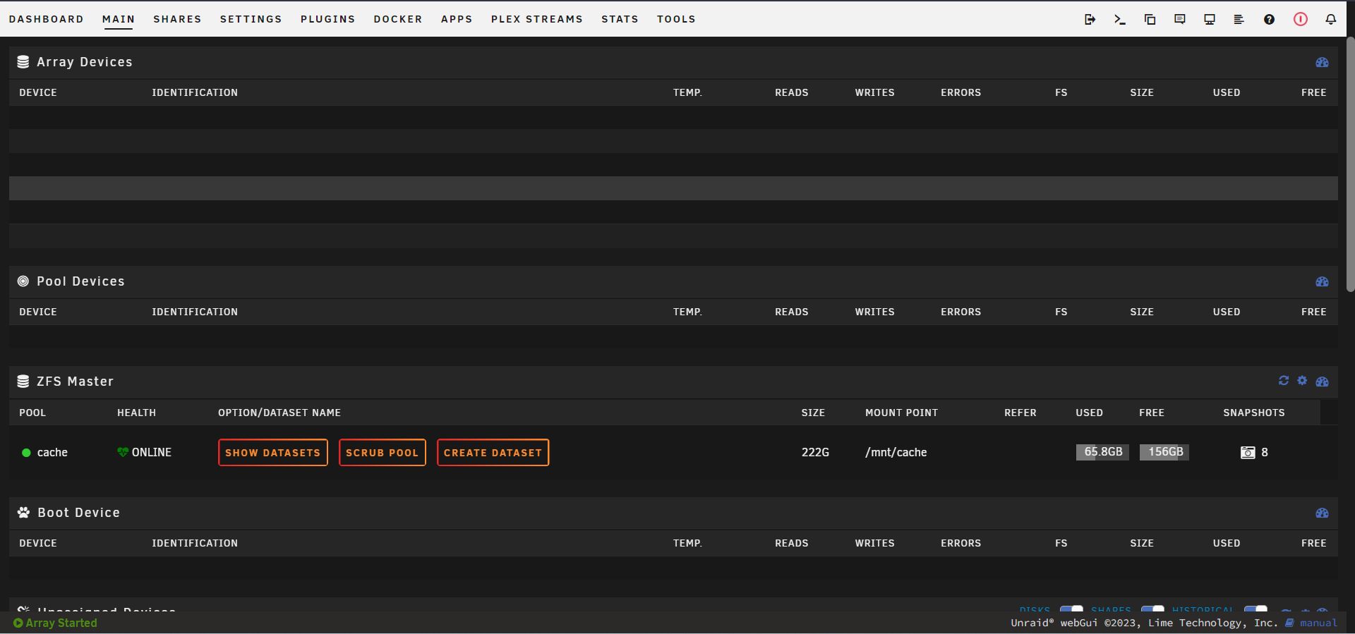

Since this update the webgui will work for a day or so but then it stops displaying the drives in NAS and doesn't have any info for the CPU, GPU, interface, system, etc. Only a reboot brings them back. All my dockers work and the System Stats app shows this info.
