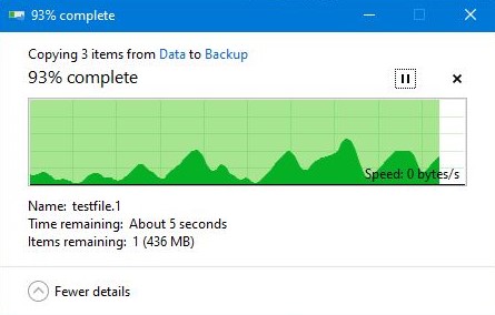

  25. PC running Windows 10 Pro 22H2 Here is an example of a 7.02 GB transfer of 3 files:
