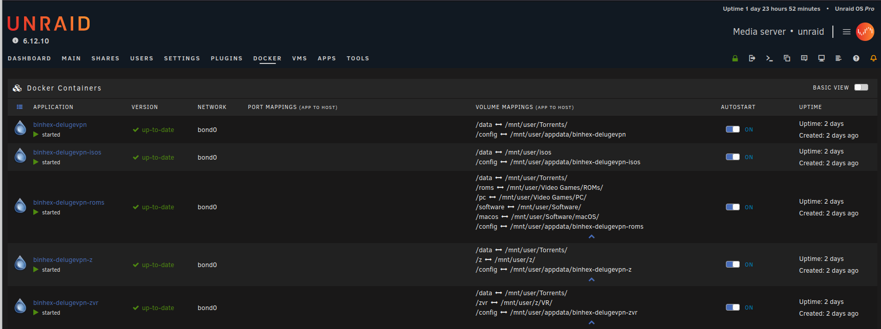

  5. For some reason since the latest container update, it no longer shows any port mappings in the Unraid Docker UI. This also seems to result in the WebUI shortcut button to not do anything. This is the only container that has this behavior, and I have 5 separate instances of it, other containers that have updated recently are fine. I don't see any errors in the logs though, the Deluge web UI starts successfully, I can use the web UI by manually going to its address, and everything else works as expected. It's online, connected to my paid Proton VPN, can ping out, actively downloading/uploading. Unraid 6.12.10. Tried flushing browser cache, restarting the container, restarting Unraid itself, same behavior.
