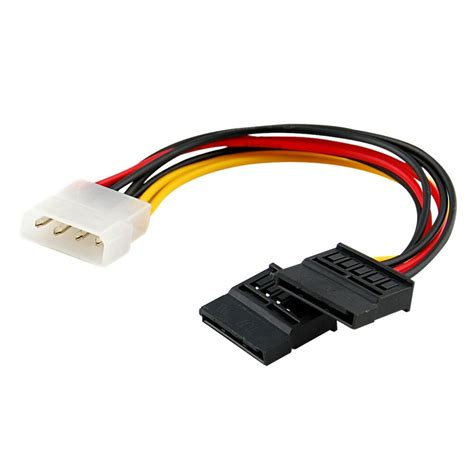

Begin by sourcing a quality 4 pin molex to SATA power adapter.
Be SURE that the SATA end has crimp connections, no one piece molded where the wires just disappear into black goo, you should be able to see the wires connect to shiny metal in separate slots.
Using only that piece plugged into a single hard drive, see if the drive spins up. Don't connect SATA data wire, just give the drive +5, +12 and ground and see which drives spin up.
Once you have an update with that test, post back with results.
