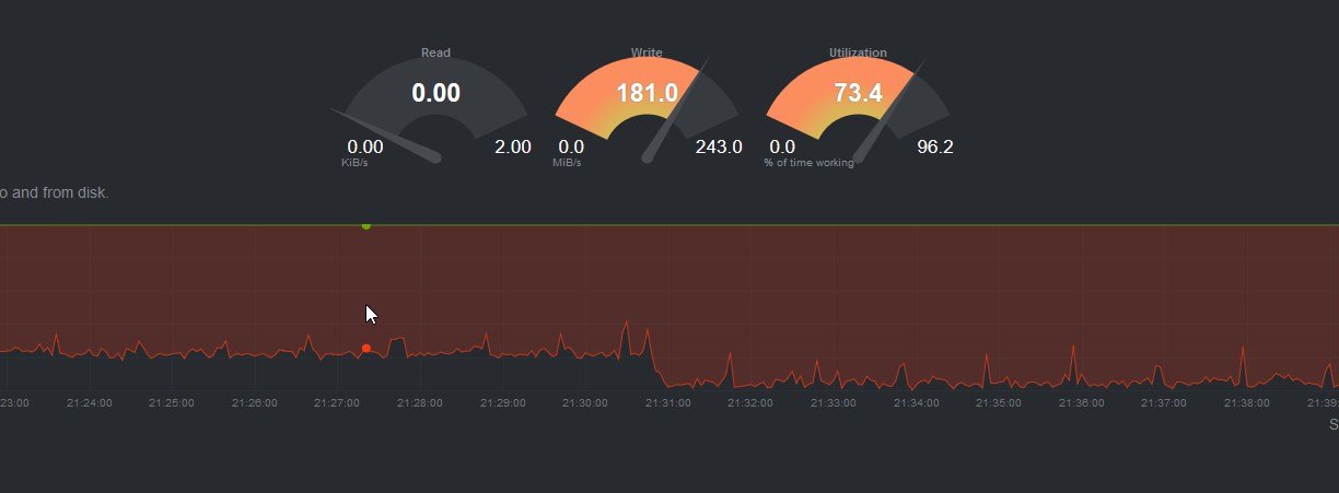

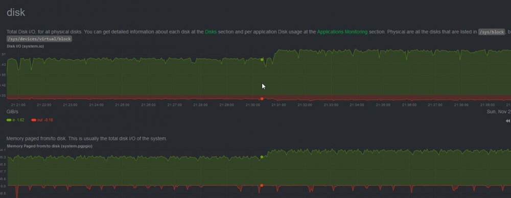

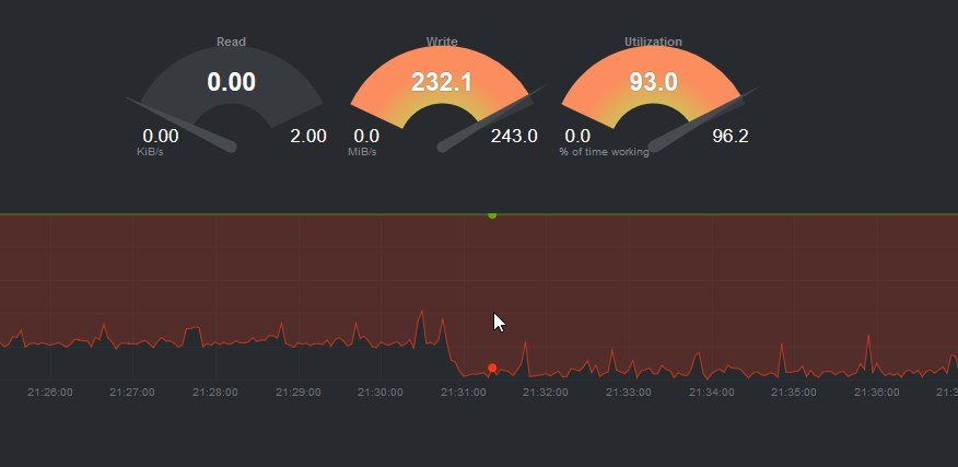

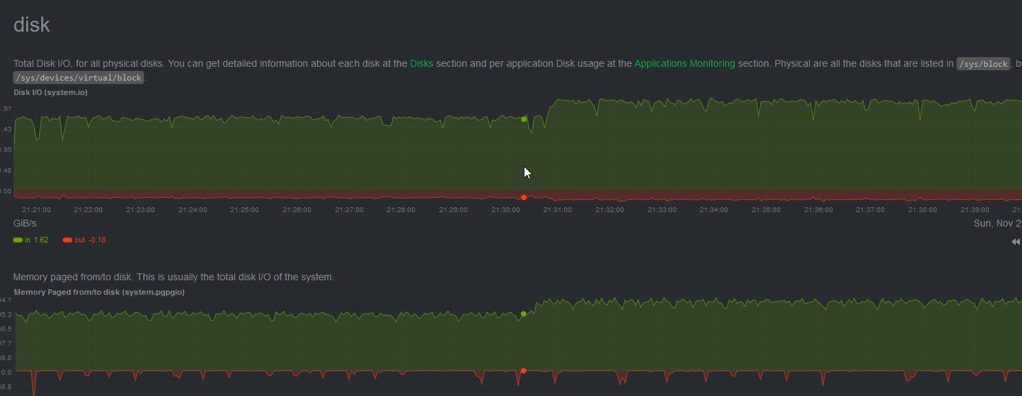

Some pictures of the speed change:
Combines speed change of all drives
Before smart test single drive speeds
After Smart test single drive speed
