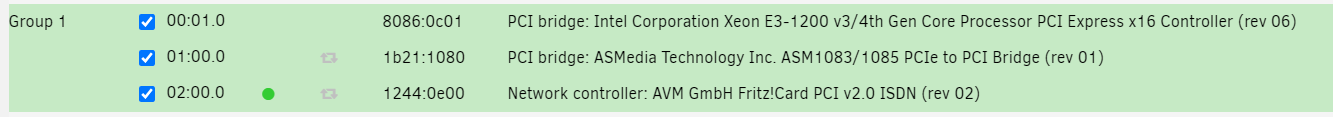

I have a AVM GmbH Fritz!Card PCI v2.0 ISDN and I want to passthrough the card to Windows but I got a error.
I googled this error but don't find a solution. Hopefully you can help me.
"Failed to set up TRIGGER eventfd signaling for interrupt INTX-0: VFIO_DEVICE_SET_IRQS failure: Device or resource busy"
I tried different PCIe ACS override settings but no change.
VMS Error attached.
VMS_error.txt

There's a third party (asmedia) PCIe to PCI bridge listed in your first post. So the device is actually a legacy PCI device with a converter chip basically. Not a lot of people try to run legacy PCI stuff but it does work sometimes at least.
