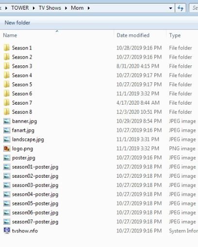

Ah, wait.  I see what's happening, I think.  I was going to move some stuff off Disk9 and onto Disk11 manually when I saw a TV show folder that only contained banner.jpg, landscape.jpg and logo.jpg.
Looking further, it appears as though those files hold the artwork for the seasons and are stored in what would be a level that can be split.
For example
-TV Shows
---Mom
------Season 1
--------------S01E01
--------------S01E02
So in that example, it would be possible for the three .jpg files to exist on a disk by themselves?
Yes as the ‘Mom’ folder is allowed to exist on multiple drives at Split Level 2 so files directly under that can exist on any drive.
