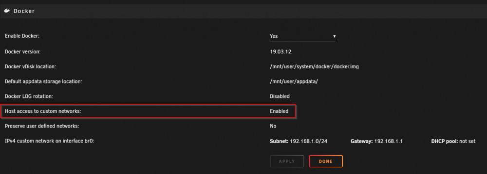

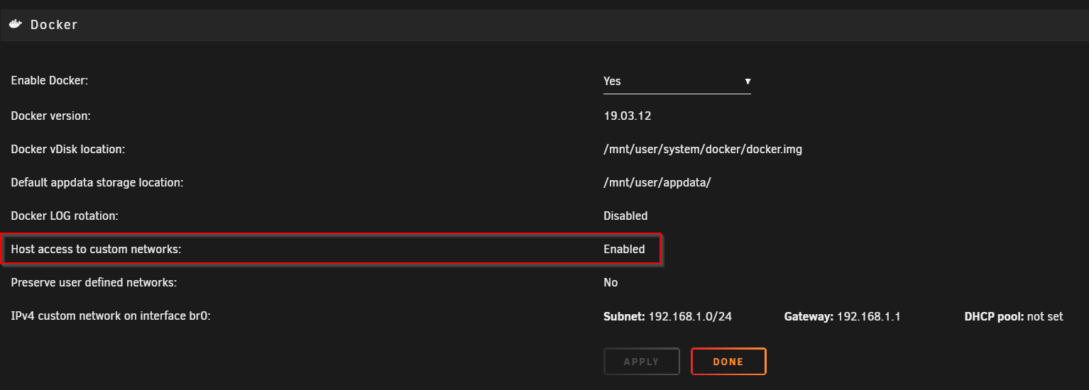

Been scratching my head all afternoon on this one, but I think I finally narrowed it down. What I found is that when you have "Host access to custom networks" enabled in the Docker options, it's fudging the MAC address of the Unraid server as a whole.

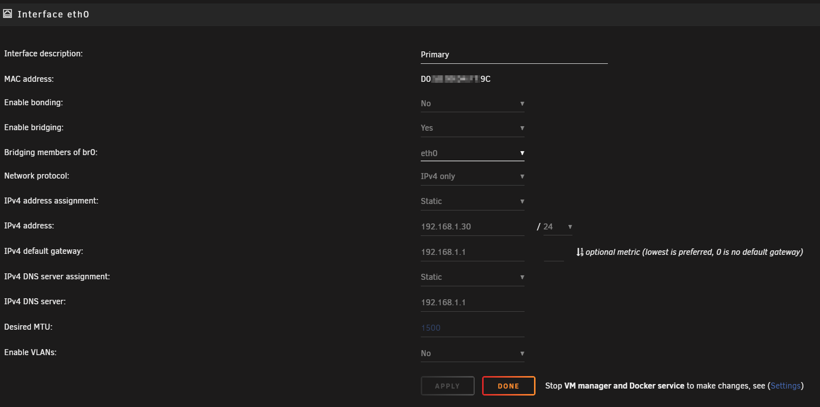

The actual MAC of my adapter begins with D0 and ends with 9C:

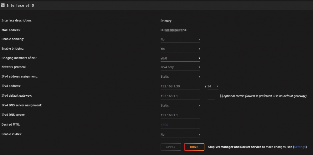

So when I went into pfsense, I was ready to tag D0..9C, but didn't see it. So I checked the ARP table, and low and behold I saw a MAC of 36...52:

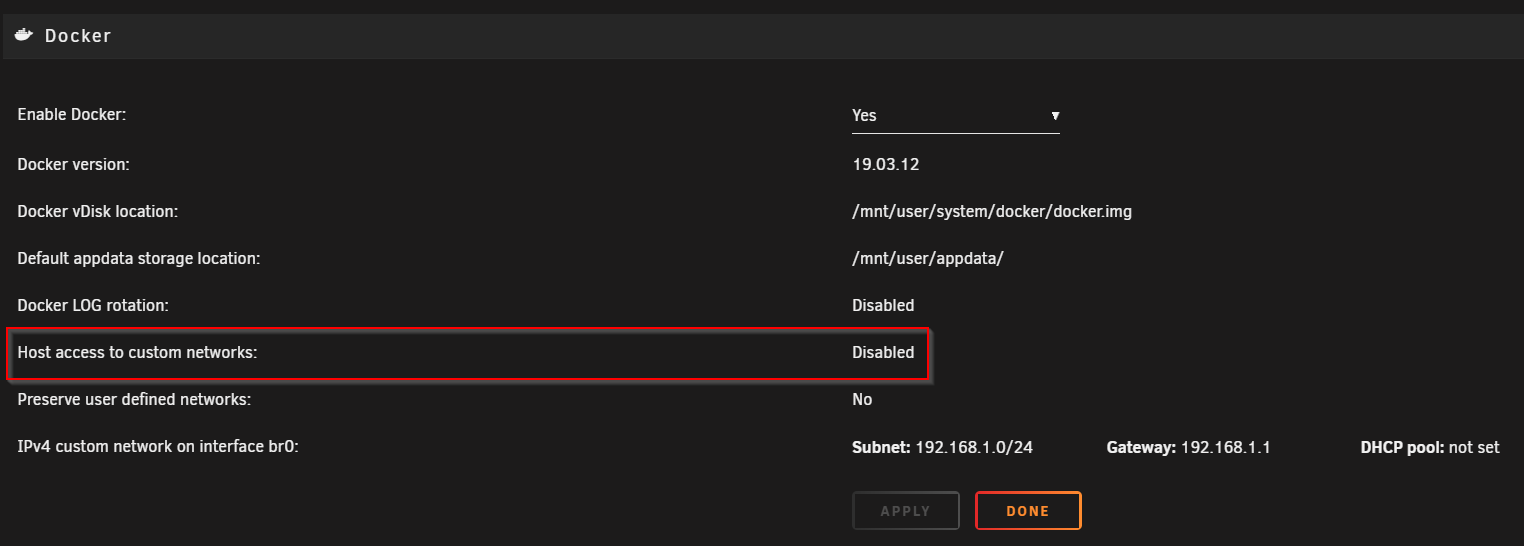

If I disable "Host access to custom networks", then the real MAC comes back:
