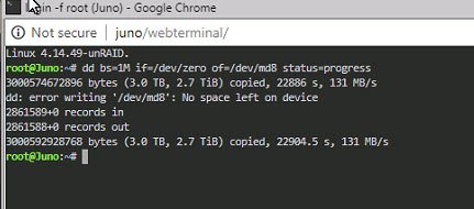

Gico Posted July 10, 2018 Author Share Posted July 10, 2018 Running this command standalone made quite a difference. It started at 160 MB/s, and ended at 131 MB/s. However I saw this morning it had an error, and I don't know what that means in regard with the array parity. How to proceed? As planned + parity check? Link to comment
pwm Posted July 10, 2018 Share Posted July 10, 2018 1 hour ago, Gico said: However I saw this morning it had an error, and I don't know what that means in regard with the array parity. What error did you get? Or did you mean the "No space left on device" error? dd isn't given a request to write a specific amount of information - it's ordered to keep writing until it fails because it reaches the end of the disk. So the "No space left on device" message isn't a real error but an expected message. Link to comment
Gico Posted July 10, 2018 Author Share Posted July 10, 2018 Yes, I meant "No space left on device". OK thanks. Started the array with new config, Disk 8 unassigned, and began a parity check. So far looks good. Link to comment
