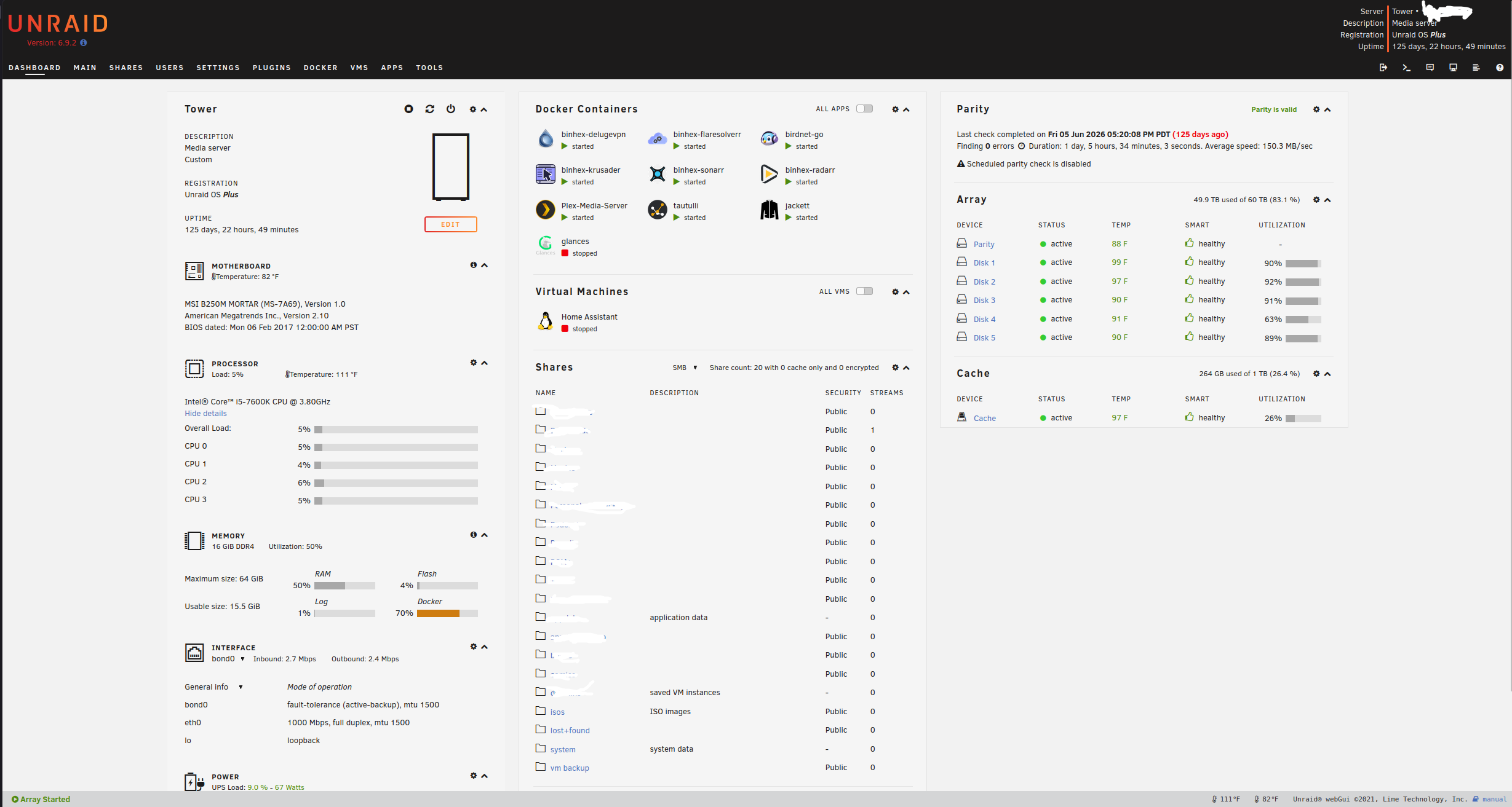

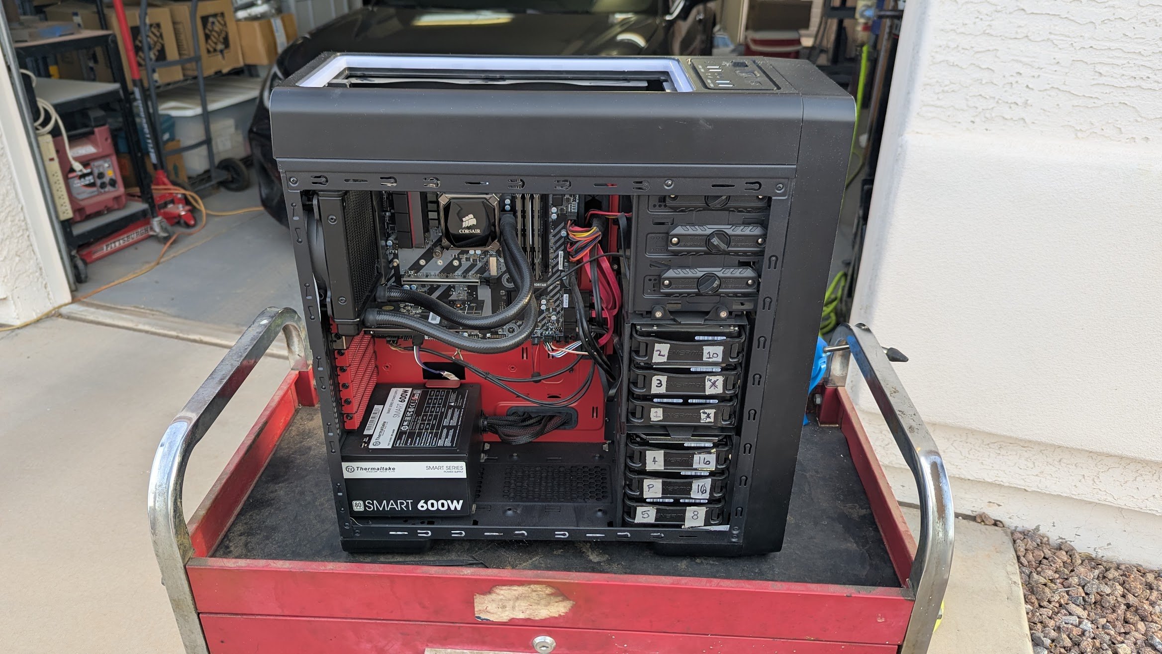

  1. I had issues with an upgrade and the problem was solved here. https://forums.unraid.net/topic/198248-very-slow-rebuild-after-swapping-in-new-drive/ I put in a new power supply and this fixed the issue. I started the sync a few nights ago and walked away from it until right now. The sync was completed but now the new drive and another drive shows as unmountable. I don't know what I need to do to try and fix this without data loss. The array appears to be running normally still. I have attached smart reports and diagnostics. Thank you. tower-diagnostics-20260415-0412.zip tower-smart-20260415-0415.zip tower-smart-20260415-0418.zip
  2. I haven't done this yet, I am manually backing up some data because I feel like I have lost control of the repair and I want to make sure I have the family stuff in a second place. I have determined that it is not the drive, sata cable, or power. I tried doing a rebuild with a powered USB enclosure and the drive did the same thing. I tried a sata port not on the motherboard. I also tried with a different untested 16tb drive. It does the same thing. The drive ran a full pre-scan without making a sound, but as soon as I start the rebuild I can hear a different drive in the case start clicking like it is bad and the transfer goes from 250mb down to below 1mb. I have the array up now everything runs fine? Does anything else in the diagnostics fit with what I am describing? tower-diagnostics-20260412-1917.zip
  3. I have tried several different SATA cables and power sources and had about 10 minutes of full speed transfer and then it started doing the same thing again. After the last reboot unraid can no longer find the device. I tried just returning to the old 8tb device but I am getting an error. Stopped. Replacement disk is too small. How can I return to the old drive until I figure out the new drives actual issue?
  4. I removed an old 8TB Red today and put in a new 16TB Red. On first reboot I had two additional drives show up as missing. Powered back down and re-seated all sata cables and had a successful boot. I started the re-sync and am only getting 300kbps. I am attaching a before and after diagnostics. I paused the rebuild and ran a smart report on the new drive as well. Drive was fine with normal pre-clear so I am not sure what the problem is. Any help would be appreciated as a 500 day rebuild is not going to work. tower-diagnostics-20260412-0908.zip tower-smart-20260412-0859.zip tower-diagnostics-20260412-0609.zip
