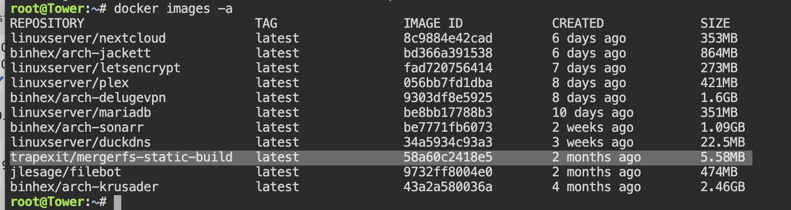

  1. Oh man that sucks, so every time i restart Unraid I need to remove plex and deluge (cuz they use mergerfs folder) then install them/configure them again? Edit: Did you mean remove this? Edit2: Ayy it worked! Thanks man!

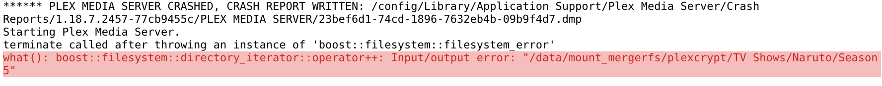

  2. Hi I got this error after restarting the Unraid Server, and plex does this then crashes. I can verify that the mount is mounted, I was able to access the rclone mount by connecting to the server through my local network.
