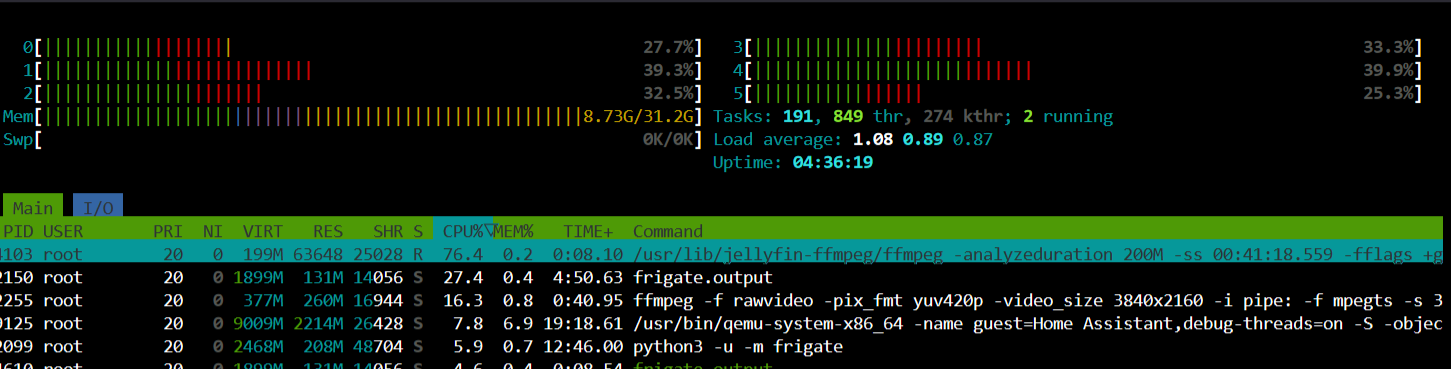

  1. Not really unfortunately If I run multiple 4k transcodes locally or on my alternative server NPM, htop also reports between that 30-50%. Here is a screen-grab of the moment it crashed when hosting NPM via unraid's docker service, low CPU usage:
