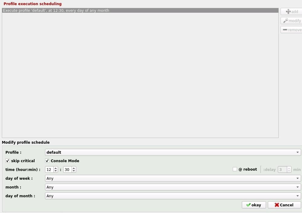

Yes checked manually, all ok Recreated container and made adjustments following container setup attached Time is same in container as system Thanks re cron it will make sure to that, have recreated new profile and cron it . Set new time, time passed and backup did not start. Log files are empty one question I follow the setup in https://unraid.net/blog/unraid-server-backups-with-luckybackup but I notice you say to use use /luckybackup/.ssh/id_rsa are the instructions wrong and I should use use /luckybackup/.ssh/id_rsa ? Although it does run manually so remote connection is ok ? Appreciate the assistance

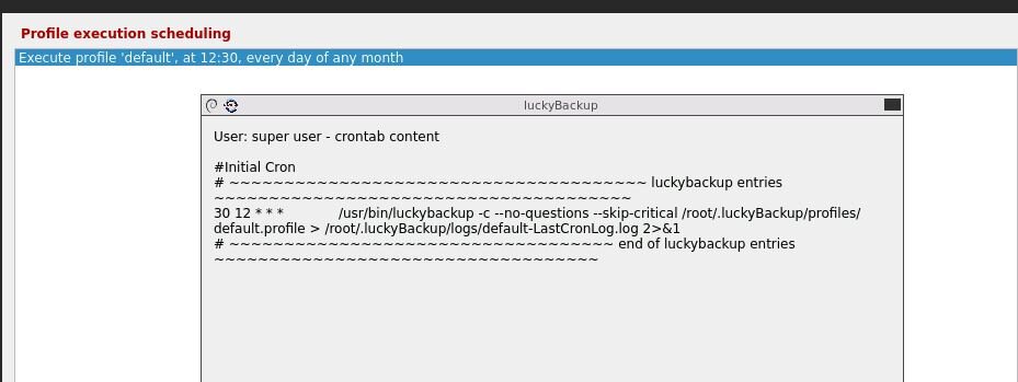

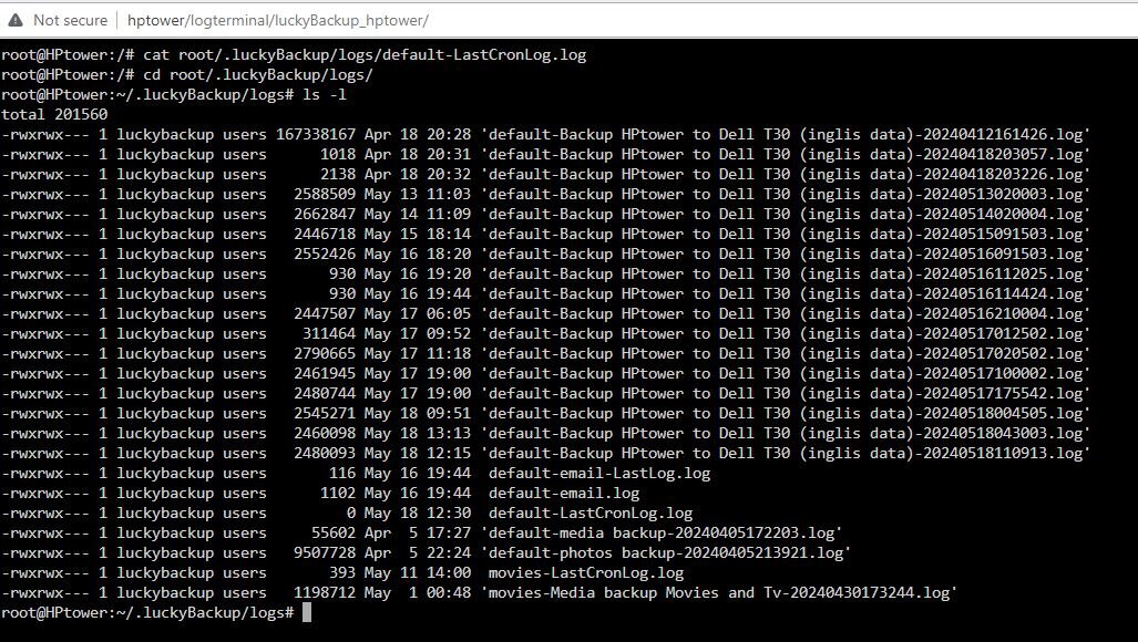

Thanks, Restarted Lucky, Checked log and it is empty ? Note: running on UnRaid as a Docker. -rwxrwx--- 1 luckybackup users 0 May 18 12:30 default-LastCronLog.log What to try next ?

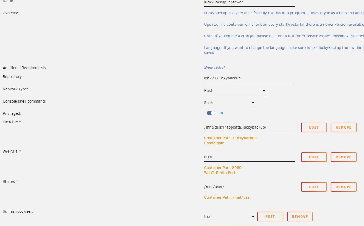

Using Luckybackup very good Docker but the scheduling is confusing me. All works perfectly manually but will not run as a cron job as per schedule. I'm sure I've missed something simple so any help appreciated. Below is container setup, backup setup, crontab and schedule. Where have I gone wrong

Did you ever get the schedule to work ? Manual works fine but I'm having similar problems with scheduler and going in circles trying to work out why it won't work. My schedule is as follows: And My docker setup as well: Any pointers appreciated.

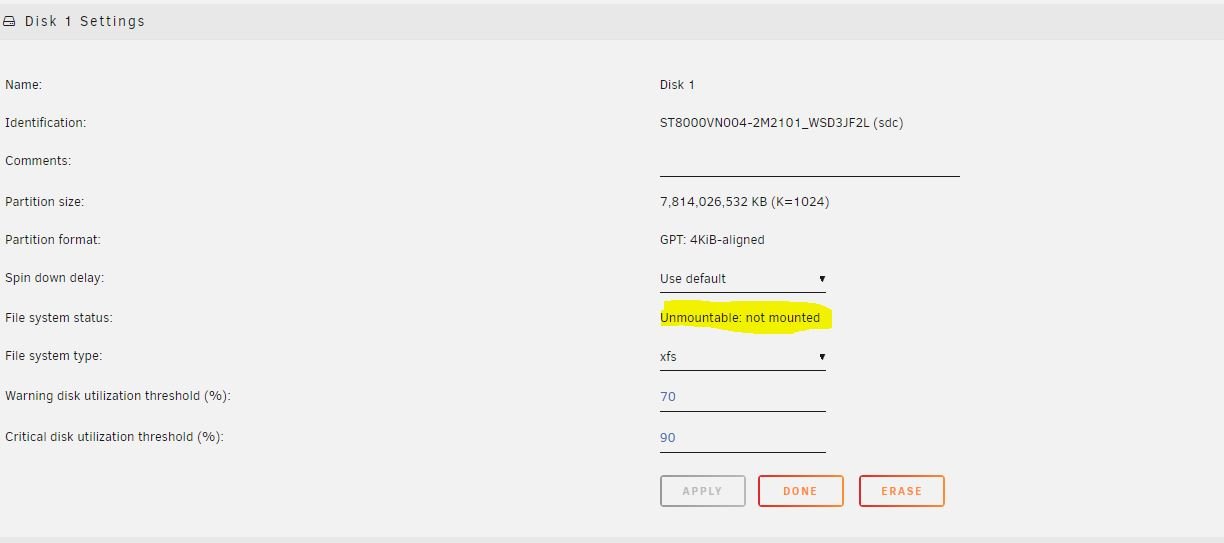

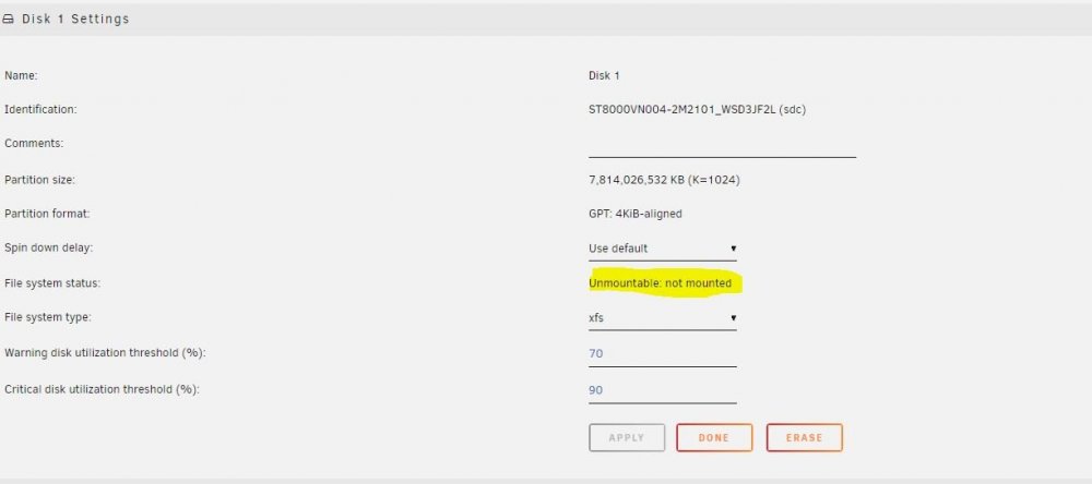

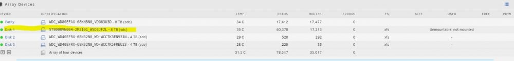

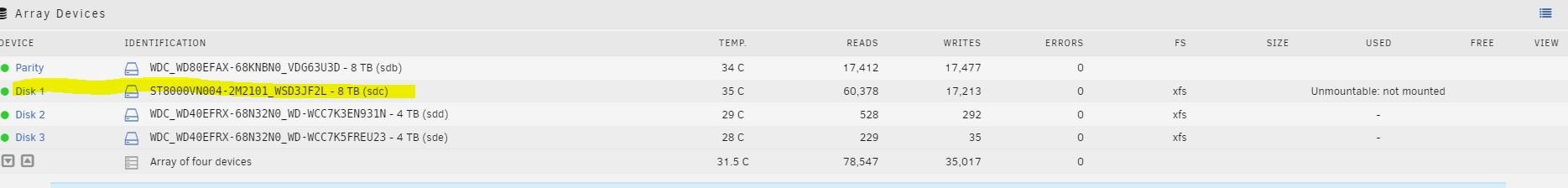

Yes its jammed in the cage and cant be removed screw must have moved yes is disk 1 is green but showing as unmountable , mounting existing drive will be hard as cage damaged. Will see if can cut drive out of cage any other options or do pictures attached if any help

yes original disk is jammed in disk cage hence swapped to new cage and put new disk in as disk 1 (sdc) Are errors recoverable ?
