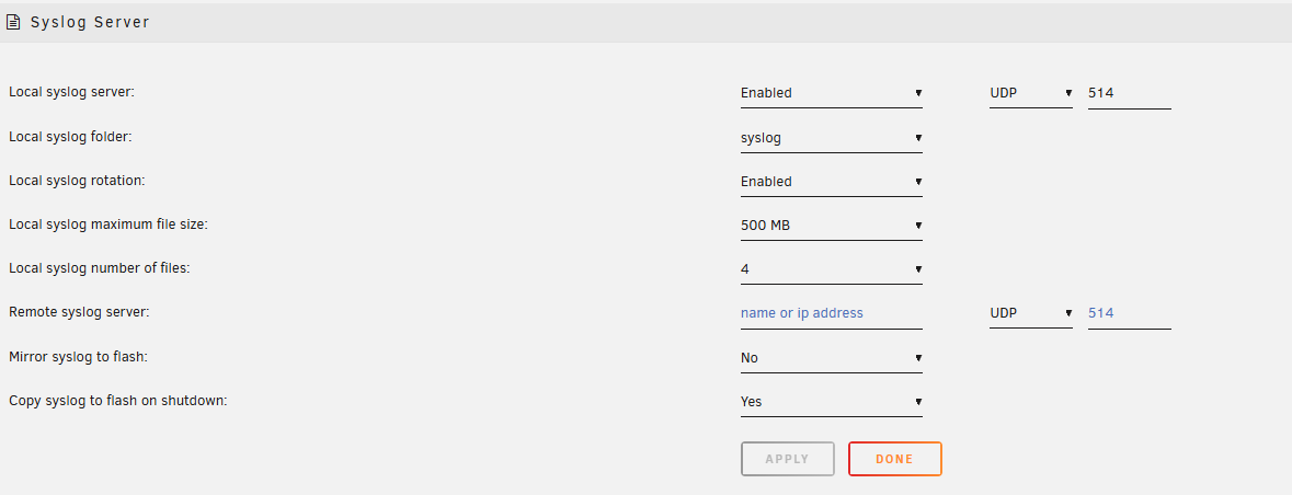

  1. I haven't let it run for an extended period of time like that so not sure. I watched Plex last night with no issues. It crashed some time after. Rebooted tonight when I realized. Watched Plex again tonight with no issues. That's the cycle.
  2. Yes. It worked on the latest crash from last night. @trurl @itimpi syslog-192.168.1.202.zip
  3. It didn't log anything to the share
  4. latest crash was last night r510-diagnostics-20260329-1159.zip
  5. And here are the latest logs with it enabled. still crashing. r510-diagnostics-20260323-1821.zip
  6. Sorry been busy.
  7. Gonna start of by saying I don't know linux. I'm not sure how to troubleshoot this so I figured I'd ask here. I've been using unraid for about 8 years with minimal issues. The issues I have had I could work out - usually docker img filling up or logs spamming the cache kinda stuff. Over the last month I've been having multiple crashes per week. I THINK it's crashing overnight, but I'm not 100% sure. I used it last night and this evening the server is down. That's the typical pattern. Attaching logs for the people smarter than me. These logs did not have Persistent Logging enabled. It is now enabled if this isn't enough to detect the issue r510-diagnostics-20260318-1930.zip
