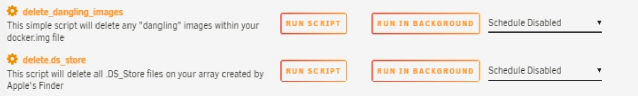

May 21, 20242 yr Community Expert I use user script to update sometimes. docker images | grep -v ^REPO | sed 's/ \+/:/g' | cut -d: -f1,2 | xargs -L1 docker pull I also use ca auto update tool to assist. Do you have nay orphan images? click advance and scroll to the bottom. you should not have any orphan images. --You may need to run docker prune to clear and clean the docker system.. look in to docker prune system all <dangerous command but will delete non-running stuff sometimes the logs get filled with docker img and the log kills the abilty to update the dockers on unraid. settings > docker > image size increase it. ^sometimes you have to delete that image file as docker that don't have a dat path will fill it up with temp data within the image. You can delete the disk image. (this will delete the temp data and all dockers in the docker tab...) <This is not data loss! [unless you have misconfigured dockers and important data in the temp file.] make a new one click add container and select the docker you were running to re add them back to unraid. (a re-added will downloaded the lattest image. install user script plugin and run some default scripts that came with it:
