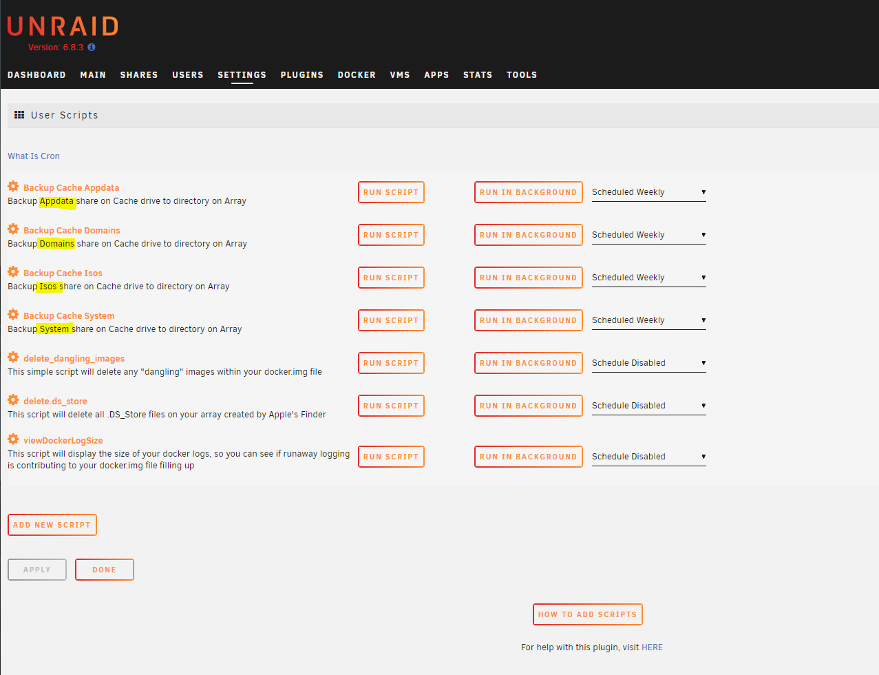

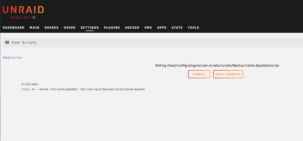

^ Thank you! Tried user scripts and it seems awesome way to automate stuff around unraid. Really easy to make new script, copy-paste you command and set schedule when to run the script. Made these four separate scripts for four shares on my Cache drive, so I can schedule them differently if I want: Example how my Appdata backup script looks:

I took some time yesterday to try rsync/crontab method. Managed easily to make a script with rsync that creates the copy of cache on array, but didnt manage yet to automate the script with crontab. I'll repost when I get the automation working. Rsync and Crontab both come preinstalled on unraid, so its just matter of writing the commands in correct files to be run daily/weekly/whatever. my rsync command which works fine when run in terminal: rsync -r -av --delete /mnt/cache/domains/ /mnt/user/vault/Backups/Unraid/Cache/domains -r = recursive -a = archive files and directory while synchronizing -v = verbose --delete = delete files from destination, that are no longer found in source (good for my use case, not for most backups) /mnt/cache/domains/ = source /mnt/user/vault/Backups/Unraid/Cache/domains = destination

I also would like to create daily backup of the shares on cache disk (appdata, domains, isos, system) and store the backup on array. This would be enough safety for me to run single cache disk instead of 2 disk pool. I think setting up rsync script with cronjob would be one option, but I'm not sure how to do this. Another possible way might be installing DirSyncPro docker, but I'm not familiar with this either. Both options sound really complicated for such a simple job. I'm sure this is trivial job for more experienced linux/unraid users, so please share what is the best way?

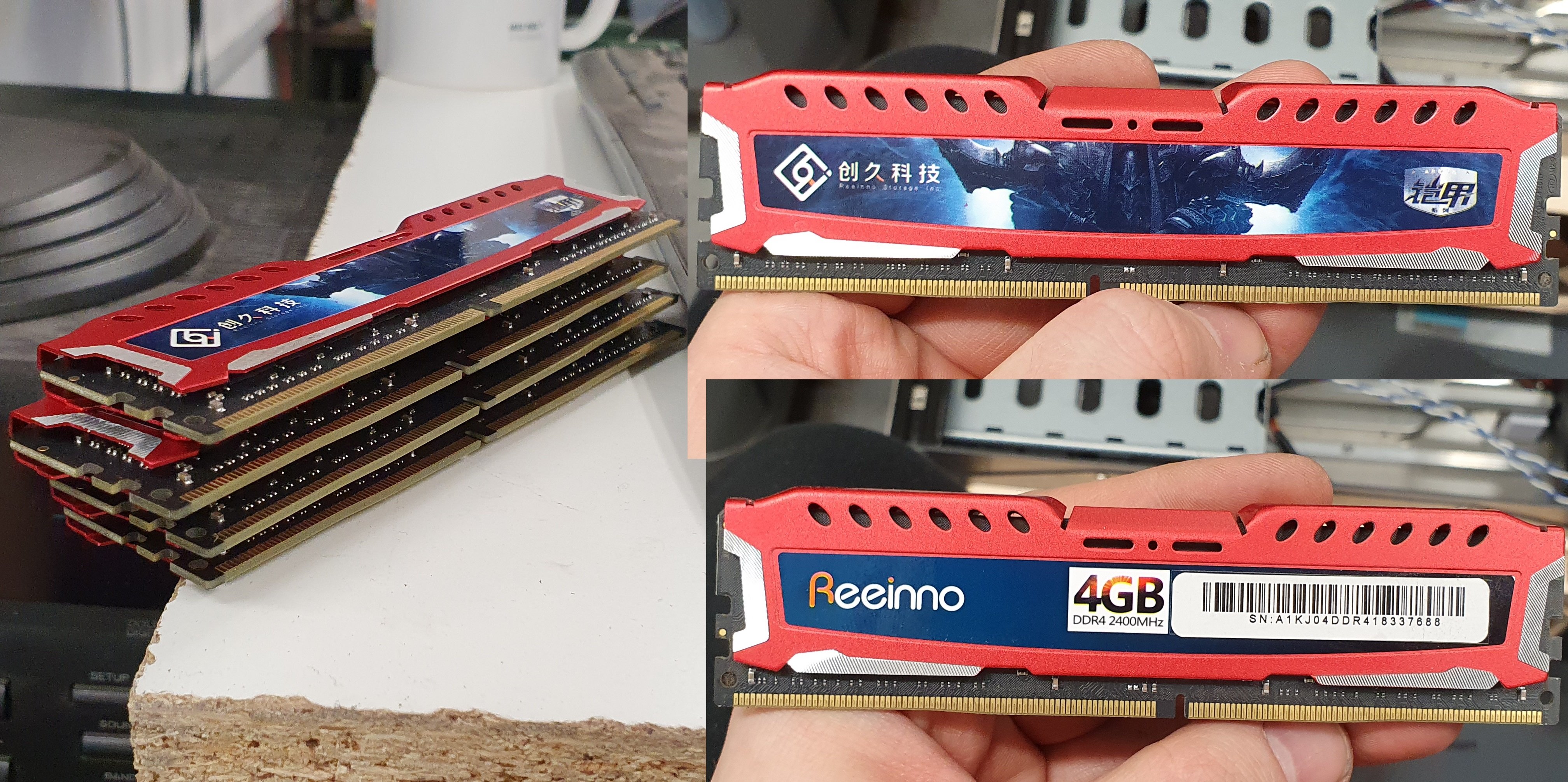

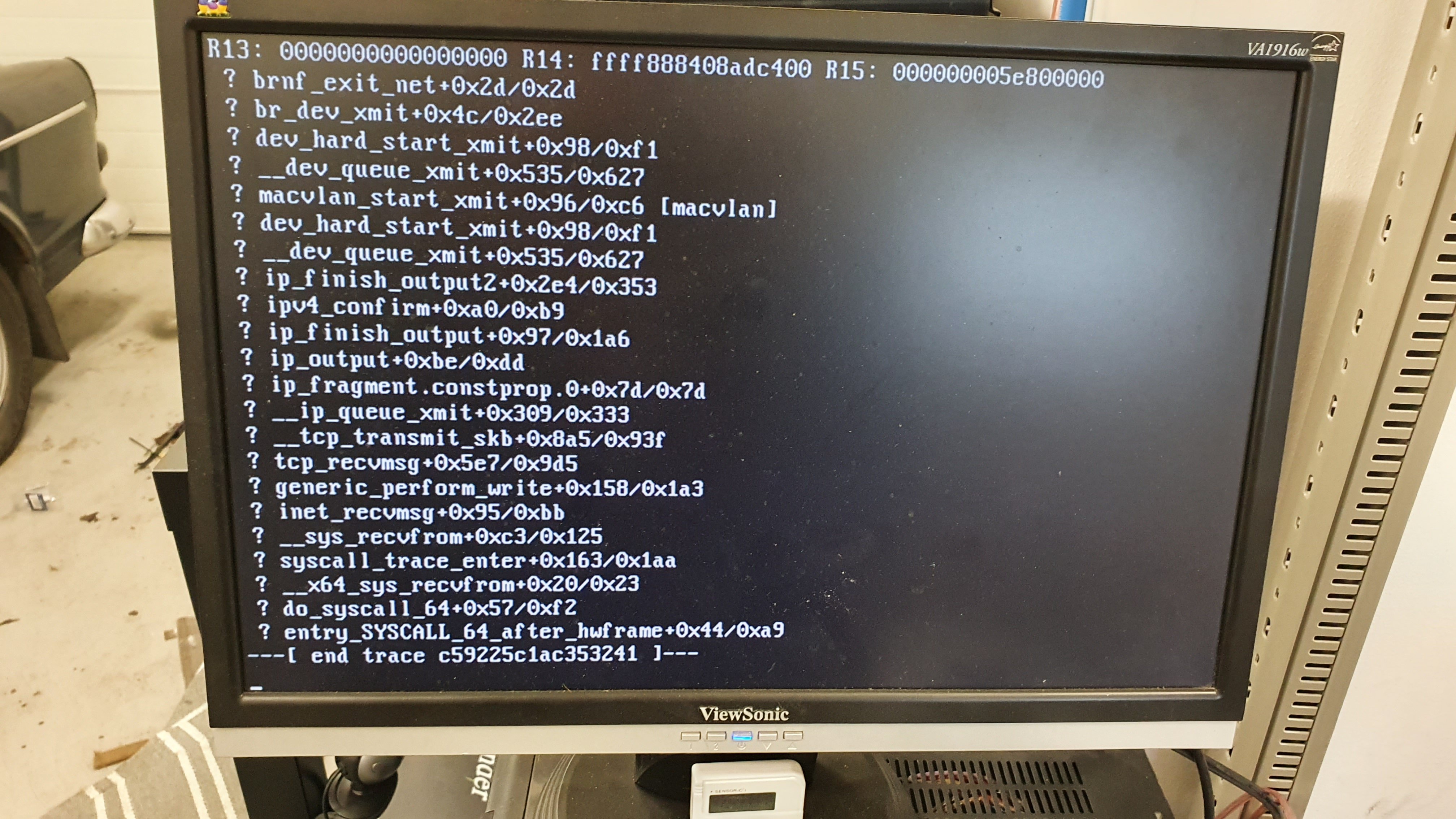

Yep it was down again: These came out, dual rank and most likely the cheapest stick in the world. I'll memtest these in my main rig later. Want them out from server anyway so no need to memtest there. 2x8Gb single rank kingstons in, will try safe mode if it still crashes, but really hope not as now theres no janky components left!

It seems to be down again. I`ll throw a kit of 2x8gb Kingston HyperX single rank sticks from the main rig at it and see if its more stable. (Kit is HX432C16FB3K2/16)

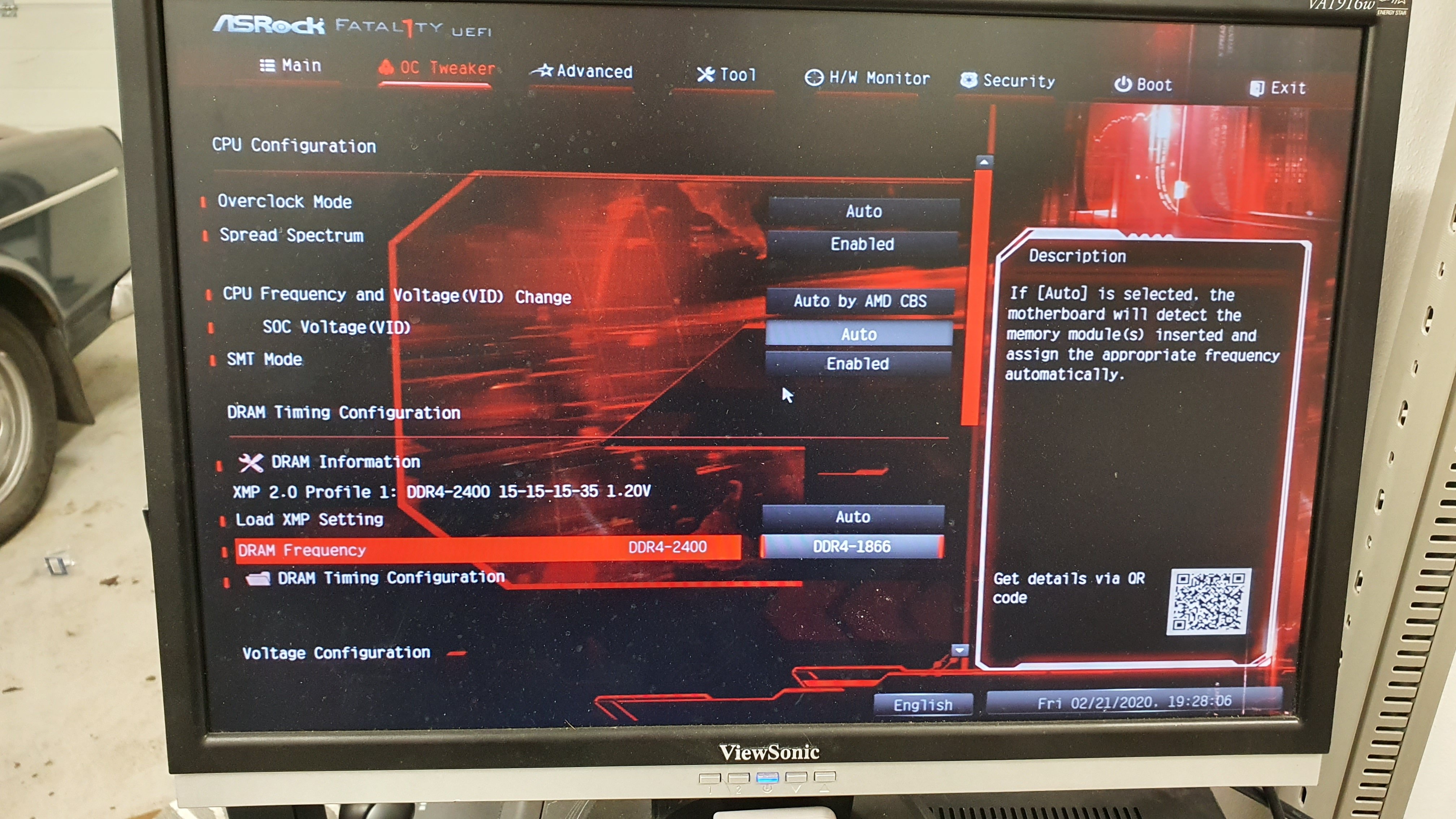

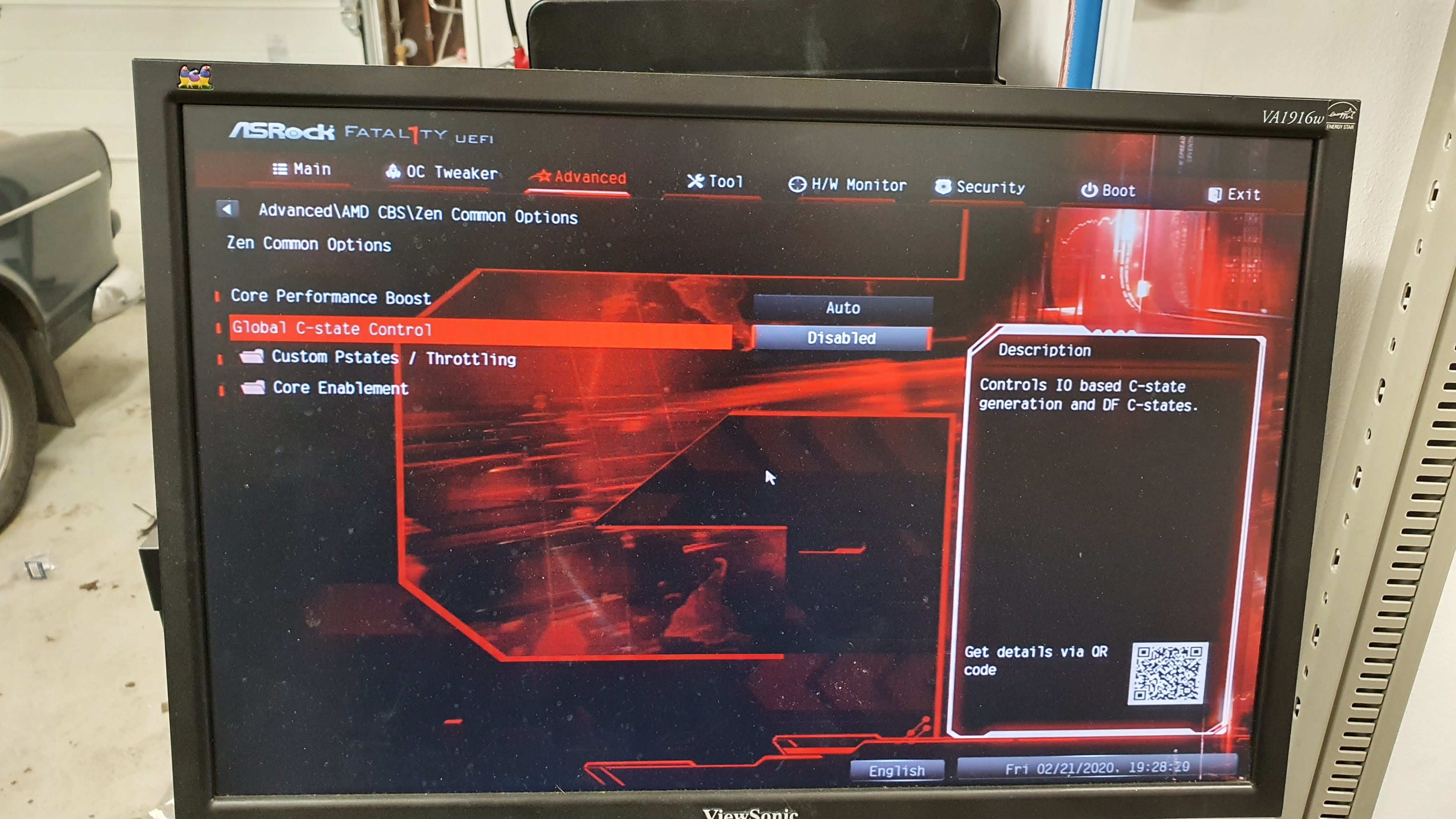

Like I wrote, I had the problem at first with power control of Zen architecture, it crashed really fast after starting to idle. But it seemed to be solved by disabling Global C-States Control. This was over a month ago and server was 100% stable for a month before these two recent crashes. I didn't find "Power Supply Idle Control" or anything similar from BIOS, other than Global C-States Control. I now dropped memory speed from 2400 to 1866, but again the hardware was stable for a month so I doubt this will have anything to do with the topic. BIOS version is also fairly recent, 5.80 from 2019/7/3. Newest is 6.30 from 2020/2/4. And again it was stable for a month... nothing changed there recently.

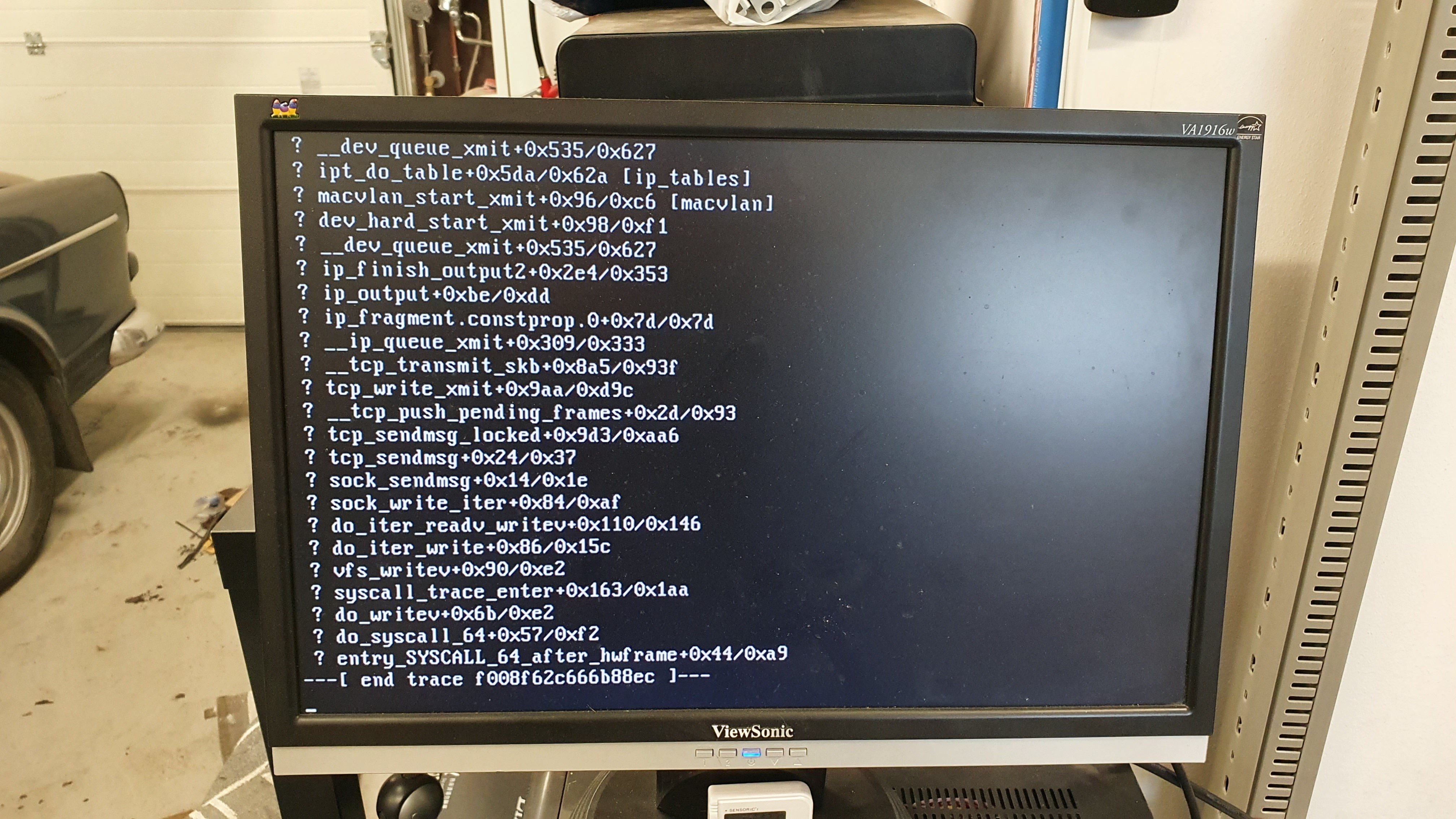

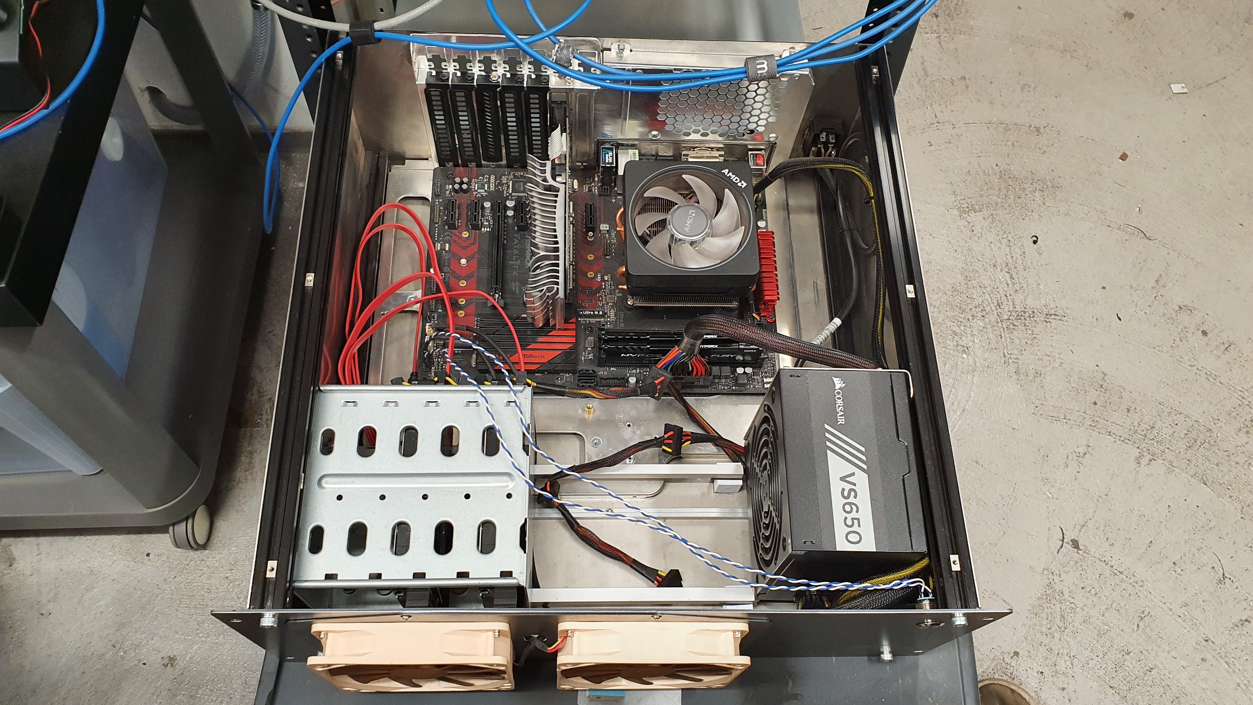

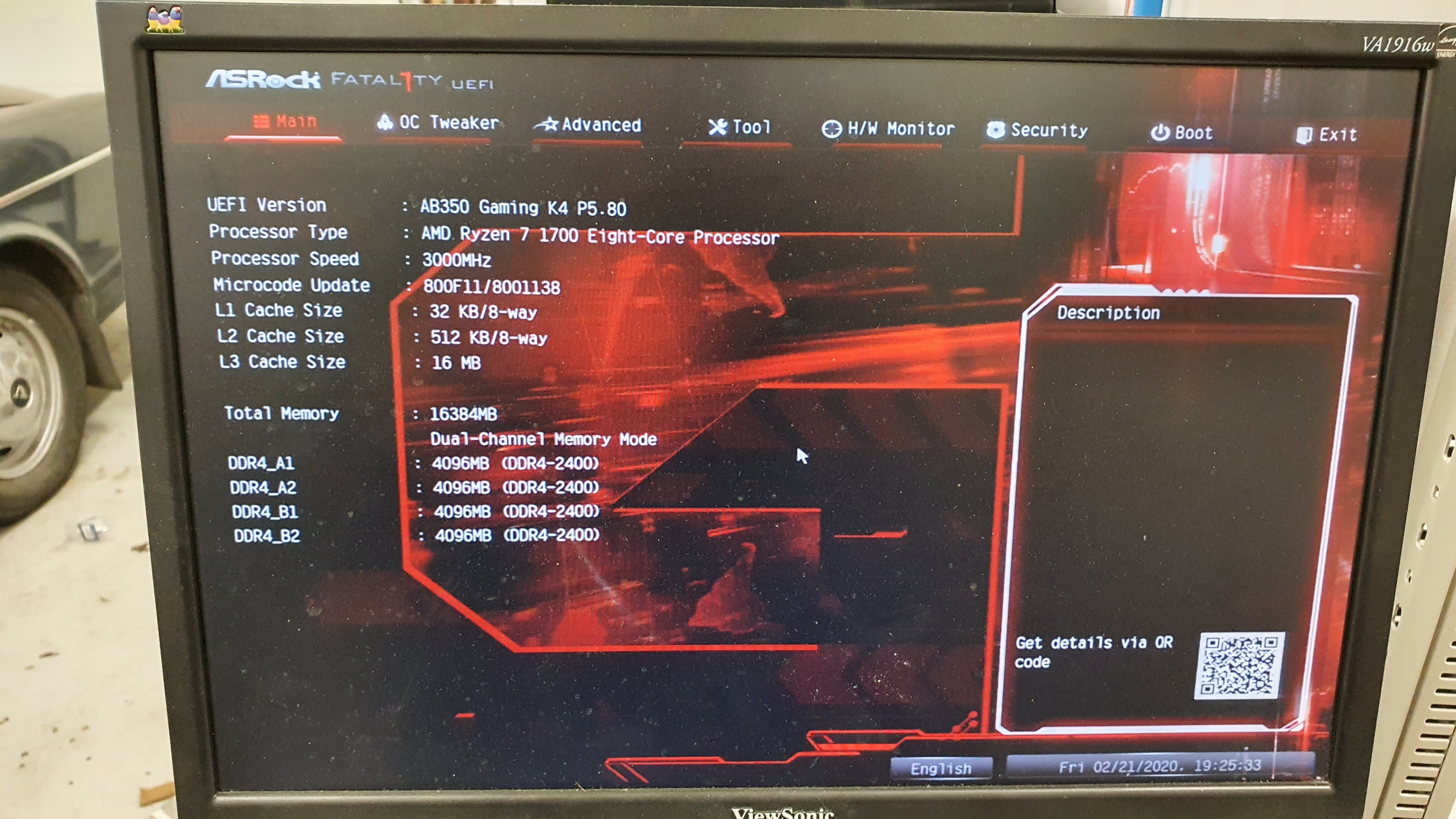

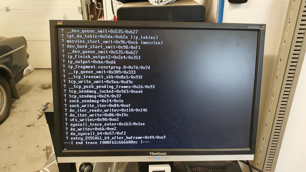

Unraid version: 6.8.2 official Installed plugins: Preclear, CA Backup/Restore Appdata, Commuynity Applications, Dynamix S3 Sleep (not enabled tho..), Dynamix System Information, Dynamix System Statistics, Dynamix System Temperature, Fix Common Problems, Nerd Tools, Network UPS Tools (NUT), Tips and Tweaks, Unassigned Devices, Unassigned Devices Plus Dockers: MQTT, pihole-template, plex, shinobi_pro, UniFi VM's: Generic Linux ru3nning HassOS 3.11 (Cores 7 / 15, and 4Gb RAM assigned) Hardware: MoBo: AsRock Fatal1ty AB350 Gaming K4 (Global C-States Control = disabled) CPU: Ryzen 7 1700 @ stock, cooled by AMD Wraith Prizm RAM: 4x4Gb of chinese 2400mhz DDR4 GPU: Asus GT520 Silent Disks: 2x4TB Seagate Ironwolf, no cache yet PSU: Corsair VS650 Networking: Intel i350-T4 installed but not in use as I couldnt make LACP work. Running single gigabit connection from integrated Realtek nic with 4 VLANs. Problem: Server sometimes freezes, happened twice now in couple days, both times it has been idling when crashing. Networking is lost, doesn't answer to ping and doesn't allow ssh. Had similar problem when it was first installed, but after disabling Global C-States Control it was stable until now. Last things I have installed before problems was CA Backup/Restore plugin that I configured to make a backup to external smb share mounted via unassigned devices plugin. Crash has never happened when this is scheduled. Also I have messed around with home assistant dockers, mqtt docker and lately switched to home assistant running in VM. First time this crash happened (between February 17 and 18) was before switching from docker to HassOS VM (February 19). I have syslog after the first crash, ending to second crash that I noticed last night February 20, about 23:00. 192.168.5.69 is my main PC, which was offline 17:27 as seen in syslog. I'm curious what mover has been trying to do Feb 20 03:40:01, as mover should be disabled because of no cache is installed. Oh and when it has crashed, hard power off is the only way out. Power button doesnt do anything, even if pressed continously long time. Need to switch PSU off or take power cord out from UPS. Syslog between crashes: Feb 18 21:18:40 Tower rsyslogd: [origin software="rsyslogd" swVersion="8.1908.0" x-pid="8449" x-info="https://www.rsyslog.com"] start Feb 18 21:27:50 Tower webGUI: Successful login user root from 192.168.5.69 Feb 18 21:28:08 Tower kernel: mdcmd (44): set md_num_stripes 1280 Feb 18 21:28:08 Tower kernel: mdcmd (45): set md_queue_limit 80 Feb 18 21:28:08 Tower kernel: mdcmd (46): set md_sync_limit 5 Feb 18 21:28:08 Tower kernel: mdcmd (47): set md_write_method Feb 18 21:28:08 Tower kernel: mdcmd (48): set spinup_group 0 0 Feb 18 21:28:08 Tower kernel: mdcmd (49): set spinup_group 1 0 Feb 18 21:28:08 Tower kernel: mdcmd (50): start STOPPED Feb 18 21:28:08 Tower kernel: unraid: allocating 15750K for 1280 stripes (3 disks) Feb 18 21:28:08 Tower kernel: md1: running, size: 3907018532 blocks Feb 18 21:28:08 Tower emhttpd: shcmd (796): udevadm settle Feb 18 21:28:08 Tower root: Starting diskload Feb 18 21:28:09 Tower tips.and.tweaks: Tweaks Applied Feb 18 21:28:09 Tower emhttpd: Mounting disks... Feb 18 21:28:09 Tower emhttpd: shcmd (798): /sbin/btrfs device scan Feb 18 21:28:09 Tower root: Scanning for Btrfs filesystems Feb 18 21:28:09 Tower emhttpd: shcmd (799): mkdir -p /mnt/disk1 Feb 18 21:28:09 Tower emhttpd: shcmd (800): mount -t xfs -o noatime,nodiratime /dev/md1 /mnt/disk1 Feb 18 21:28:09 Tower kernel: XFS (md1): Mounting V5 Filesystem Feb 18 21:28:10 Tower kernel: XFS (md1): Ending clean mount Feb 18 21:28:10 Tower emhttpd: shcmd (801): xfs_growfs /mnt/disk1 Feb 18 21:28:10 Tower root: meta-data=/dev/md1 isize=512 agcount=4, agsize=244188659 blks Feb 18 21:28:10 Tower root: = sectsz=512 attr=2, projid32bit=1 Feb 18 21:28:10 Tower root: = crc=1 finobt=1, sparse=1, rmapbt=0 Feb 18 21:28:10 Tower root: = reflink=1 Feb 18 21:28:10 Tower root: data = bsize=4096 blocks=976754633, imaxpct=5 Feb 18 21:28:10 Tower root: = sunit=0 swidth=0 blks Feb 18 21:28:10 Tower root: naming =version 2 bsize=4096 ascii-ci=0, ftype=1 Feb 18 21:28:10 Tower root: log =internal log bsize=4096 blocks=476930, version=2 Feb 18 21:28:10 Tower root: = sectsz=512 sunit=0 blks, lazy-count=1 Feb 18 21:28:10 Tower root: realtime =none extsz=4096 blocks=0, rtextents=0 Feb 18 21:28:10 Tower emhttpd: shcmd (802): sync Feb 18 21:28:10 Tower emhttpd: shcmd (803): mkdir /mnt/user Feb 18 21:28:10 Tower emhttpd: shcmd (804): /usr/local/sbin/shfs /mnt/user -disks 2 -o noatime,allow_other -o remember=0 |& logger Feb 18 21:28:10 Tower shfs: use_ino: 1 Feb 18 21:28:10 Tower shfs: direct_io: 0 Feb 18 21:28:10 Tower emhttpd: shcmd (806): /usr/local/sbin/update_cron Feb 18 21:28:11 Tower root: Delaying execution of fix common problems scan for 10 minutes Feb 18 21:28:11 Tower unassigned.devices: Mounting 'Auto Mount' Devices... Feb 18 21:28:11 Tower emhttpd: Starting services... Feb 18 21:28:11 Tower emhttpd: shcmd (808): /etc/rc.d/rc.samba restart Feb 18 21:28:12 Tower rsyslogd: [origin software="rsyslogd" swVersion="8.1908.0" x-pid="18333" x-info="https://www.rsyslog.com"] start Feb 18 21:28:13 Tower root: Starting Samba: /usr/sbin/smbd -D Feb 18 21:28:13 Tower root: /usr/sbin/nmbd -D Feb 18 21:28:13 Tower root: /usr/sbin/wsdd Feb 18 21:28:13 Tower root: /usr/sbin/winbindd -D Feb 18 21:28:13 Tower emhttpd: shcmd (822): /usr/local/sbin/mount_image '/mnt/user/system/docker/docker.img' /var/lib/docker 25 Feb 18 21:28:13 Tower kernel: BTRFS info (device loop2): disk space caching is enabled Feb 18 21:28:13 Tower kernel: BTRFS info (device loop2): has skinny extents Feb 18 21:28:14 Tower kernel: BTRFS info (device loop2): new size for /dev/loop2 is 26843545600 Feb 18 21:28:14 Tower root: Resize '/var/lib/docker' of 'max' Feb 18 21:28:14 Tower emhttpd: shcmd (824): /etc/rc.d/rc.docker start Feb 18 21:28:14 Tower root: starting dockerd ... Feb 18 21:28:17 Tower kernel: IPv6: ADDRCONF(NETDEV_UP): docker0: link is not ready Feb 18 21:28:19 Tower root: Fix Common Problems Version 2020.02.06 Feb 18 21:28:20 Tower rc.docker: 150b3faf200b8ec6ced31e944297f7dbaede48e9b87890f53c2cbc95e5b693c6 Feb 18 21:28:22 Tower rc.docker: 86a33cc6062a533bac58566ec1bf21267482041c7a7a69c7aa32079555d54d1f Feb 18 21:28:22 Tower rc.docker: bf0a0b72cc54d961ea6810f8e537b3b131412f844f877d3e71845323b4ffe935 Feb 18 21:28:24 Tower rc.docker: 5a55816f0c8ca1900d9ea00debcfb48bfa5fc540ed269db8d1577d15088d493d Feb 18 21:28:25 Tower rc.docker: 6b4a99c56c928fa509a1fe4df5800b16cd74b3e6a37bcab4a3f3006a5036555f Feb 18 21:28:26 Tower kernel: mdcmd (51): check correct Feb 18 21:28:26 Tower kernel: md: recovery thread: check P ... Feb 18 21:28:28 Tower unassigned.devices: Mounting 'Auto Mount' Remote Shares... Feb 18 21:28:28 Tower unassigned.devices: Mount SMB share '//192.168.5.69/unraidbackup' using SMB3 protocol. Feb 18 21:28:28 Tower unassigned.devices: Mount SMB command: /sbin/mount -t cifs -o rw,nounix,iocharset=utf8,file_mode=0777,dir_mode=0777,uid=99,gid=100,vers=3.0,credentials='/tmp/unassigned.devices/credentials' '//192.168.5.69/unraidbackup' '/mnt/disks/192.168.5.69_unraidbackup' Feb 18 21:28:28 Tower unassigned.devices: Successfully mounted '//192.168.5.69/unraidbackup' on '/mnt/disks/192.168.5.69_unraidbackup'. Feb 18 21:28:28 Tower unassigned.devices: Adding SMB share '192.168.5.69_unraidbackup'.' Feb 18 21:28:30 Tower root: Fix Common Problems: Warning: Syslog mirrored to flash Feb 18 21:28:40 Tower kernel: eth0: renamed from vethcc69053 Feb 18 21:28:40 Tower kernel: device br0.20 entered promiscuous mode Feb 18 21:29:07 Tower rc.docker: home-assistant: started succesfully! Feb 18 21:29:56 Tower kernel: eth0: renamed from veth774cc56 Feb 18 21:30:42 Tower rc.docker: MQTT: started succesfully! Feb 18 21:31:37 Tower kernel: eth0: renamed from veth45dcefd Feb 18 21:31:37 Tower kernel: device br0.5 entered promiscuous mode Feb 18 21:32:05 Tower rc.docker: pihole-template: started succesfully! Feb 18 21:35:43 Tower kernel: eth0: renamed from veth3735a1e Feb 18 21:36:42 Tower rc.docker: plex: started succesfully! Feb 18 21:38:02 Tower root: Fix Common Problems Version 2020.02.06 Feb 18 21:39:13 Tower kernel: eth0: renamed from veth2a7b730 Feb 18 21:39:13 Tower kernel: device br0.15 entered promiscuous mode Feb 18 21:40:45 Tower rc.docker: shinobi_pro: started succesfully! Feb 18 21:40:52 Tower root: Fix Common Problems: Warning: Template URL for docker application is missing. Feb 18 21:40:53 Tower root: Fix Common Problems: Warning: Syslog mirrored to flash Feb 18 21:42:46 Tower kernel: eth0: renamed from vethd578a9a Feb 18 21:42:46 Tower kernel: device br0 entered promiscuous mode Feb 18 21:44:20 Tower rc.docker: UniFi: started succesfully! Feb 18 23:01:56 Tower kernel: vethcc69053: renamed from eth0 Feb 18 23:02:27 Tower kernel: eth0: renamed from vethf20d86d Feb 18 23:29:08 Tower kernel: CIFS VFS: Server 192.168.5.69 has not responded in 180 seconds. Reconnecting... Feb 19 03:40:01 Tower crond[2144]: exit status 3 from user root /usr/local/sbin/mover &> /dev/null Feb 19 05:12:34 Tower kernel: md: sync done. time=27848sec Feb 19 05:12:34 Tower kernel: md: recovery thread: exit status: 0 Feb 19 19:32:27 Tower kernel: CIFS VFS: Server 192.168.5.69 has not responded in 180 seconds. Reconnecting... Feb 19 20:13:04 Tower emhttpd: Starting services... Feb 19 20:13:04 Tower emhttpd: shcmd (3557): /etc/rc.d/rc.samba restart Feb 19 20:13:07 Tower root: Starting Samba: /usr/sbin/smbd -D Feb 19 20:13:07 Tower root: /usr/sbin/nmbd -D Feb 19 20:13:07 Tower root: /usr/sbin/wsdd Feb 19 20:13:07 Tower root: /usr/sbin/winbindd -D Feb 19 20:13:07 Tower emhttpd: shcmd (3566): smbcontrol smbd close-share 'domains' Feb 19 20:14:22 Tower emhttpd: Starting services... Feb 19 20:14:22 Tower emhttpd: shcmd (3571): /etc/rc.d/rc.samba restart Feb 19 20:14:24 Tower root: Starting Samba: /usr/sbin/smbd -D Feb 19 20:14:25 Tower root: /usr/sbin/nmbd -D Feb 19 20:14:25 Tower root: /usr/sbin/wsdd Feb 19 20:14:25 Tower root: /usr/sbin/winbindd -D Feb 19 20:14:25 Tower emhttpd: shcmd (3580): smbcontrol smbd close-share 'domains' Feb 19 20:29:36 Tower login[15229]: ROOT LOGIN on '/dev/pts/0' Feb 19 20:31:50 Tower sudo: root : TTY=pts/0 ; PWD=/mnt/user/domains/HassOS ; USER=root ; COMMAND=/usr/bin/qemu-img resize hassos_ova-3.11.qcow2 +20G Feb 19 20:32:18 Tower ool www[18096]: /usr/local/emhttp/plugins/dynamix/scripts/emcmd 'cmdStatus=Apply' Feb 19 20:32:18 Tower emhttpd: Starting services... Feb 19 20:32:18 Tower emhttpd: shcmd (3618): /etc/rc.d/rc.samba restart Feb 19 20:32:20 Tower root: Starting Samba: /usr/sbin/smbd -D Feb 19 20:32:20 Tower root: /usr/sbin/nmbd -D Feb 19 20:32:20 Tower root: /usr/sbin/wsdd Feb 19 20:32:20 Tower root: /usr/sbin/winbindd -D Feb 19 20:32:20 Tower emhttpd: shcmd (3637): /usr/local/sbin/mount_image '/mnt/user/system/libvirt/libvirt.img' /etc/libvirt 1 Feb 19 20:32:20 Tower kernel: BTRFS: device fsid 289b59d2-1e32-43f4-88f5-fa541d3fcb71 devid 1 transid 18 /dev/loop3 Feb 19 20:32:21 Tower kernel: BTRFS info (device loop3): disk space caching is enabled Feb 19 20:32:21 Tower kernel: BTRFS info (device loop3): has skinny extents Feb 19 20:32:21 Tower root: Resize '/etc/libvirt' of 'max' Feb 19 20:32:21 Tower kernel: BTRFS info (device loop3): new size for /dev/loop3 is 1073741824 Feb 19 20:32:21 Tower emhttpd: shcmd (3639): /etc/rc.d/rc.libvirt start Feb 19 20:32:21 Tower root: Starting virtlockd... Feb 19 20:32:21 Tower root: Starting virtlogd... Feb 19 20:32:21 Tower root: Starting libvirtd... Feb 19 20:32:21 Tower kernel: tun: Universal TUN/TAP device driver, 1.6 Feb 19 20:32:21 Tower kernel: virbr0: port 1(virbr0-nic) entered blocking state Feb 19 20:32:21 Tower kernel: virbr0: port 1(virbr0-nic) entered disabled state Feb 19 20:32:21 Tower kernel: device virbr0-nic entered promiscuous mode Feb 19 20:32:21 Tower kernel: virbr0: port 1(virbr0-nic) entered blocking state Feb 19 20:32:21 Tower kernel: virbr0: port 1(virbr0-nic) entered listening state Feb 19 20:32:21 Tower dnsmasq[25551]: started, version 2.80 cachesize 150 Feb 19 20:32:21 Tower dnsmasq[25551]: compile time options: IPv6 GNU-getopt no-DBus i18n IDN2 DHCP DHCPv6 no-Lua TFTP no-conntrack ipset auth no-DNSSEC loop-detect inotify dumpfile Feb 19 20:32:21 Tower dnsmasq-dhcp[25551]: DHCP, IP range 192.168.122.2 -- 192.168.122.254, lease time 1h Feb 19 20:32:21 Tower dnsmasq-dhcp[25551]: DHCP, sockets bound exclusively to interface virbr0 Feb 19 20:32:21 Tower dnsmasq[25551]: reading /etc/resolv.conf Feb 19 20:32:21 Tower dnsmasq[25551]: using nameserver 192.168.1.1#53 Feb 19 20:32:21 Tower dnsmasq[25551]: read /etc/hosts - 2 addresses Feb 19 20:32:21 Tower dnsmasq[25551]: read /var/lib/libvirt/dnsmasq/default.addnhosts - 0 addresses Feb 19 20:32:21 Tower dnsmasq-dhcp[25551]: read /var/lib/libvirt/dnsmasq/default.hostsfile Feb 19 20:32:21 Tower kernel: virbr0: port 1(virbr0-nic) entered disabled state Feb 19 20:33:42 Tower kernel: br0: port 2(vnet0) entered blocking state Feb 19 20:33:42 Tower kernel: br0: port 2(vnet0) entered disabled state Feb 19 20:33:42 Tower kernel: device vnet0 entered promiscuous mode Feb 19 20:33:42 Tower kernel: br0: port 2(vnet0) entered blocking state Feb 19 20:33:42 Tower kernel: br0: port 2(vnet0) entered forwarding state Feb 19 20:37:48 Tower kernel: br0: port 2(vnet0) entered disabled state Feb 19 20:37:48 Tower kernel: device vnet0 left promiscuous mode Feb 19 20:37:48 Tower kernel: br0: port 2(vnet0) entered disabled state Feb 19 20:38:40 Tower kernel: br0.20: port 2(vnet0) entered blocking state Feb 19 20:38:40 Tower kernel: br0.20: port 2(vnet0) entered disabled state Feb 19 20:38:40 Tower kernel: device vnet0 entered promiscuous mode Feb 19 20:38:40 Tower kernel: br0.20: port 2(vnet0) entered blocking state Feb 19 20:38:40 Tower kernel: br0.20: port 2(vnet0) entered forwarding state Feb 19 21:04:46 Tower kernel: vethf20d86d: renamed from eth0 Feb 19 21:05:00 Tower kernel: device br0.20 left promiscuous mode Feb 19 21:05:00 Tower kernel: veth774cc56: renamed from eth0 Feb 19 21:05:13 Tower kernel: eth0: renamed from vethc42cdd2 Feb 19 21:05:13 Tower kernel: device br0.20 entered promiscuous mode Feb 19 21:24:27 Tower kernel: br0.20: port 2(vnet0) entered disabled state Feb 19 21:24:27 Tower kernel: device vnet0 left promiscuous mode Feb 19 21:24:27 Tower kernel: br0.20: port 2(vnet0) entered disabled state Feb 19 21:25:30 Tower kernel: br0.20: port 2(vnet0) entered blocking state Feb 19 21:25:30 Tower kernel: br0.20: port 2(vnet0) entered disabled state Feb 19 21:25:30 Tower kernel: device vnet0 entered promiscuous mode Feb 19 21:25:30 Tower kernel: br0.20: port 2(vnet0) entered blocking state Feb 19 21:25:30 Tower kernel: br0.20: port 2(vnet0) entered forwarding state Feb 19 21:50:29 Tower webGUI: Successful login user root from 192.168.5.69 Feb 19 21:50:30 Tower login[13073]: ROOT LOGIN on '/dev/pts/1' Feb 19 21:51:48 Tower CA Backup/Restore: ####################################### Feb 19 21:51:48 Tower CA Backup/Restore: Community Applications appData Backup Feb 19 21:51:48 Tower CA Backup/Restore: Applications will be unavailable during Feb 19 21:51:48 Tower CA Backup/Restore: this process. They will automatically Feb 19 21:51:48 Tower CA Backup/Restore: be restarted upon completion. Feb 19 21:51:48 Tower CA Backup/Restore: ####################################### Feb 19 21:51:48 Tower CA Backup/Restore: Stopping MQTT Feb 19 21:51:49 Tower kernel: device br0.20 left promiscuous mode Feb 19 21:51:49 Tower kernel: vethc42cdd2: renamed from eth0 Feb 19 21:51:51 Tower CA Backup/Restore: docker stop -t 60 MQTT Feb 19 21:51:51 Tower CA Backup/Restore: Stopping pihole-template Feb 19 21:51:55 Tower kernel: veth45dcefd: renamed from eth0 Feb 19 21:51:57 Tower CA Backup/Restore: docker stop -t 60 pihole-template Feb 19 21:51:57 Tower CA Backup/Restore: Stopping plex Feb 19 21:52:01 Tower kernel: device br0.5 left promiscuous mode Feb 19 21:52:01 Tower kernel: veth3735a1e: renamed from eth0 Feb 19 21:52:02 Tower CA Backup/Restore: docker stop -t 60 plex Feb 19 21:52:02 Tower CA Backup/Restore: Stopping shinobi_pro Feb 19 21:52:03 Tower kernel: device br0.15 left promiscuous mode Feb 19 21:52:03 Tower kernel: veth2a7b730: renamed from eth0 Feb 19 21:52:05 Tower CA Backup/Restore: docker stop -t 60 shinobi_pro Feb 19 21:52:05 Tower CA Backup/Restore: Stopping UniFi Feb 19 21:52:18 Tower kernel: device br0 left promiscuous mode Feb 19 21:52:18 Tower kernel: vethd578a9a: renamed from eth0 Feb 19 21:52:20 Tower CA Backup/Restore: docker stop -t 60 UniFi Feb 19 21:52:20 Tower CA Backup/Restore: Backing up USB Flash drive config folder to Feb 19 21:52:20 Tower CA Backup/Restore: Using command: /usr/bin/rsync -avXHq --delete --log-file="/var/lib/docker/unraid/ca.backup2.datastore/appdata_backup.log" /boot/ "/mnt/disks/192.168.5.69_unraidbackup/USB/" > /dev/null 2>&1 Feb 19 21:52:20 Tower CA Backup/Restore: Changing permissions on backup Feb 19 21:52:20 Tower CA Backup/Restore: Backing up libvirt.img to /mnt/disks/192.168.5.69_unraidbackup/libvirt/ Feb 19 21:52:20 Tower CA Backup/Restore: Using Command: /usr/bin/rsync -avXHq --delete --log-file="/var/lib/docker/unraid/ca.backup2.datastore/appdata_backup.log" "/mnt/user/system/libvirt/libvirt.img" "/mnt/disks/192.168.5.69_unraidbackup/libvirt/" > /dev/null 2>&1 Feb 19 21:52:33 Tower CA Backup/Restore: Backing Up appData from /mnt/user/appdata/ to /mnt/disks/192.168.5.69_unraidbackup/Appdata/[email protected] Feb 19 21:52:33 Tower CA Backup/Restore: Using command: cd '/mnt/user/appdata/' && /usr/bin/tar -cvaf '/mnt/disks/192.168.5.69_unraidbackup/Appdata/[email protected]/CA_backup.tar' --exclude 'docker.img' * >> /var/lib/docker/unraid/ca.backup2.datastore/appdata_backup.log 2>&1 & echo $! > /tmp/ca.backup2/tempFiles/backupInProgress Feb 19 21:52:38 Tower CA Backup/Restore: Backup Complete Feb 19 21:52:38 Tower CA Backup/Restore: Verifying backup Feb 19 21:52:38 Tower CA Backup/Restore: Using command: cd '/mnt/user/appdata/' && /usr/bin/tar --diff -C '/mnt/user/appdata/' -af '/mnt/disks/192.168.5.69_unraidbackup/Appdata/[email protected]/CA_backup.tar' > /var/lib/docker/unraid/ca.backup2.datastore/appdata_backup.log & echo $! > /tmp/ca.backup2/tempFiles/verifyInProgress Feb 19 21:52:43 Tower kernel: eth0: renamed from veth3ab691e Feb 19 21:52:43 Tower kernel: device br0.20 entered promiscuous mode Feb 19 21:52:46 Tower kernel: eth0: renamed from veth755cd47 Feb 19 21:52:46 Tower kernel: device br0.5 entered promiscuous mode Feb 19 21:52:48 Tower kernel: eth0: renamed from veth27dd72e Feb 19 21:52:52 Tower kernel: eth0: renamed from veth2505066 Feb 19 21:52:52 Tower kernel: device br0.15 entered promiscuous mode Feb 19 21:52:56 Tower kernel: eth0: renamed from veth0be2d7d Feb 19 21:52:56 Tower kernel: device br0 entered promiscuous mode Feb 19 21:52:56 Tower CA Backup/Restore: ####################### Feb 19 21:52:56 Tower CA Backup/Restore: appData Backup complete Feb 19 21:52:56 Tower CA Backup/Restore: ####################### Feb 19 21:52:56 Tower CA Backup/Restore: Backup / Restore Completed Feb 19 22:50:49 Tower kernel: device br0.15 left promiscuous mode Feb 19 22:50:49 Tower kernel: veth2505066: renamed from eth0 Feb 19 22:50:53 Tower kernel: eth0: renamed from vethd4660e8 Feb 19 22:50:53 Tower kernel: device br0.15 entered promiscuous mode Feb 19 23:11:07 Tower kernel: CIFS VFS: Server 192.168.5.69 has not responded in 180 seconds. Reconnecting... Feb 20 03:40:01 Tower crond[2144]: exit status 3 from user root /usr/local/sbin/mover &> /dev/null Feb 20 17:27:19 Tower kernel: CIFS VFS: Server 192.168.5.69 has not responded in 180 seconds. Reconnecting... Diagnostics file, this is after reboot tho because I cant get it out when crashed.. https://www.dropbox.com/s/u67zkfv3plorvat/tower-diagnostics-20200221-2021.zip?dl=0 Screen after second crash: didnt find a way to scroll up to see previous lines.. HALP! 😵 Best regards, Divi from Finland
