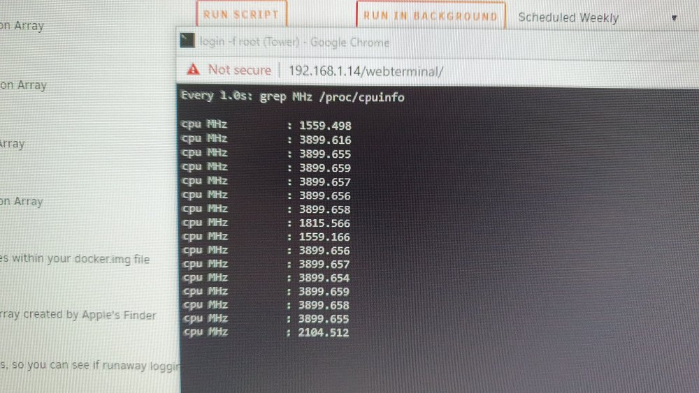

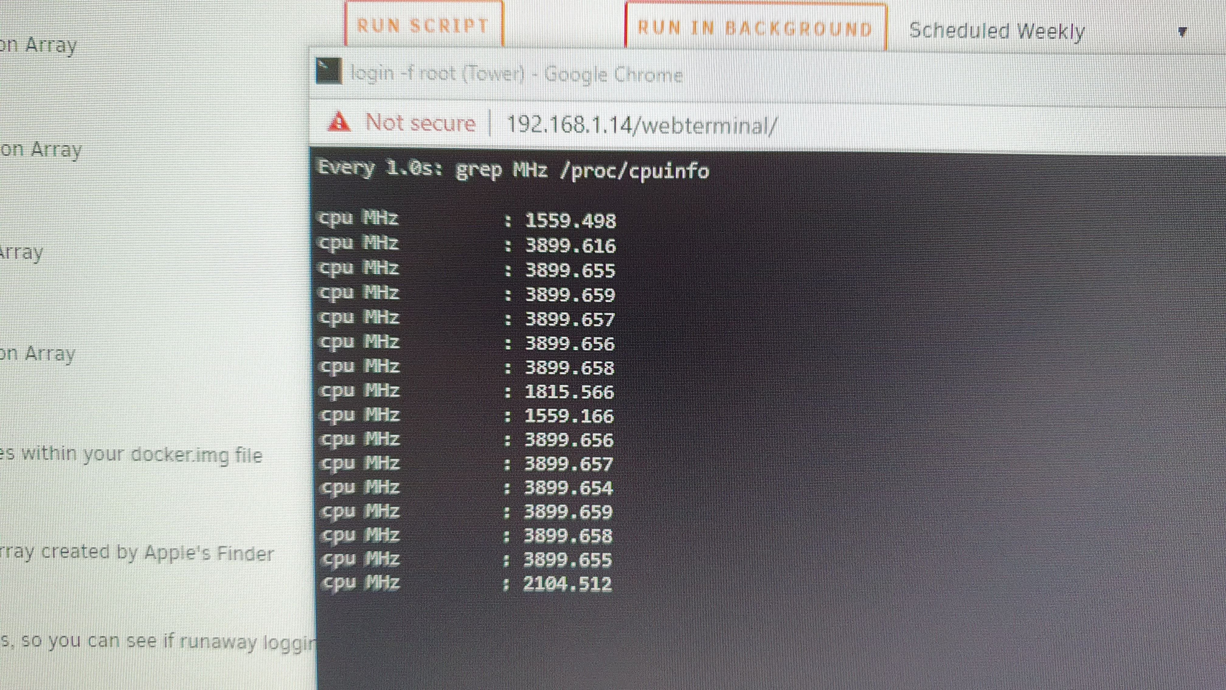

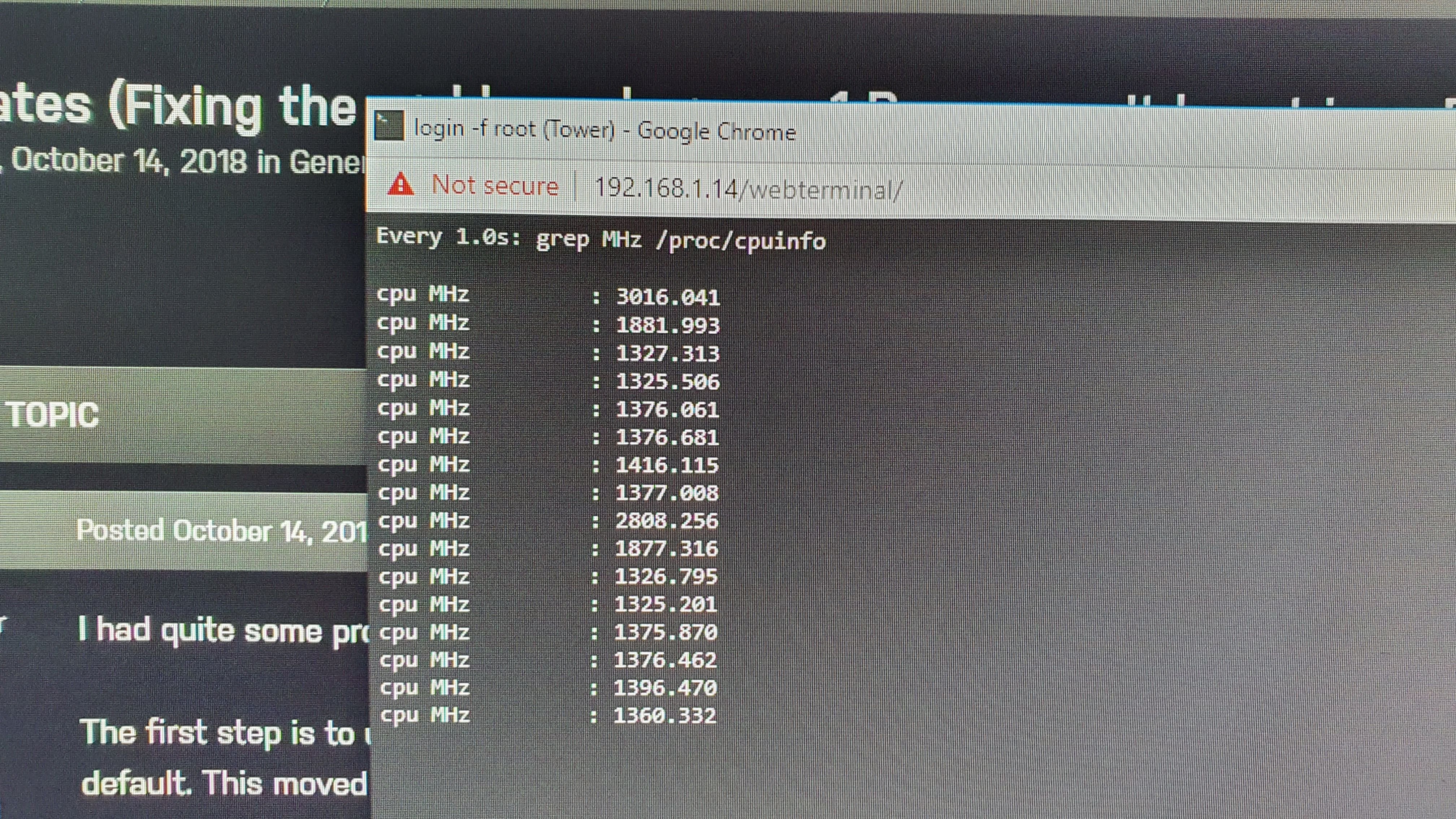

- I have turned C-states from BIOS back enabled (CPU is handling idle P-states normally))
- Dropped memory speed to 1866MHz as suggested
- Installed Python, ran Zenstates.py script with 1700x settings and automated it with CA User Scripts (Script is handling Boost state P0 as commanded, resulting a mild overclock)
Now my Ryzen 7 1700 is idling as it should, Boosting to 3.9GHz like 1700x, and seems to be completely stable, both in games and idling over night. Note that in the pictures not all cores are allocated to windows VM Iäm using to put load on the processor, therefore threads 0, 7, 8, 15 are not boosting as they are used by host and other VM. Perfect!
